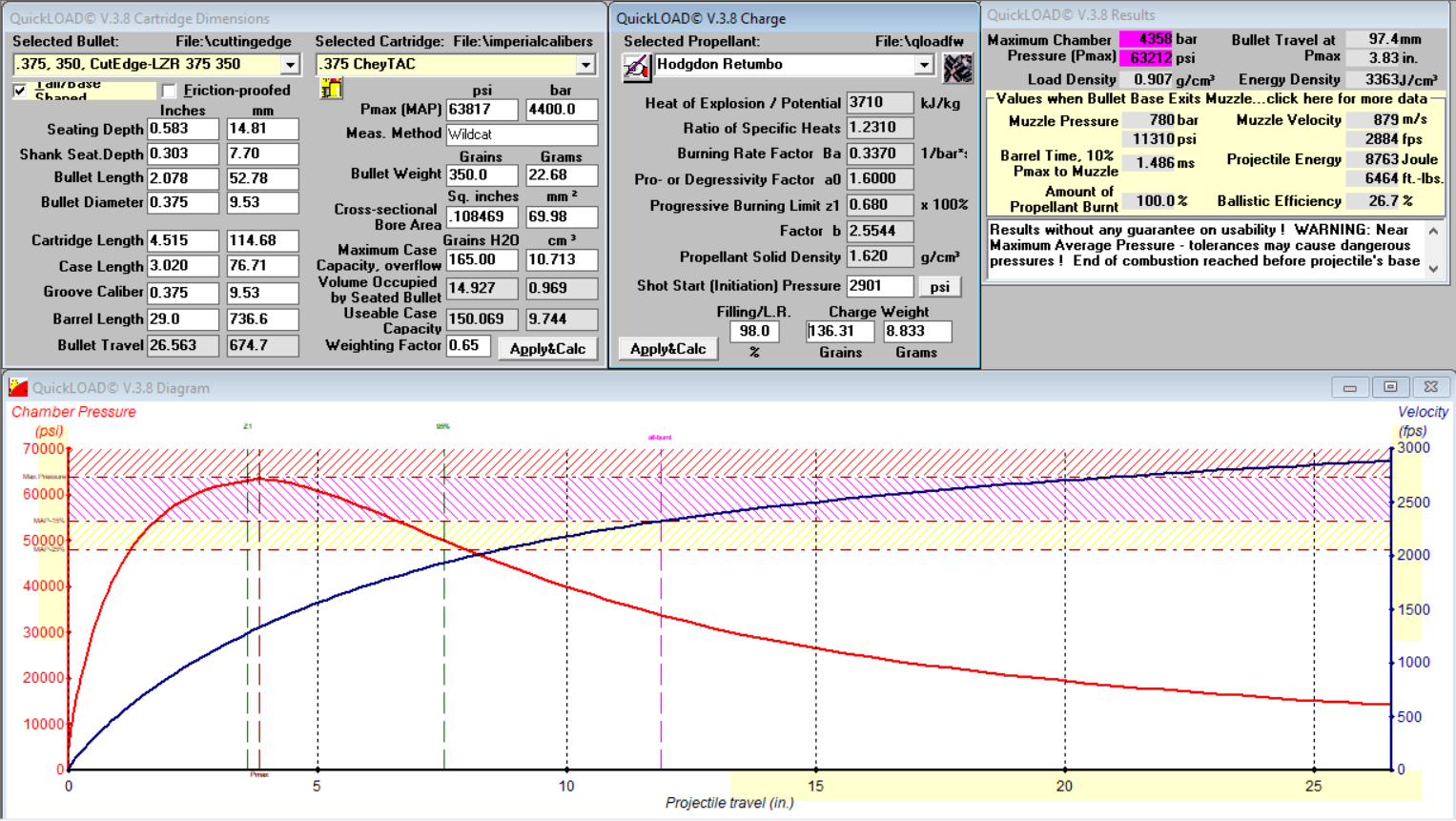

Just some QL comparisons for you. These are right at the edge of what you would want to push pressure-wise. N570 gives you a bit of a velocity advantage over Retumbo.
Thanks for running the numbers Dogtown! I have a .338 AI as we speak and having the cheytac built now, if N570 can work on my AI I also accomplish my secondary goal of focusing on purchasing one type of powder for both guns.
