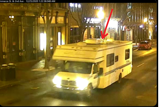

It does look like there is a loudspeaker on the roof.

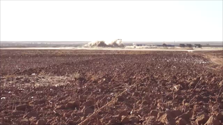

Nashville bomb was a Yuge Fireball probably went 200' high from some of the video angles.

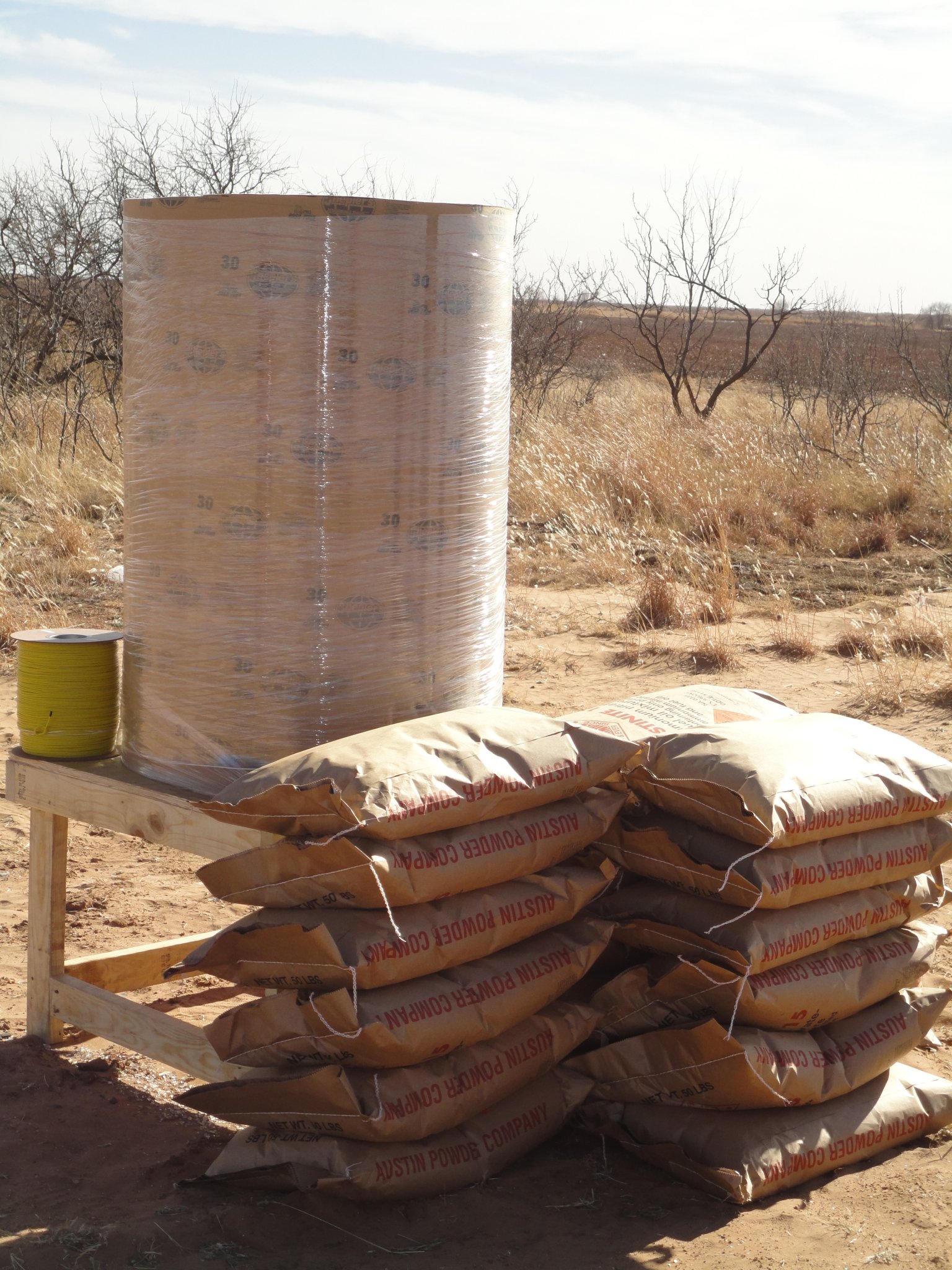

For comparison 960# ANFO

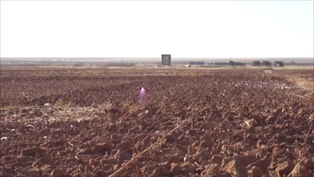

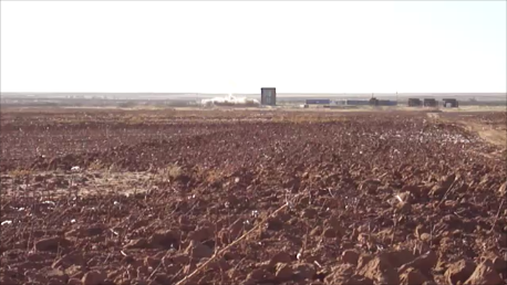

The Purple flash center pic is the only flash captured by my camera & precedes the blast.
Next frame
Shock-wave propagation
No Fireball, but that Purple flash was pretty cool & not visible to my eye.

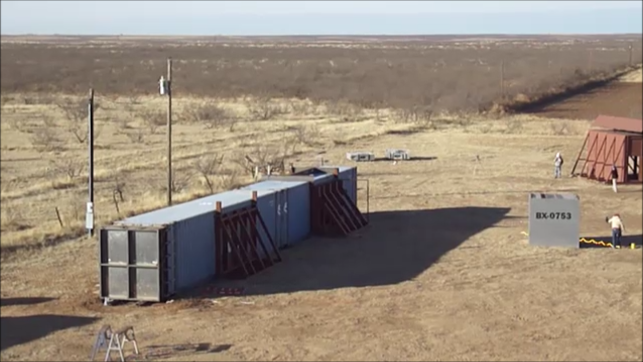

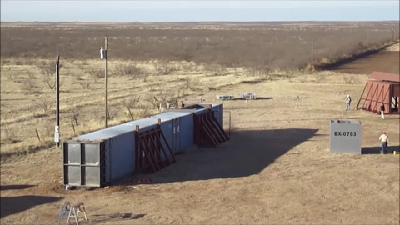

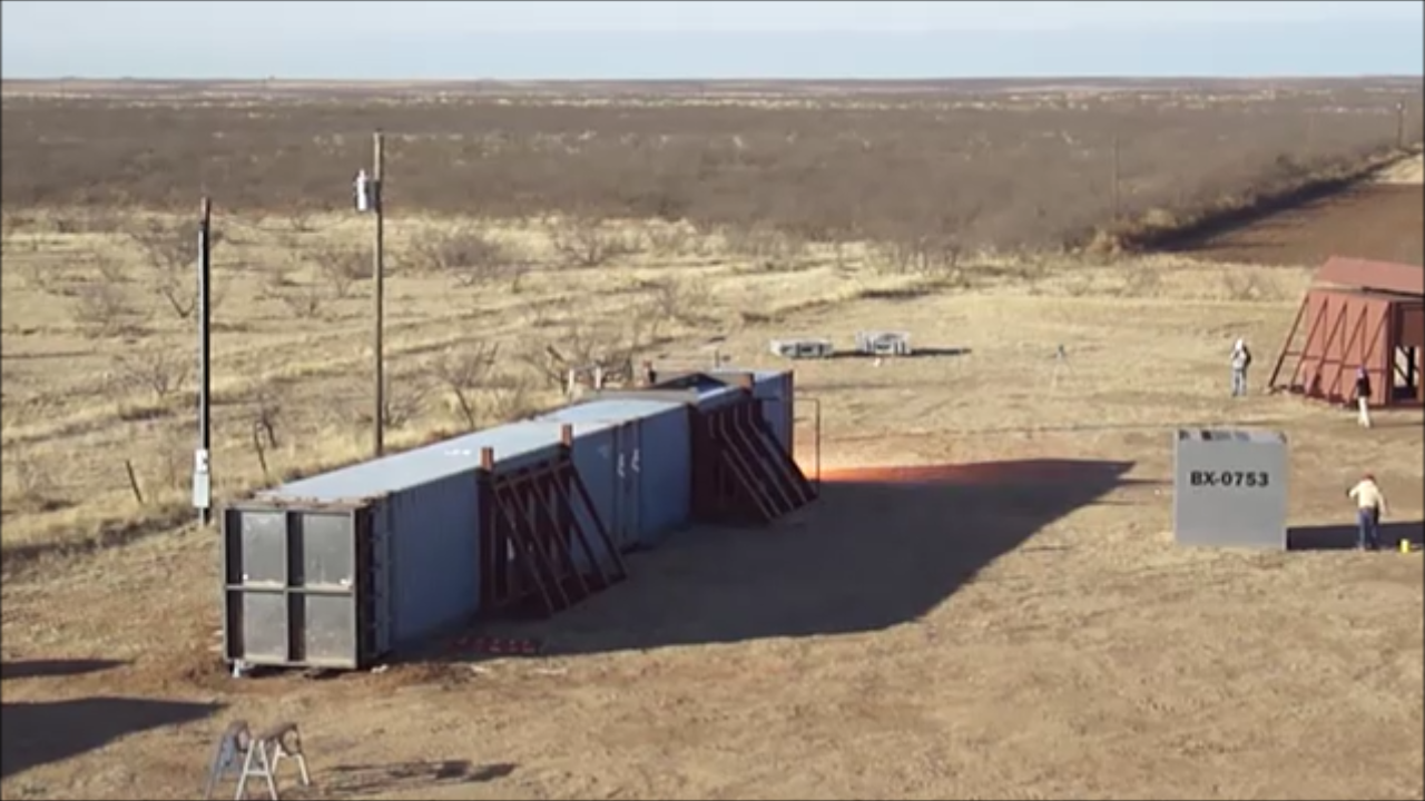

Now C4, this is only about 1/2#
This pic shows det cord lit & traveling 6400 m/s (Yellow squiggle passing explosive box).
Flash is much greater then ANFO, but it's instantaneous & Orange with no fireball.
Bulge in roof of conex left end is + shock-wave.
