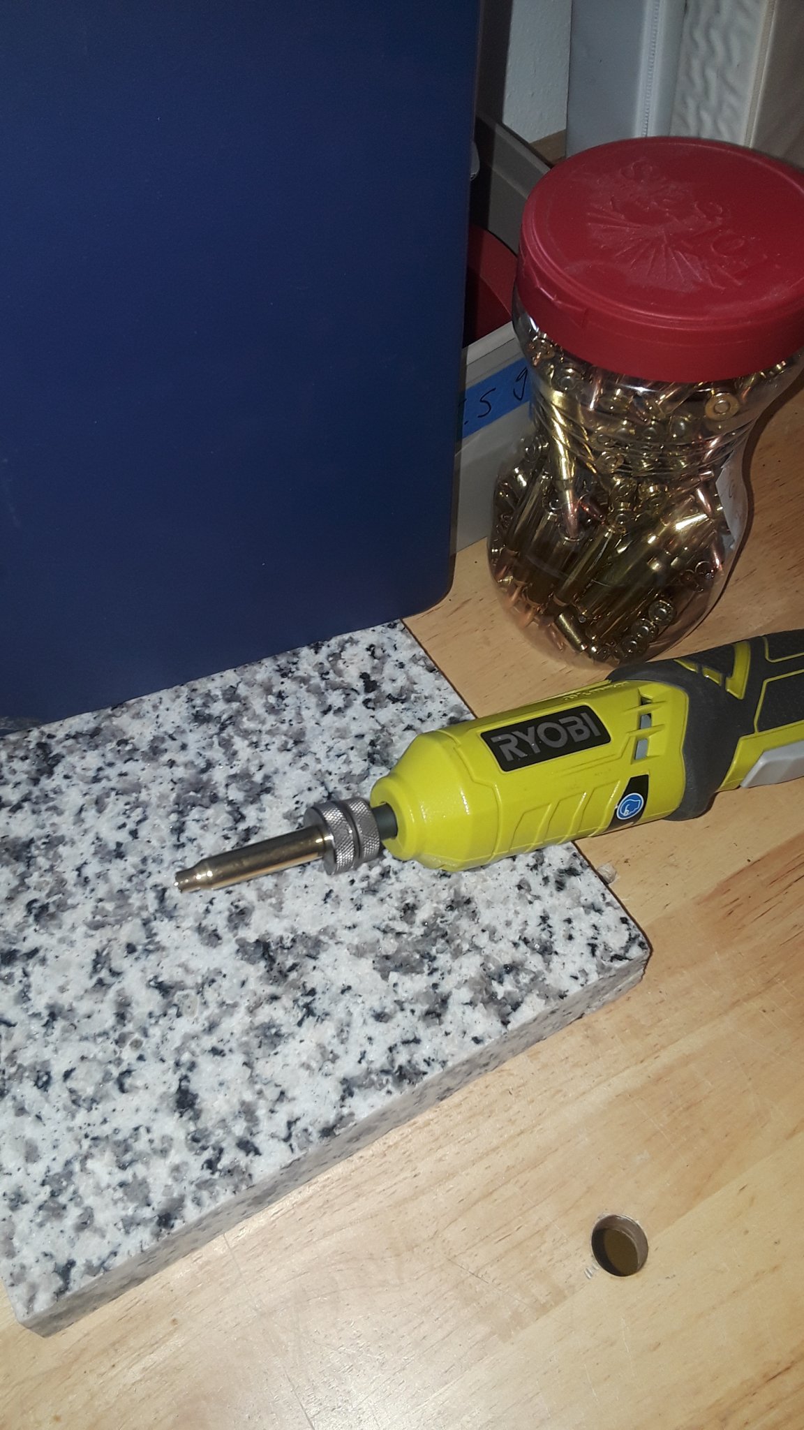

    How long would ot take to use some wet/dry 400 grit or finer paper?
    I figure both hands float.
    Please rate stupidity on a scale of 1-10.
