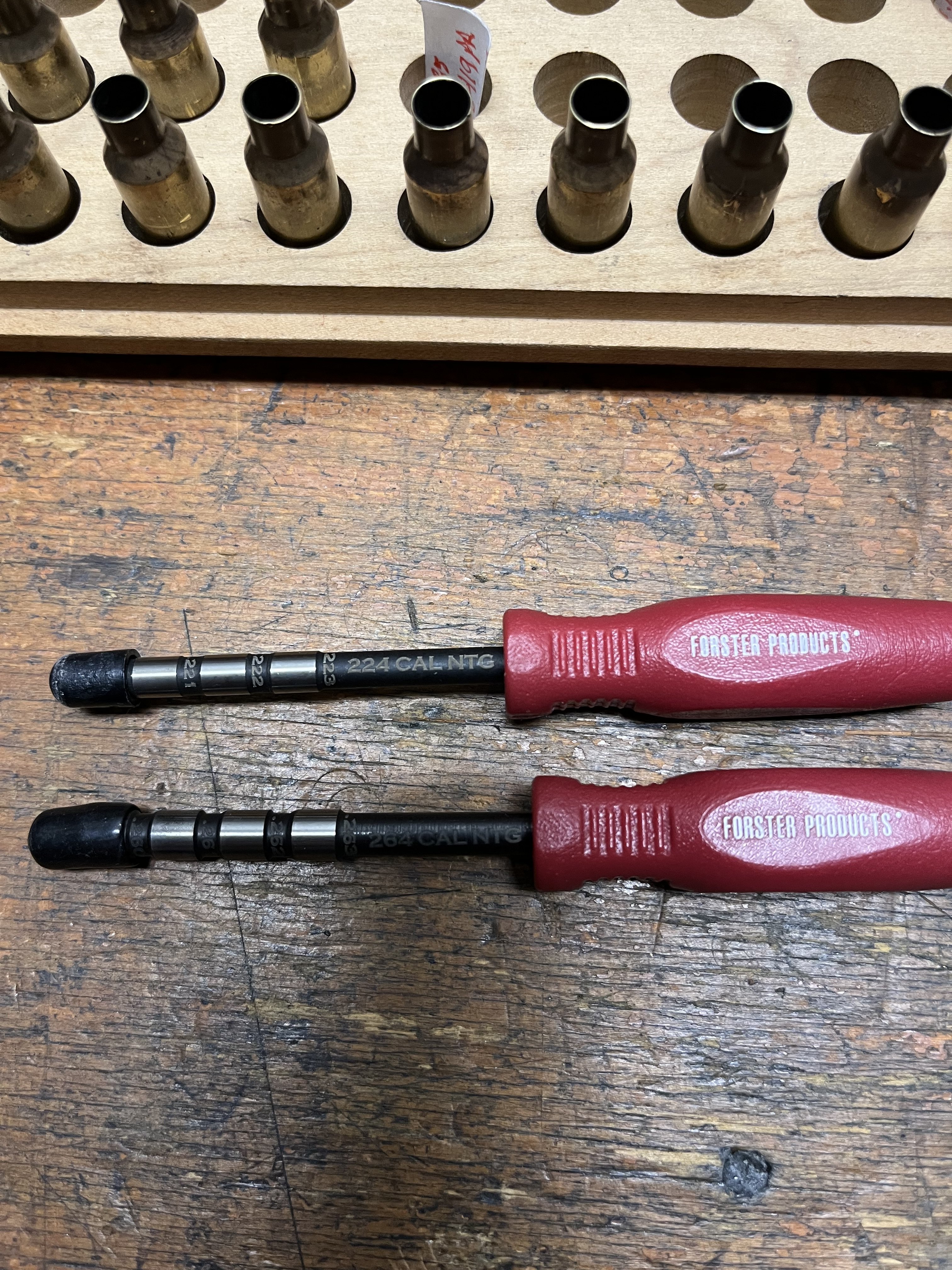

Hey Everyone,
For those that use Imperial dry neck lube (the graphite with ceramic beads) when loading for precision, when are you applying it in your process? I've been dipping the neck in the dry neck lube before sizing the case (hopefully to reduce run/out friction from the expander ball). Then after I've trimmed, chamfer/deburred, and primed, I have been dipping the neck in the dry lube AGAIN before seating the bullet (I guess for a consistent seat?) .. Are y'all dry lubing before both of these steps? Or just once during the sizing and calling it good? Not sure whether I'm over lubing the neck, if that's even a thing?
I'll be switching to a separate expander die/mandrel soon, but the same question goes, would you dry lube before expanding the neck AND seating the bullet.
Curious your thoughts from all you experienced hand loaders. Thanks!
I used to use dry-lube, but have gotten much better results with NeoLube #2. I use a q-tip to lube the inside of the neck, "after" sizing/2nd-cleaning ... and "before" my mandrel expansion step. Then I leave the residual lube in place for my seating step, and that works great for me. I just didn't like getting graphite all over the outside of my case neck ... and with NeoLube like I use it, I get great seating force curves from my AMP Press.
Nothing wrong with your process, but I will add an answer you didn't ask about... just food for thought.

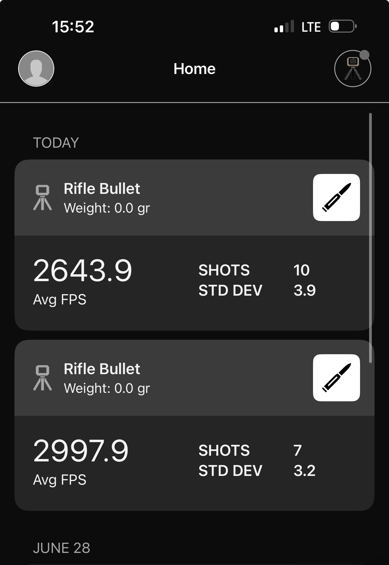

@RegionRat have you ever seen dry neck lube impact accuracy? Eric Stecker recently spoke about cleanliness during bullet manufacturing & how even oil contaminants can be a detriment to accuracy. I wondered if dry lube could become impacted on the jacket during firing & cause inconsistencies.
TLDR: Yes
