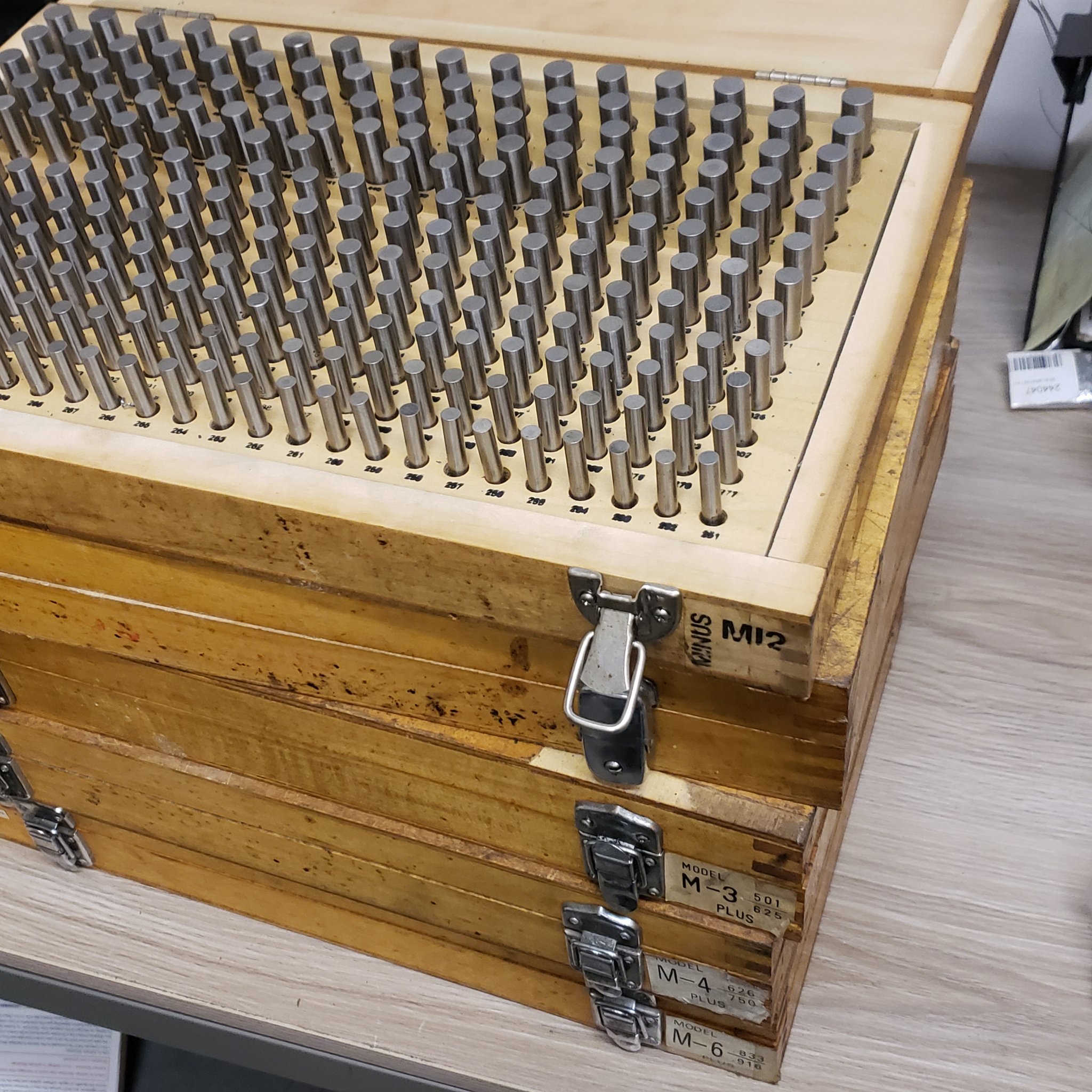

    :ROFLMAO: (y)Everyone in this game needs to buy a set of gauge pins that they can check this info out on their cases if they are serious.
    I hear you on that, I've actually been meaning to order a couple Ballistic Tools Neck Tension Gages for a while but haven't gotten around to it...

    Gaugue pins??? For what?
    Well, I didn't spring for a set of gage pins but I had .337-, .336-, and .335- Vermont ZZ pins land today and experimented. With a .365 bushing the .335 pin will drop in slowly under it's own weight with the primer pocket pluged and the .336 is a tight slip fit with 2 fingers on the side and very little pressure. With the .364 pin the .335 pin still falls in but stops due to air pressure with the primer pocket is pluged and the .336 pin goes about 3/16" and stops hard. Full disclosure this is a sample size of 2 but it looks/feels like the .364 bushing is giving me about .003" of neck tension. Now for the $64K question (Yes I understand "It's your rifle, they are all different, etc.") how much tension does a 338 like. I'm running Ramshot LRT (Made in Belgium so P.B. Clermont?) which from reading leads me to believe it is as slow or slower than Retumbo (some info says between RL33 and US869). If I have been running .002" is .003" a good metric to start experimenting from?
