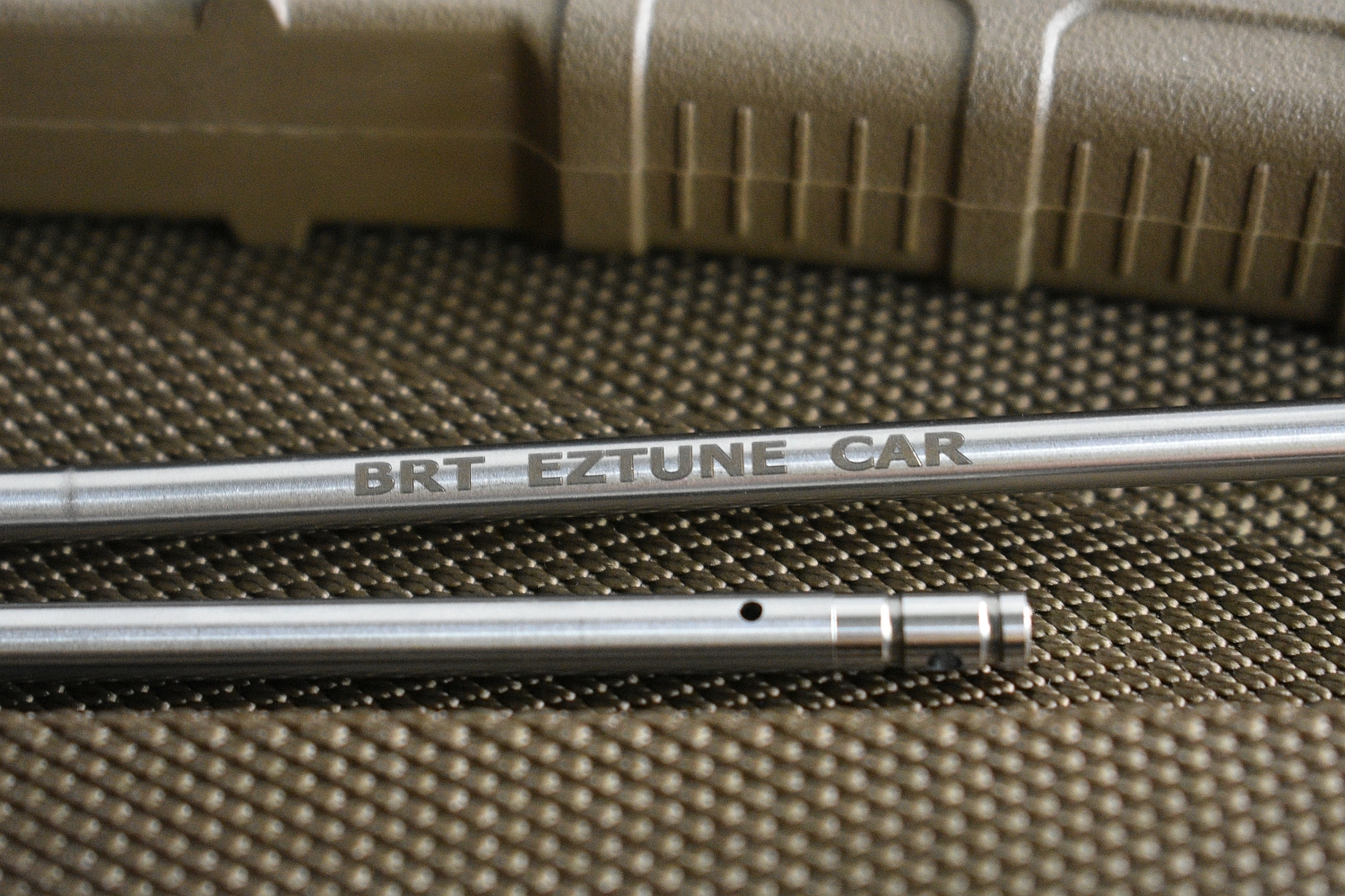

I'd also go with an adjustable gas block or if that doesn't interest you get a brt eztune gas tube.
https://blackrivertactical.com/WP/BRT-EZTUNE-Gas-Tube-Configurable-Midlength-p103167236
