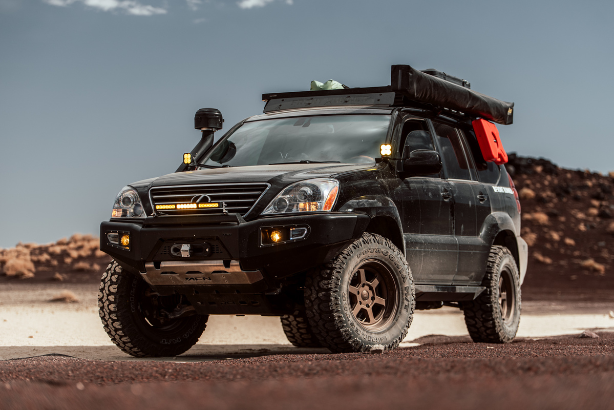

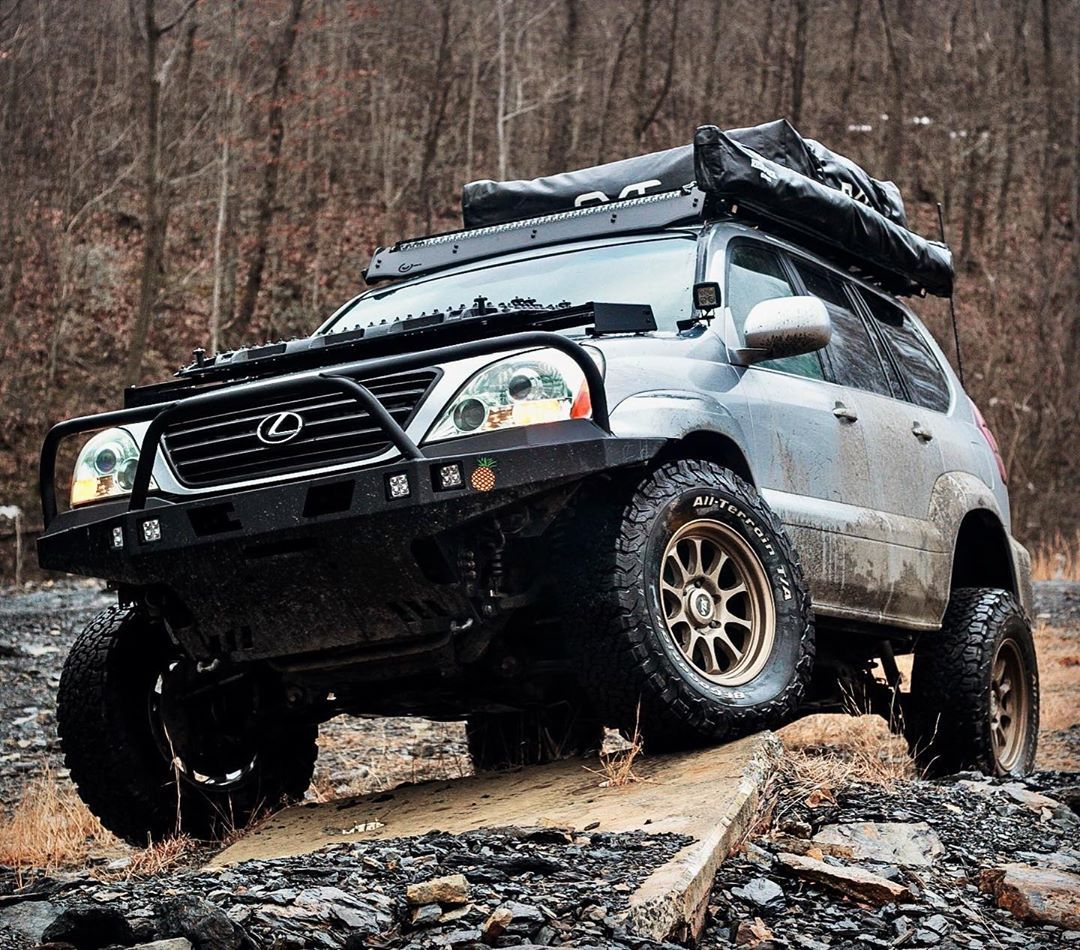

I too have been thinking a lot about a GX470, could probably get the same use out a honda pilot or cr-v but the GX is a lot burlier.
Not anymore . Once COVID hit and over landing went main stream these trucks doubled. In 2018 you couldn’t get $9k for a 140k Gx. Same truck today is $14+ if it’s not a pile of shit.
