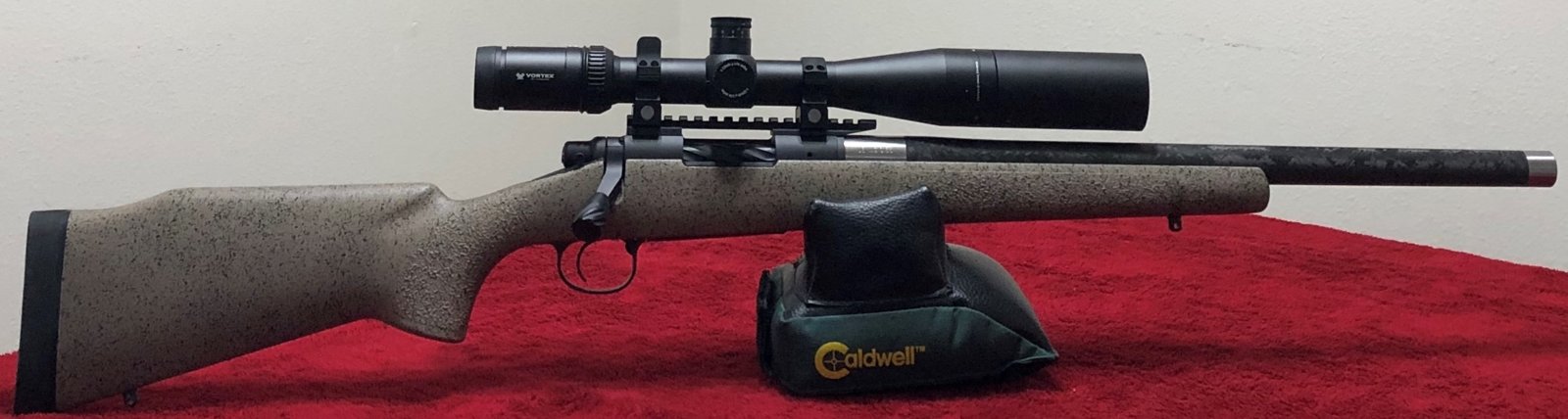

My last build was a 6mm CM built on a SA Rem 700 with a 20in Proof CF barrel, MCM Varmint stock, Vortex HST scope. There is nothing heavy about the stock or the scope on this build yet it still weighs over 9lbs as it sits.

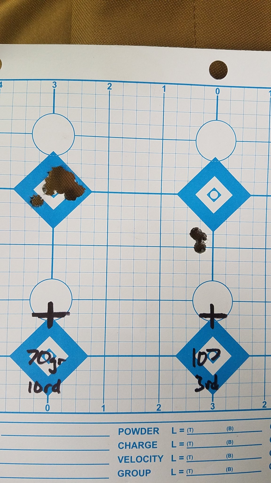

If bigger cats are in the equation, a 6mm might be better, like the 1 i had.
100yds, didn't touch the scope for any change between the 70gr and 107gr loads. Thats a 275yd zero with 70s and 190yd zero on 107smk

Good to know. I appreciate that info. I’ve never even seen a proof in person so I have no clue about the weight or performance... only what I’ve read. What I’ve read has never mentioned what you mentioned. Thank you.
Weight for weight, Carbon fiber is stiffer than steel. Its why racing bikes and aerospace and other structural componenets are made of the stuff when weight matters more than increased cost. Barrels of equal weight, carbon is stiffer.
Disagree with "stiffness", maybe, but the carbon fiber barrels will not walk like similar weight steel sporter barrels.
