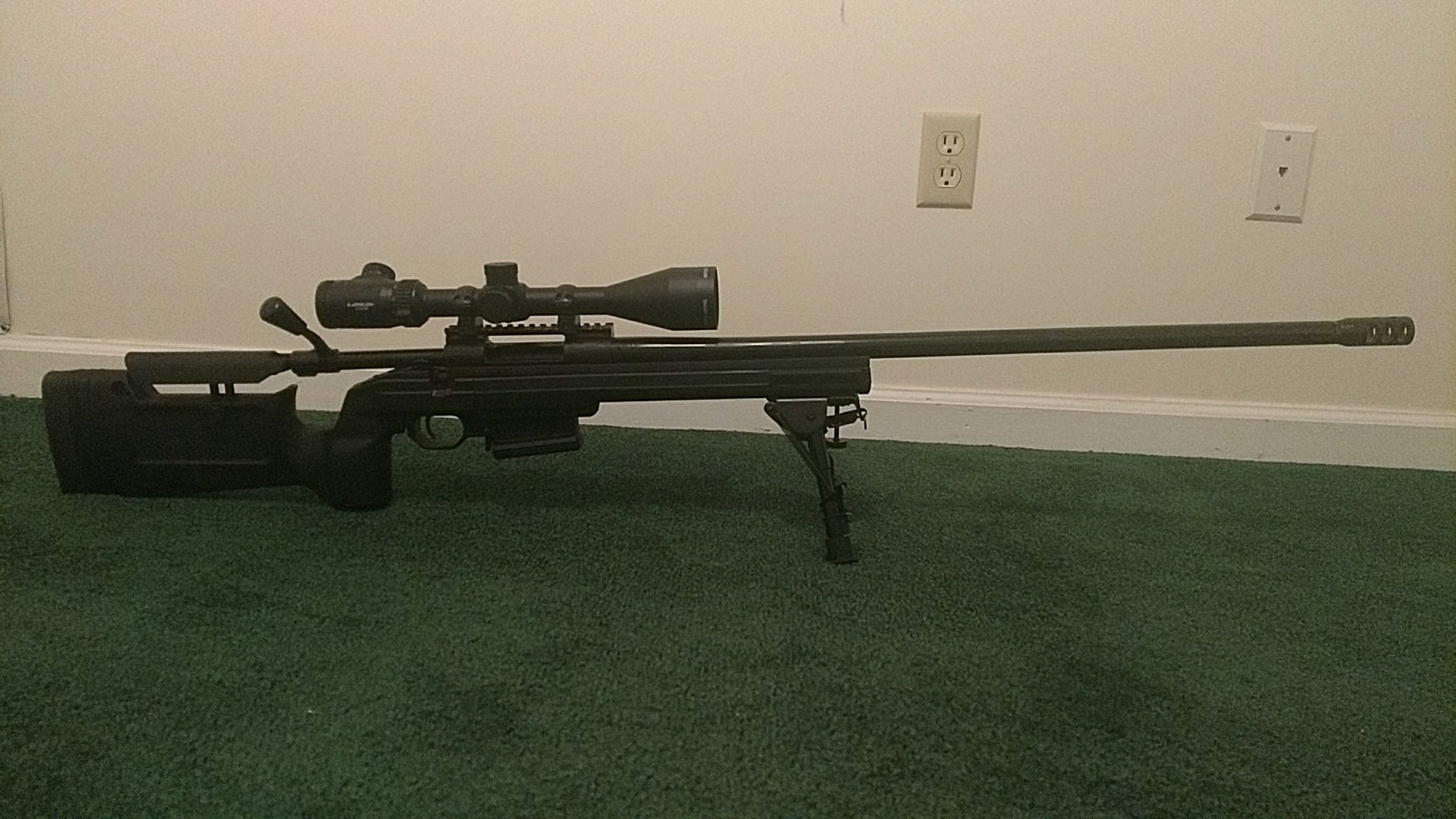

As an update for those following this, I ordered a Howa Bravo today from Brownells. .308, with a 26" barrel. Thanks for all the help!
Won’t be disappointed there, run a search on Howa vs Remington 700 on YouTube videos for a neat comparison. I’ll see if I can find the video and post it. I will not critique the video itself or his opinions however it does point out a few nice to know things about the Howa and Remington if you are unfamiliar with their internals. Also gives a nice side by side comparison.
Ah yes, the brass warning. My Howa Varmint would not extract FGMM.
Their inspection and reply / solution was "we fix these by the pallet" "FGMM BRASS IS NO GOOD".
Probably want to avoid that mistake.
The Howa Bravo came in today... more to follow!
Reactions: Shawd43 and coltm4
