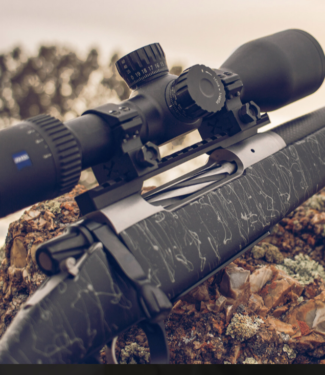

Just buy a Christensen Arms Ridgeline (or even Mesa) rifle. Comes with a muzzle brake (if you need one), is designed for hunting and for under 2 grand comes with a sub MOA guarantee.
those are nice; but even this 6.5lbs carbon barreled gun is going to weigh about 10 lbs once you add a scope setup like in their add, a good sling and a bipod. Still not setup to use a tripod. And the comb is still a bit short for prone.

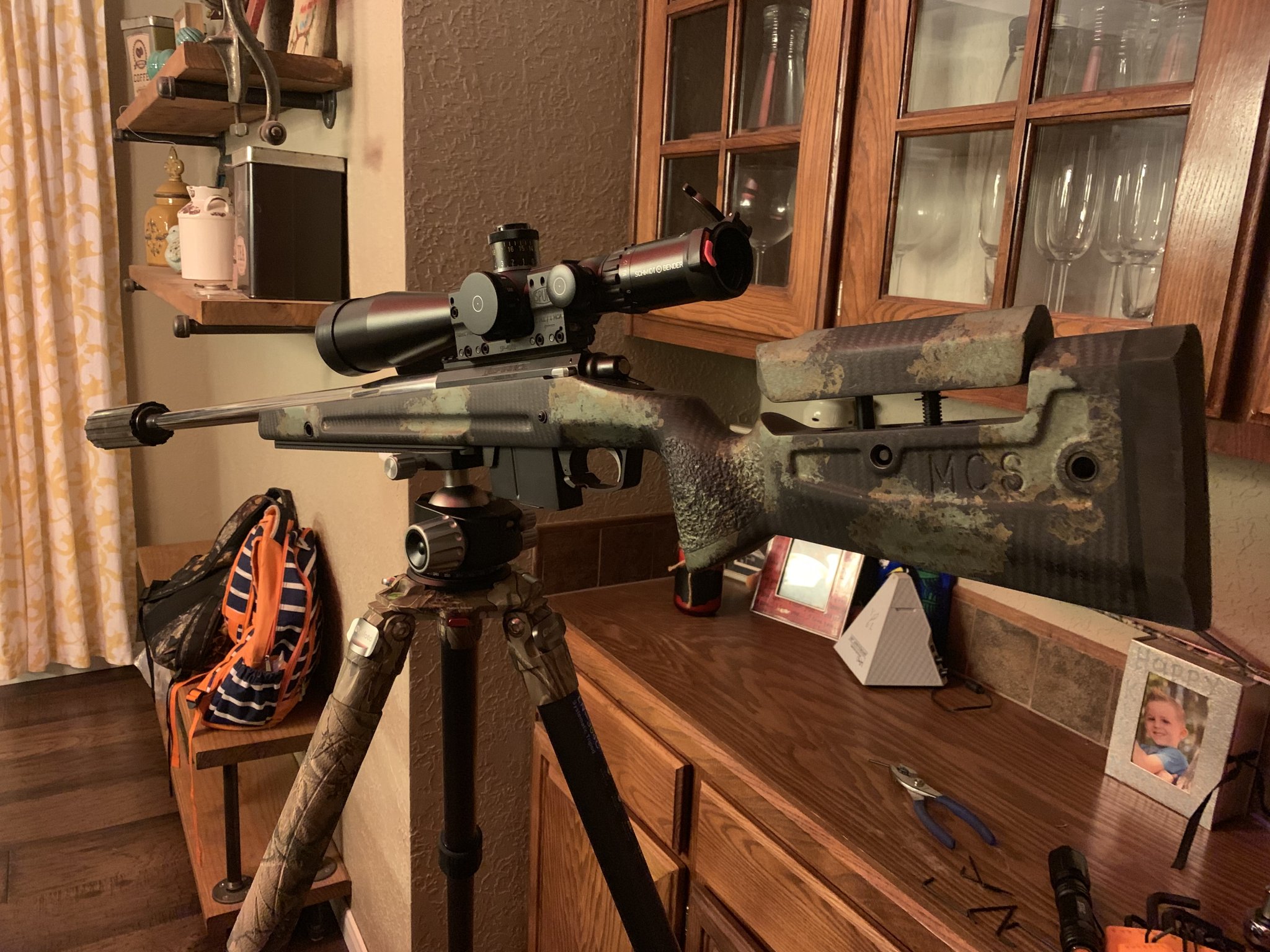

If I didn't care about weight, I would use my MPA built BA lite 6.5 cm with my 3 pound vortex scope. Or My competition MPA, heavier yet.

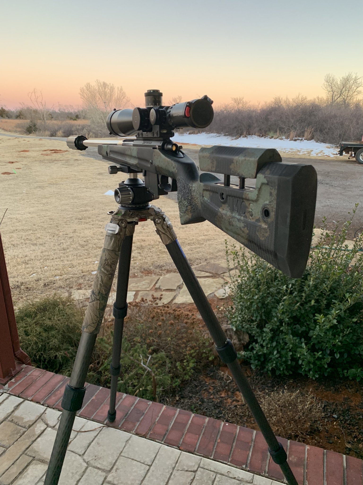

I am really liking the Manners equipped with carbon proof barrels. Each of these are purpose built, and none of them do really well for every situation. I want a variety, and something nice like the ones above ^^^
Thanks! It will end up with an Impact and Carbon Proof in 6.5 prc in the next few months.
That’s the sage flats color that Core did a few months ago. I really like it too! Pretty solid stock. Here’s a better pic View attachment 6997906
I went with the same stock for my match/hunting hybrid and am a massive fan of them. I’ll be building exactly the same build with the exception of a carbon barrel for my backcountry build that will be a backup to the comp build. I’m somewhat of a minimalist so two rifles built in the same calibre with the same ergonomics made sense to me.

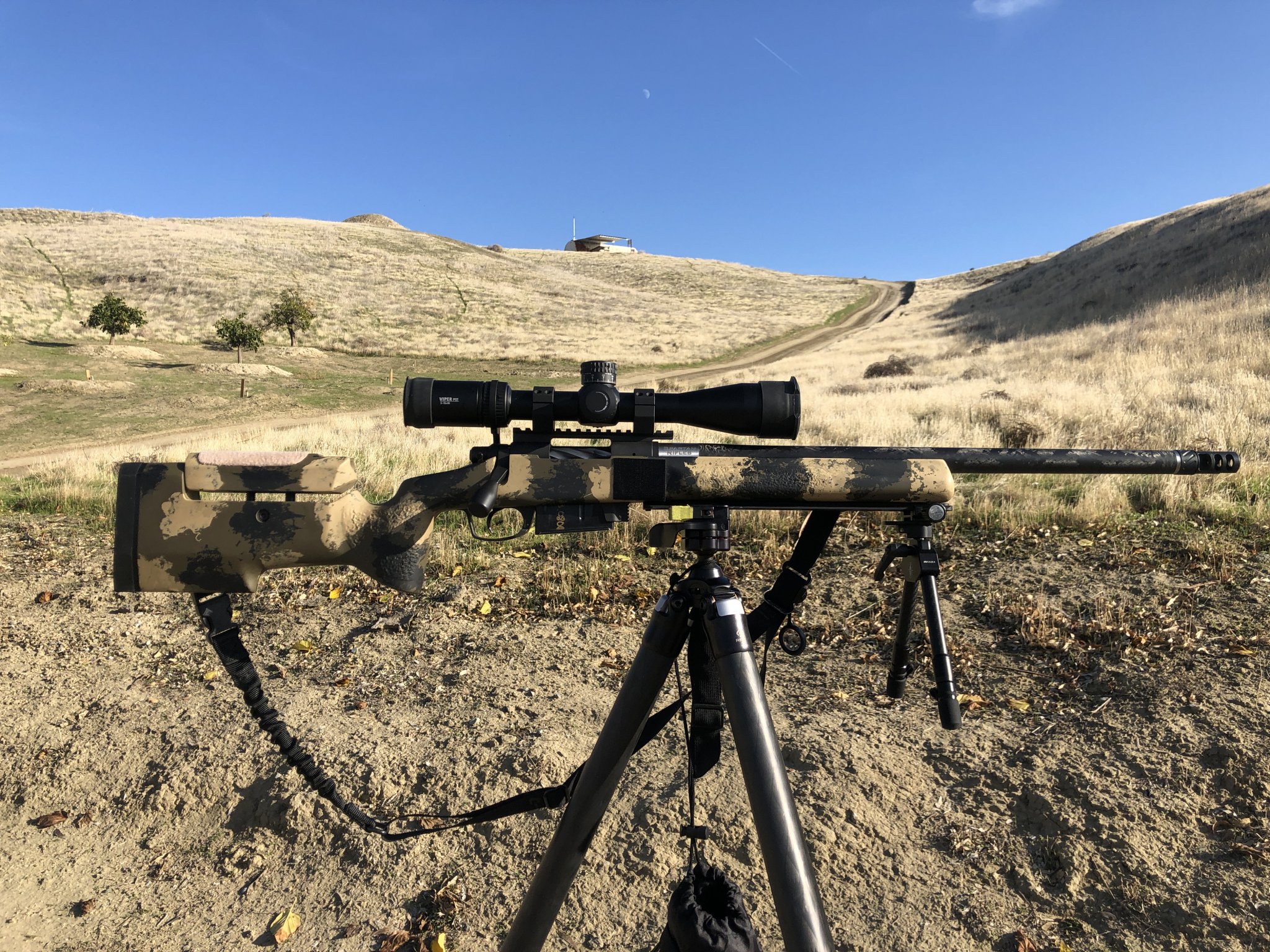

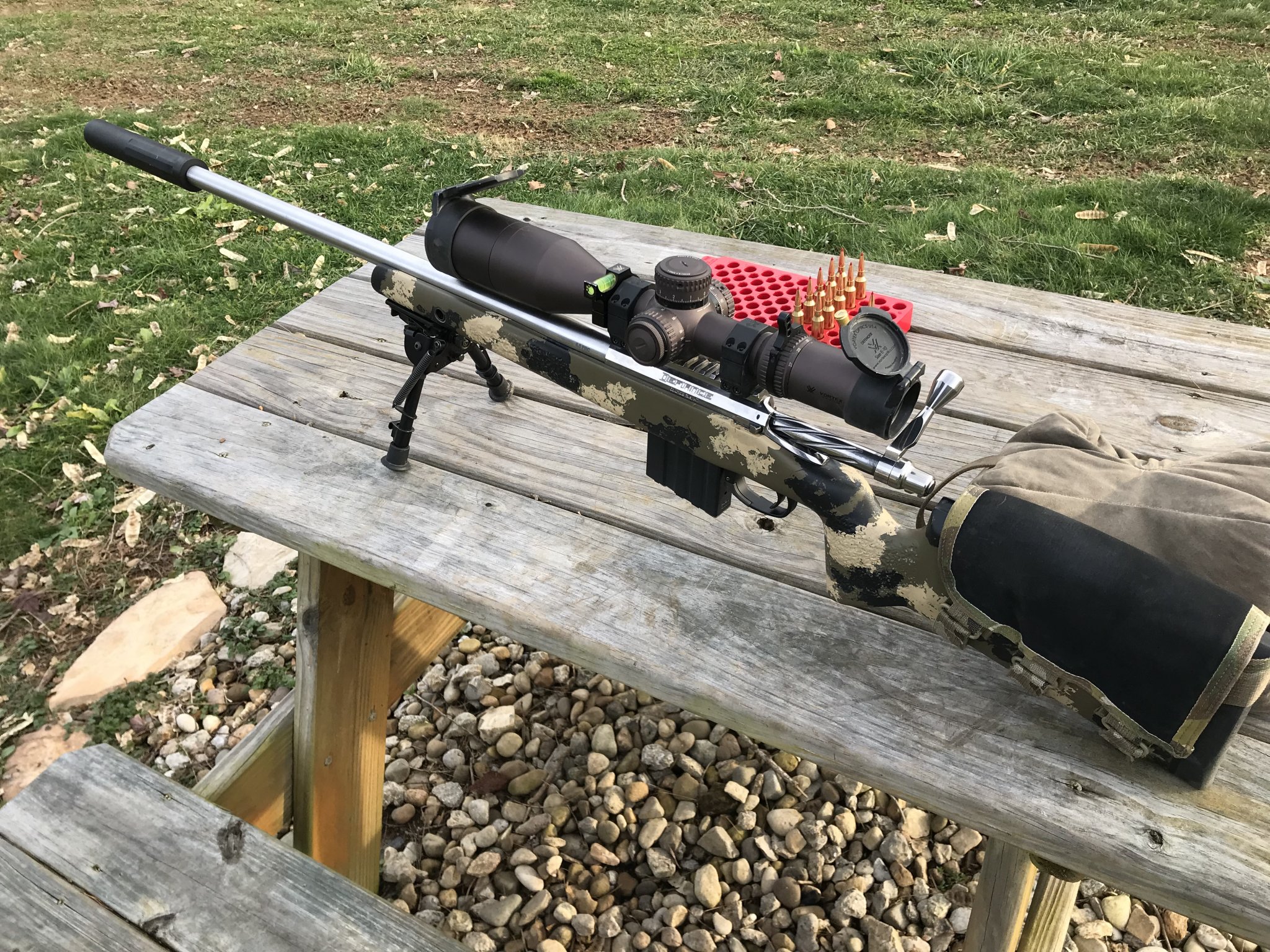

For the record I may very well put together an ultralight rifle. I have had ~7.5 loaded rifle before and just didn’t really dig it. However maybe that was just the rifle? I can see giving it another shot for an ultralight stubby for stalking suppressed in the woods.... but that sure doesn’t mean I don’t love my “heavy” 10 pound rifle enough to drag its ass across a mountain and back.
I am not much of a hunter other than coyotes and stuff like that, but wanted something in case. So I personally went with the 6.5 PRC. My rifle isn’t the lightest but beats my 15-16lbs match rigs
Deviant action
Eh1 stock and I have an XLR check rest I am gonna modify to it.
Barrel is a marksman contour. Slight mix up between me and my smith. So I have the barrel sent to Gradous for fluting.
Have an Amg on order to top it off
Check with Joe Walls of Exodus Rifles. He is my go to smith. Or the Seekins Havak has a lot to offer for the $$. I have some time on them in 6.5 prc. Really nice setup and only a touch over 7lbs.

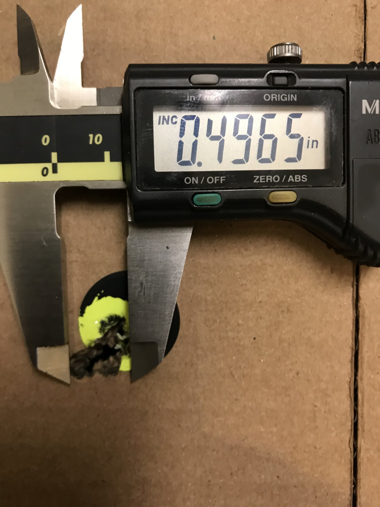

Below is shots 8-12, 5 shot group with 140 Eld-m load I picked from the manual. I pulled the 5th shot as always. It’s the one outside the cluster at 7 O’clock. Lol
