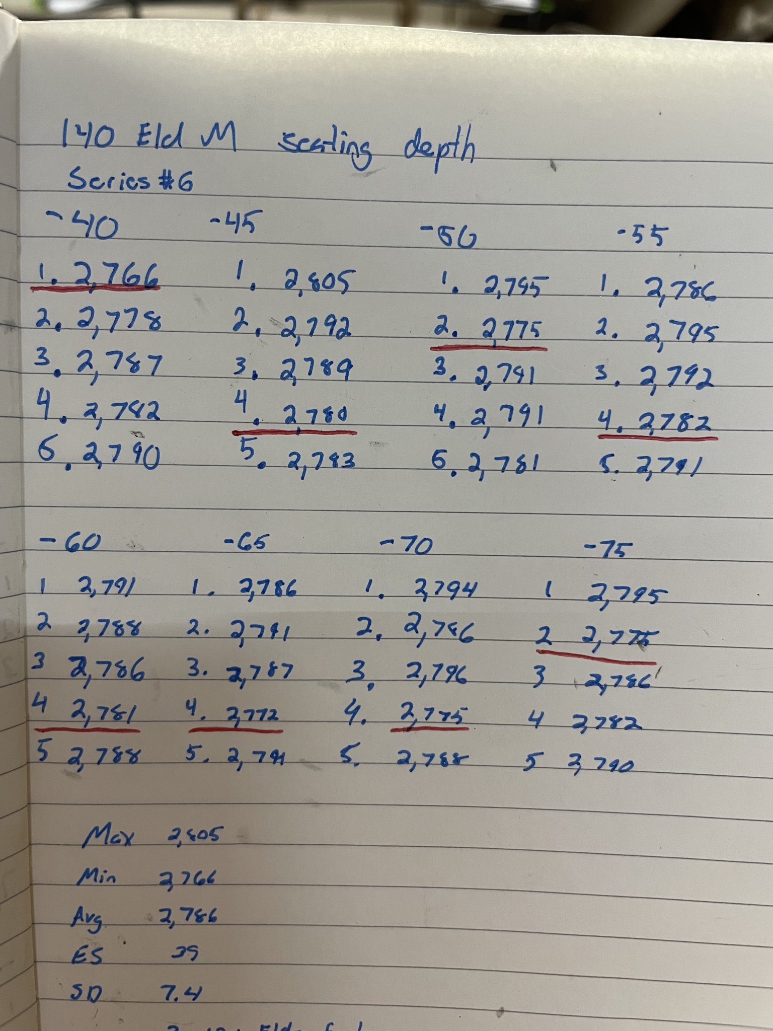

First time reloader here and I'm starting to develop a load for my 6.5 Creedmoor. This morning I completed 5 shot groups in .005 jumps from -.040 to -.075. All shots were at 100 yards, and I shot each group without waiting between shots. I did wait until the barrel was cool to the touch before shooting the next group (10-15 minutes).
I used a magneto speed to record all the shots, (attached to arca rail) and I noticed the 4th shot in 5 of the 8 series was the slowest, think that's coincidental or could there be a reason for this?
I'm not sure if should I should pick one of these jumps and move onto OCW or do some seating depth testing. Any advice is appreciated.

Why didn’t you run an OCW first? What is your minimum velocity requirement for the rifle/bullet combo?
Also, if/when you do your OCW (assuming your not currently satisfied with the above results using 41.5g), do NOT shoot it with the magnetospeed attached (disregard this - overlooked the fact it’s attached to your rail not your barrel).
I don’t see much, if any obvious variation in your groups so I’d jump them more towards .075 to keep pressure down, as your load shouldn’t be compressed using Lapua brass.

Ok. At this point id do a brief 3-5 shot OCW starting at 41g in .3g increments to 41.9g to see if your POi is stable through that range, assuming your MV is satisfactory to you
Ok. At this point id do a brief 3-5 shot OCW starting at 41g in .3g increments to 41.9g to see if your POi is stable through that range, assuming your MV is satisfactory to you - do NOT attach the magnetospeed for this. seating depth is your call.

How many rounds for each charge weight? If less than 20 then ignore SD/ES. 20 is the bare min I’d need for that info to be useful.
