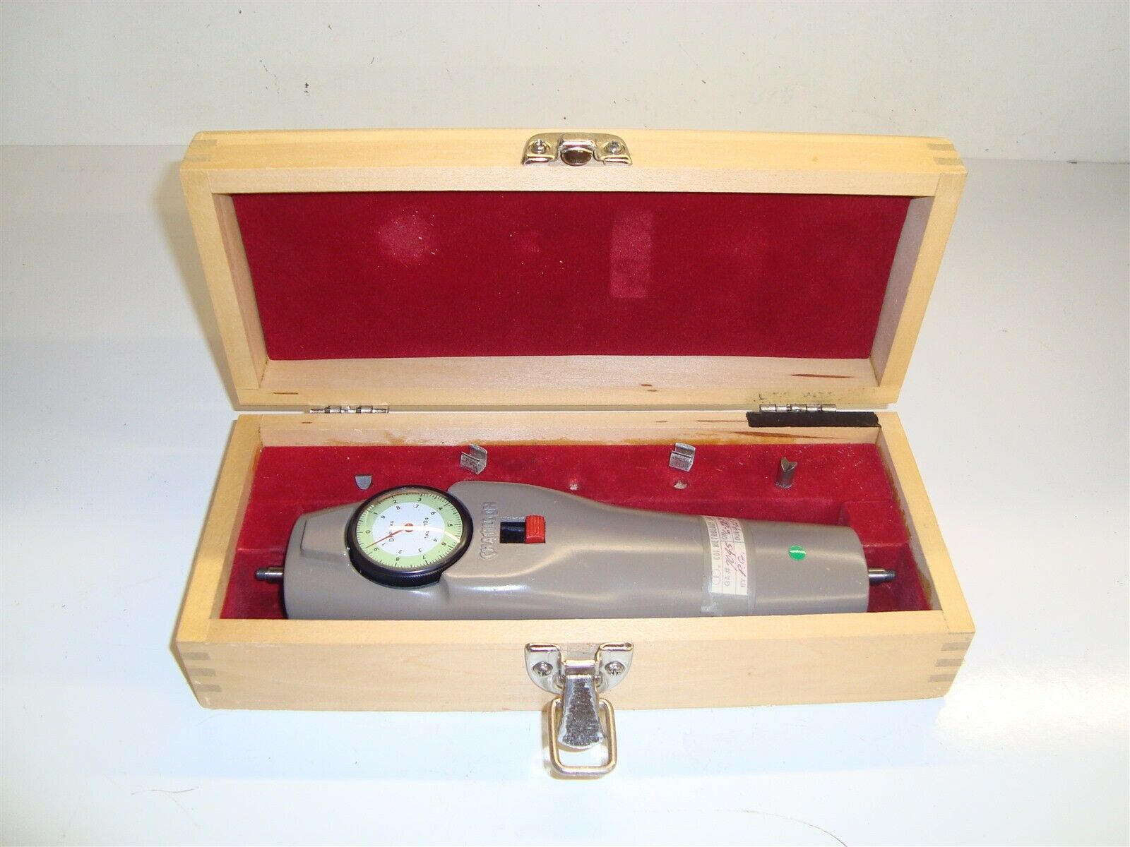

    Search eBay for a Chatillon Force Gauge. Look for one 0-5 lbs, or 0-10 lbs. They measure on both push and pull. Threaded input rod makes it easy to make a hook from music wire and a 1/4-20 nut. The switch on the front will freeze the gauge at the maximum pull/push weight. Many available under $50.
