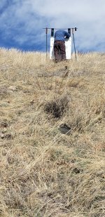

    I agree with setting larger targets. This is 36" for 2050 yards. I have a 24" just below. I'm fortunate to be able to leave mine up. 10-12 varying wind is tough at those distances, even on the big plate.
    Do the math for a 2mph pick up or let off!

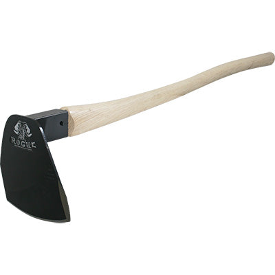

    One of these is handy for clearing brush around the target or shooting position.
    It's not ideal for anything but works for just about everything from grass up to maybe 1" madrone. It's great for digging out that 1 rock in exactly the wrong spot under the shooting mat.
