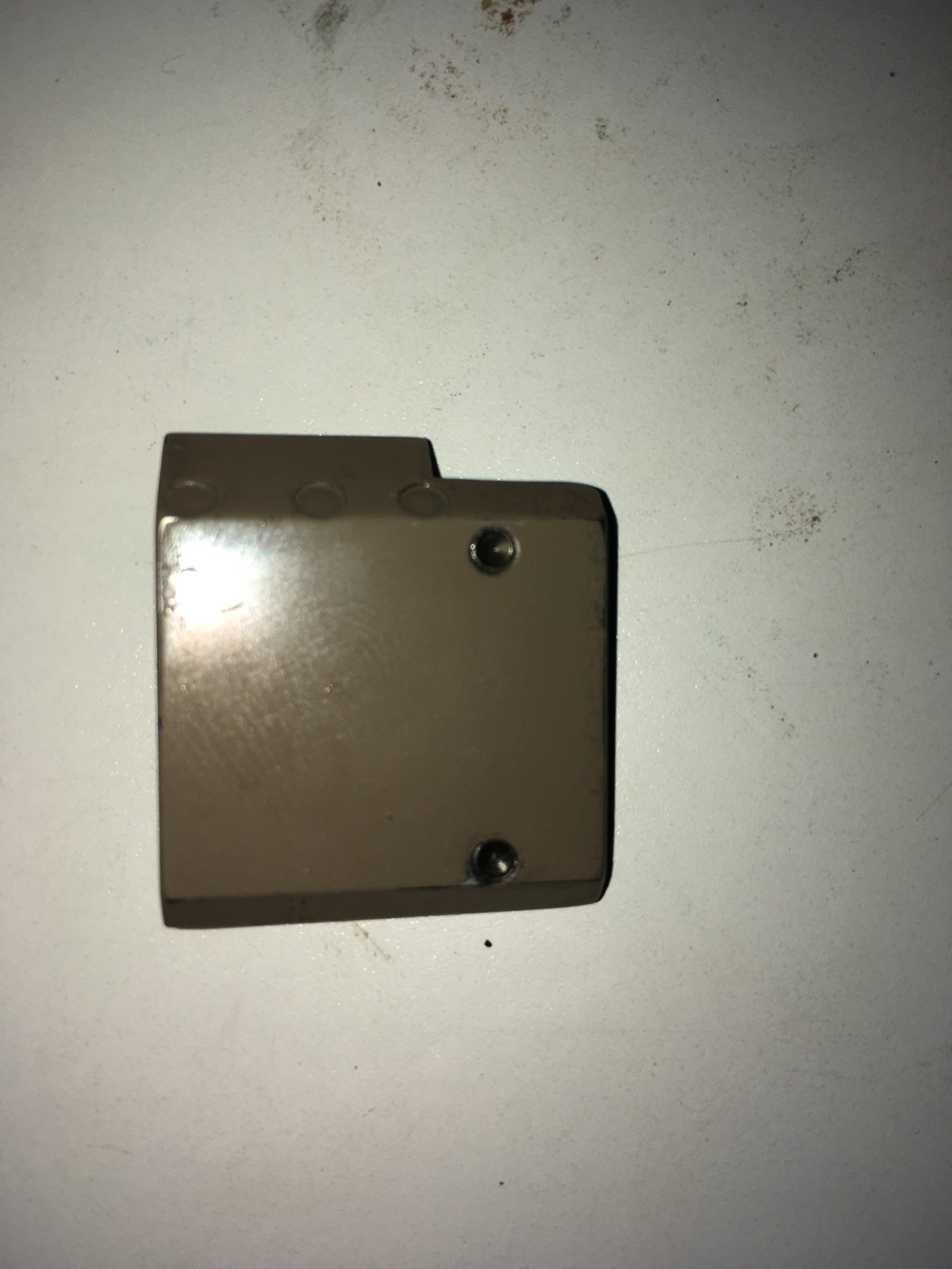

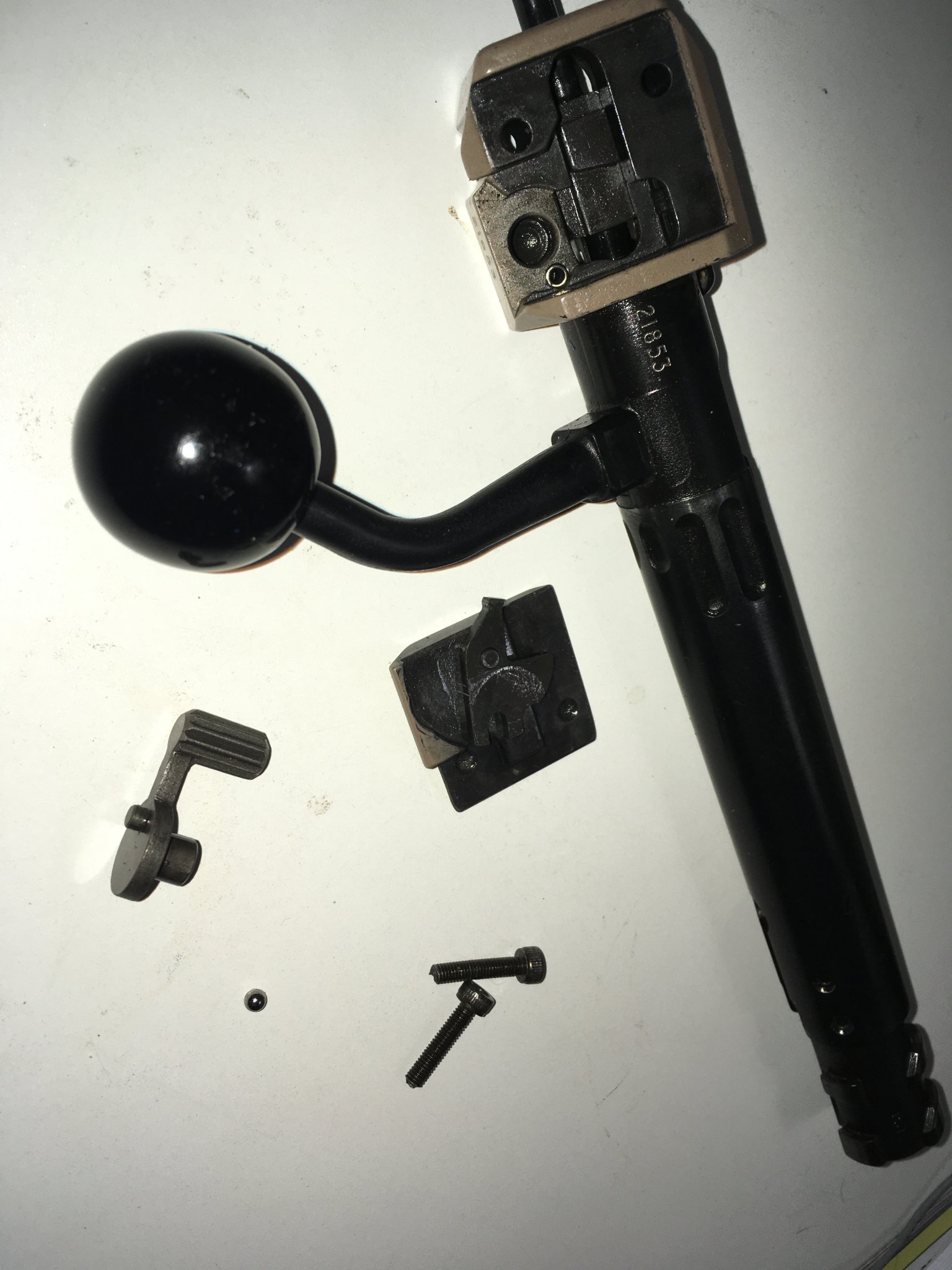

    I was shooting today and all of the sudden I couldn’t close the bolt. Pulled the bolt out and the bolts dropped out the bottom and top fell off. Any ideas

    unless you took to the AI armorers maintenance course and have the manual, I would just send it in to either Mile High or AINA

    You should send it back. Don’t even think twice about it. Two screws worth 15 cents failed. It was probably due to overtorque, not the screw itself. Not a huge deal. Like Dthomas, I’ve never seen that happen to an AI shroud. It’s not a highly stressed part.

    Ok I’ll bite, did you have any trouble putting the safety on ?
    Do you work the safety a lot ?
    Reason I ask, that lil lever, ball and tiny spring are what control the safety.
    I’ve seen those screws work loose on 2 rifles, but it was caught when closing the bolt and feeling a slight snag when the touch the rear or action.
    if they worked out to much and your ran the bolt home I could possibly see where they might bend, but not shear.

    i actually never use the safety, it did snag when the bolts dropped down and that what caused me to take the bolt out. I was confused at first because I thought it was a missfeed because the bolts dropped out from the bottom side so I couldn’t see it when I was in the prone position.

    That’s so odd they just shear. I’ve seen them walk loose and just retorqued them. I used nail polish on the top to loctite them in.

    I've had it happen. The screws come loose, back out and if you run the bolt they will sheer off. Same with the screw that holds in the firing pin. Blue locktite is the answer.

    Actions are bonded to chassis to "bed" them to fill voids and increase accuracy just like customs are bedded. Those screws don't back off unless they're messed with... and both screws at the same time... what are the odds of that? Also not sure how those bolts could shear at the very top of the shroud instead of shearing at the head if this were the case.
    I'd put my money on the screws being severely overtightened and they were finally stressed enough from firing to fail. That also explains how they could both fail at the same time.
