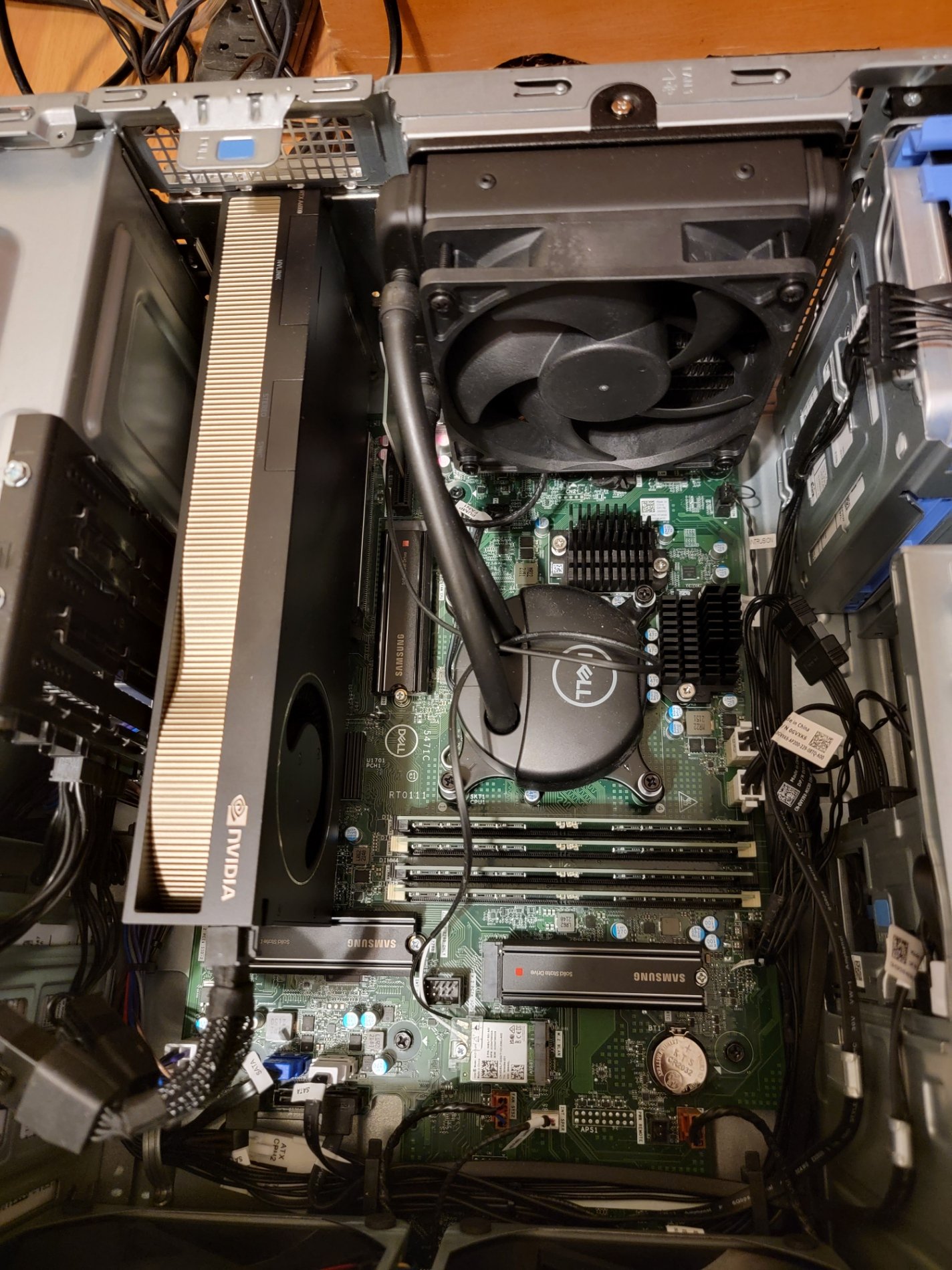

Right now water cooling is mostly about having your computer be nice and quiet. Or having things more compact, as you can air cool even very high power draw computer parts, given a big enough case, big enough radiators and big enough fans, but at a certain point it becomes too annoying to be around. If you try running a 3090 class card at 100% while pushing your high end CPU hard, it's going to be an annoying level of sound to say the least.
(going up from there, I deal in rackmount servers and switches that have to be in a dedicated room as the fans can be so loud).
However in the near future, I think both the GPUs and the CPUs are going to hit the point where liquid cooling is going to become much more of a standard for anything high end.
As the next generation of Nvidia cards starts pushing a 3 slot minimum design with something like 1.3x height and power draws over 400w, Liquid cooling is going to be something you'll want big time.
Quite a few companies are already working on making liquid cooling for datacenter rackmounted servers much easier, as the new generation of Processors from Nvidia and such have crazy high thermal envelopes and then if you wanted a pair of the fastest CPUs, those are pushing the limits of air cooling already.

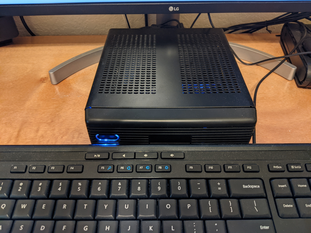

All depends on your needs. We sell 100's of Intel NUC's to all of our business clients. They love them and the i5 and i7 variants are more than enough for day to day office needs. Mounts to the back of their monitor with VESA... Core i7, 16 or 32GB or ram, NVME... WIFI6 and Gigabit LAN, USB 3.0 and Thunderbolt...
But that isnt what the OP is looking for, he is trying to build a performance workstation. You arent getting that in that small a footprint. You can get close with Intel Dragon Canyon though 12th Gen, i9, 3060, 64GB RAM, NVME....

I wouldn't even consider a new full size desktop type computer w/o water cooling these days.
CPU's are easily capable of overheating with ANY air cooling solution out there.
They can also easily push well over 200 watts thru the cpu.....exactly what air cooler will handle that all day every day ?
Are you going to undervolt your desktop to accommodate it ?
You would have to.
Probably just like Padom, I ran that old Koolance with a Barton core AMD 2500 @ 3200.
It was the shit back in those days and ran room temps on the CPU all day long.
Those Corsair units are bombproof and about the same cost as a high end air cooler but cool way better, should keep a high end CPU under 60C or so under heavy use.
Air cooler will throttle, period.
