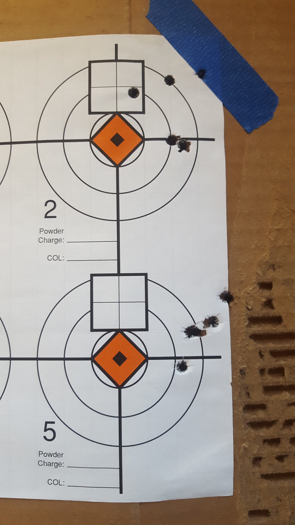

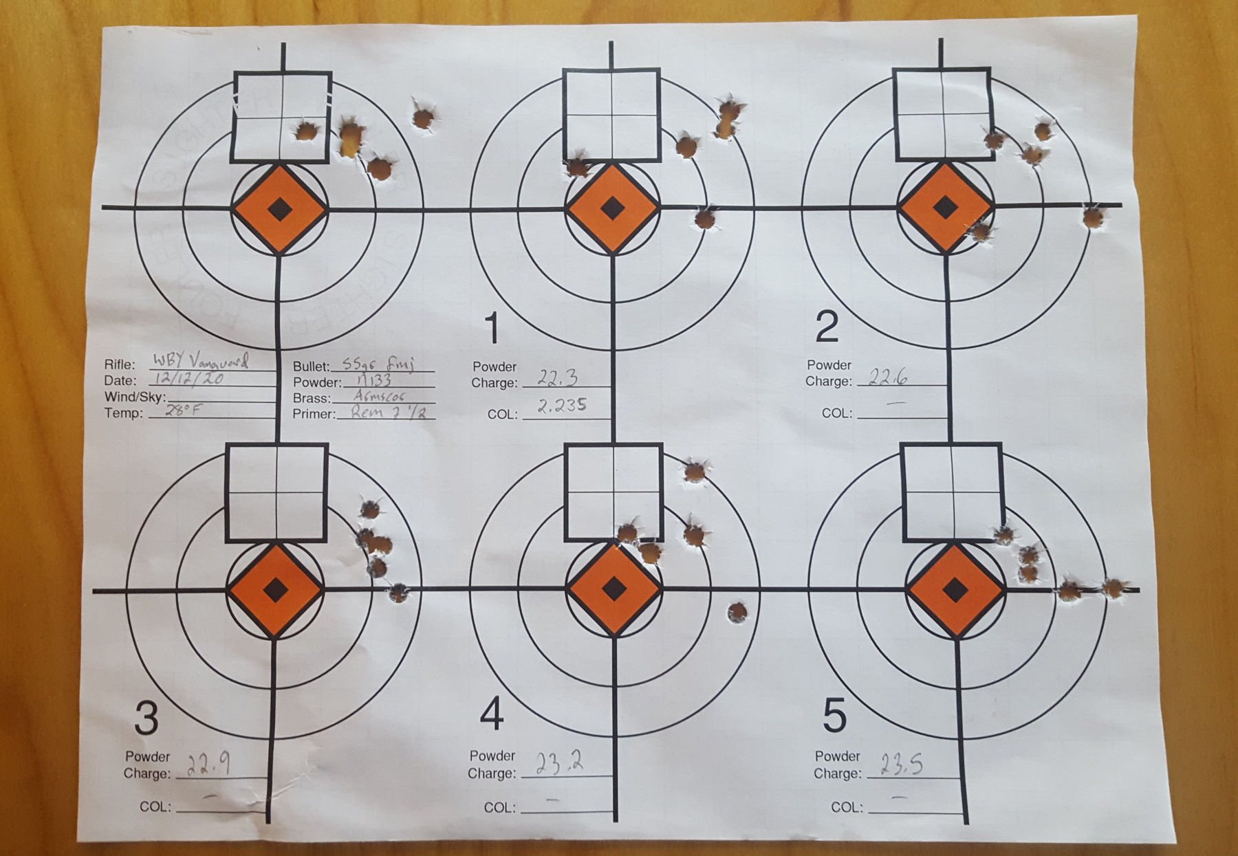

I'm doing load development for my new .223 Vanguard (VA38223RR4T) Accuguard w/ #3 barrel. I'm not getting good results and need help diagnosing the problem(s). These are 5 shot groups at 100 yards, fired round-robin with 5 minutes between strings. The rifle was on front and rear bags, shooting prone. It's in the factory tupperware stock which I think is part of the issue, and I did pillar bed the stock and free-float the barrel before shooting these groups. I made sure all scope, base, and action screws were correctly torqued to their factory specs. Group 3 is technically sub-moa, but why the vertical stringing? The sighter/fouler group at upper left is my standard 55gr AR-15 load of 23gr N133 with the same brass and primer.
Of the other groups, two show more horizontal dispersion than vertical, one the others is about even and the last might be slightly more vertical than horizontal.
I had an OCW that was hard to decipher. I ended up coming to the unmistakable conclusion that the variability induced by the shooter was obscuring the variability induced by minor load changes and the limitations of the rifle. Not enough signal, too much noise.

@lowlight I was able to get out today and shoot two groups for your review. I already noticed a couple things I need to improve, will add them below with spoilers so I don't influence anyone. Looking forward to learning how much I don't know.
I need to step through my position and double-check everything before starting the shot. Are my heels down? Is my NPA correct? Is the rifle in my shoulder pocket? Are my hands where they need to be, and doing what they need to be doing? Stuff like that. I also saw I developed a flinch in the second string, so I should no doubt be dry-firing between groups. It was really bright though, and I was looking into the sun.
Top group is "first_string" and bottom group is "second_string". Both about 1.5"@ 100yd, using 23gr load from first post.

You definitely have some lateral stability issues because you are shooting off the bag. You look canted to me but hard to say just based on the angle, but you have a lot of left and right adjustments happening between shots.
Multi presses going on too, you are jerking the trigger a few times in the first, crushing other times. Looks like back and towards the camera press.
Overall I would not say, you should NOT be shooting groups that bad, so maybe there is a mismatch with the ammo going on here too, but for sure the bouncing you are doing left and right is not putting you in the same location and from my angle, you look canted away from the camera. I get you are shooting out of a truck bed, but the bag is doing you no favors here.
The multi groups you shoot are because of the movement, you are fidgeting back and forth to straighten the rifle because nothing is holding it. When you see, two round touching, one round off, maybe another two or so touching you are moving between shots and resetting the location of the rifle. In this case, you are not returning to the same place for the next shot so the whole setup is moving enough to trend you to the side.
The stringing I see I want to say is part of that cant I am noticing. In my mind it almost looks like your scope is crooked in the rings when I try to compare the two, I would have to see directly behind you for sure.

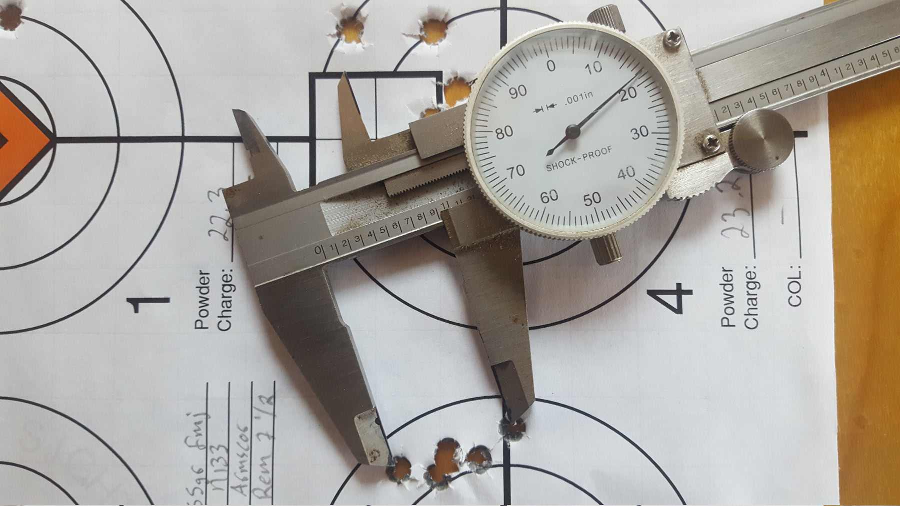

You honestly don't need the mandrel or a micro seater, just some calipers that are accurate and use the expander button in the sizing die. If you wanna get super super precise then sure get all the fancy stuff, Panhandle Precision guy just uses the button expander in his 260 Rem.
That's great, I have a pair of Mitutoyo analog calipers which should be accurate enough. I didn't realize I could adjust the expander in the sizing die...clearly I need to re-read the instructions. Thanks guys, learning is much easier with some help.
This isn’t “the” problem because guys can shoot good groups like this, but it’s a great illustration of what I constantly preach with recoil management/fundamentals. IMO, for a true NPA you have to have the rifle connected to you. So you need to connect yourself to the ground and connect the rifle to you. You are connecting the rifle to the ground(the truck) and then connecting yourself to the rifle. It sounds like semantics but there’s a huge difference. This is one of the reasons you are having to adjust so much. Your 100% dependent on the bag to keep you on target but also forcing the bag to support part of you when you mount up on the rifle. You want to drive the rifle, not ride the rifle... if that makes sense.
