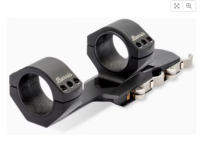

I just found this which looks like it might work if I can’t find anything else. But I kind of think this would look pretty dumb on the gun…
I use one of those on my ARs.
I like it.

Cantilever mounts come 0MOA or with incline built in, mounting it backwards will do the exact opposite or mounting it forward.
Why not just change the base? Or buy a different optic that doesn’t suck because it doesn’t even have 60MOA of travel?

I got the 3-15x42, which I like a lot. When I installed it in an American Defense 30mm mount and tried to zero it, I came up just a couple clicks short. I swapped the mount for the XTR rings and with a -5moa cant, I was able to zero and still have 3 mils of downward travel left. This is without the RevStop installed.
I've been playing with it to figure out the proper eye relief and at max magnification, I need to move the scope forward about 1/2". The front ring is currently right at the edge of the rail, and the turrets are about 1/8" behind that. I didn't want to push the turrets any closer to the ring. I suppose I could also look to extend the stock, which is another option, if the Burris mount pictured above won't work.

Hopefully the Burris mount will solve everything, or it will identify the next issue that I didn’t see coming…
