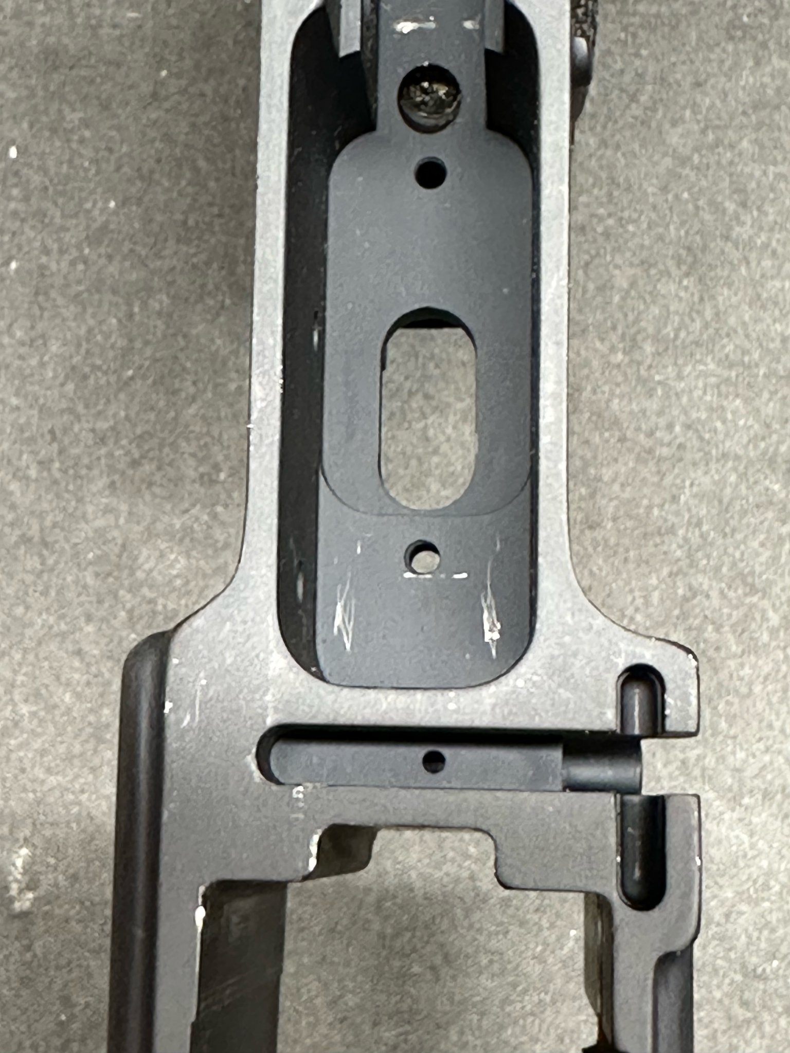

    Fellas - I just picked up an early SR25 lower in mint condition. It's pre-94, and I'm in a ban state .... so this was a good find.
    However .... it didn't come with a bolt catch and I don't recognize the design. I need help identifying what to look for. Any help would be greatly appreciated.

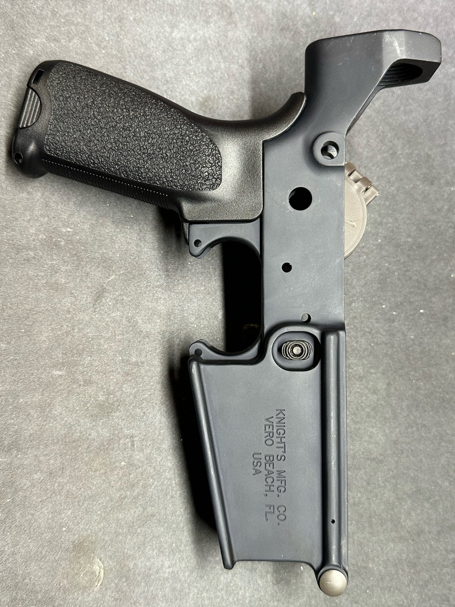

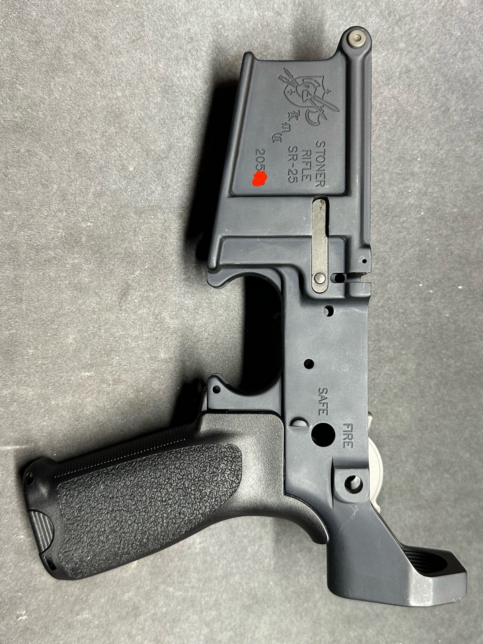

    Thanks, John. I traded emails with them today and provided lots of photos. They seem to be struggling to ID it as well. Hopefully they come back with something after tracing the serial number. Here are a couple other photos:

    That certainly is unusual. I suspect you may have to fabricate one. Fulton FAR10 uses a unusual bolt catch retention design. It will not be compatible, but might help to visualize the intent.

    Thanks, John. I traded emails with them today and provided lots of photos. They seem to be struggling to ID it as well. Hopefully they come back with something after tracing the serial number. Here are a couple other photos:View attachment 8118382

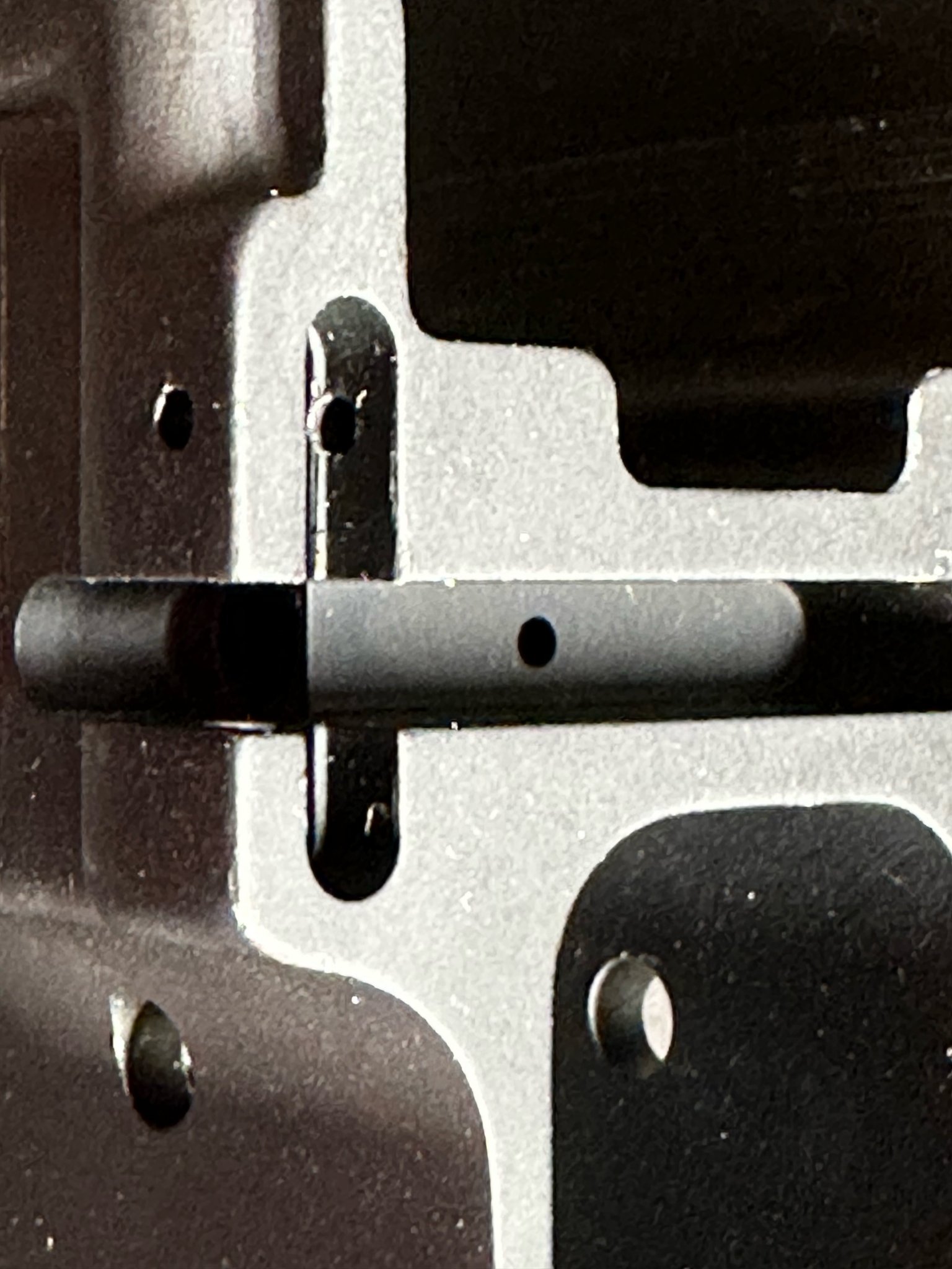

    Thanks, buddy. Yep ... that's a standard bolt catch design. If you look at the channel milled into this lower, you will see that it won't work. The channel is milled where the bolt catch pin would normally go .... weird.

    There are a few posts in here about early SR25s that have the same bolt catch design as yours.
    You could try messaging some of the folks in that thread to see if they own those rifles and can give you any better pictures or specs on the bolt catch. If KAC doesn't have the parts any more you will likely have to fabricate.

    It appears this is a very early production SR25 lower .....

    KAC said these really early SR25 lowers had a bunch of proprietary parts, and that several modern standard components, possibly including trigger components, could potentially require fitting in order to work. They said they have some of the early parts still laying around, and at least one of the guys from that early era is still at KAC.
    They offered to receive my lower and evaluate/refit for me. I will be responsible for parts and shop time. So .... my lower is back at the Mother Ship awaiting refitting. When I get it back, I will update.
