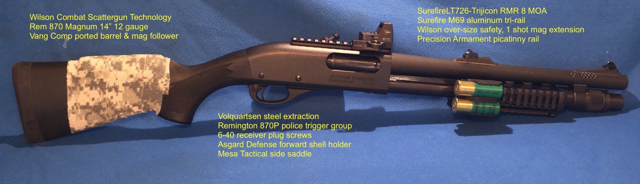

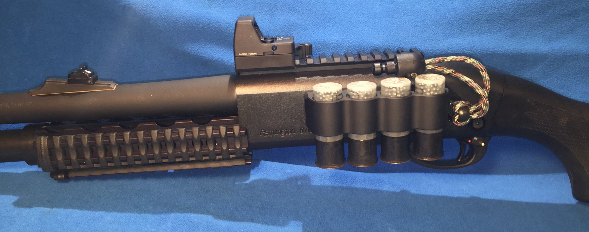

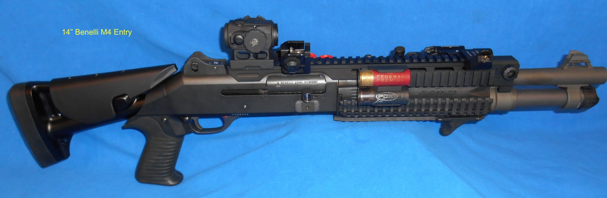

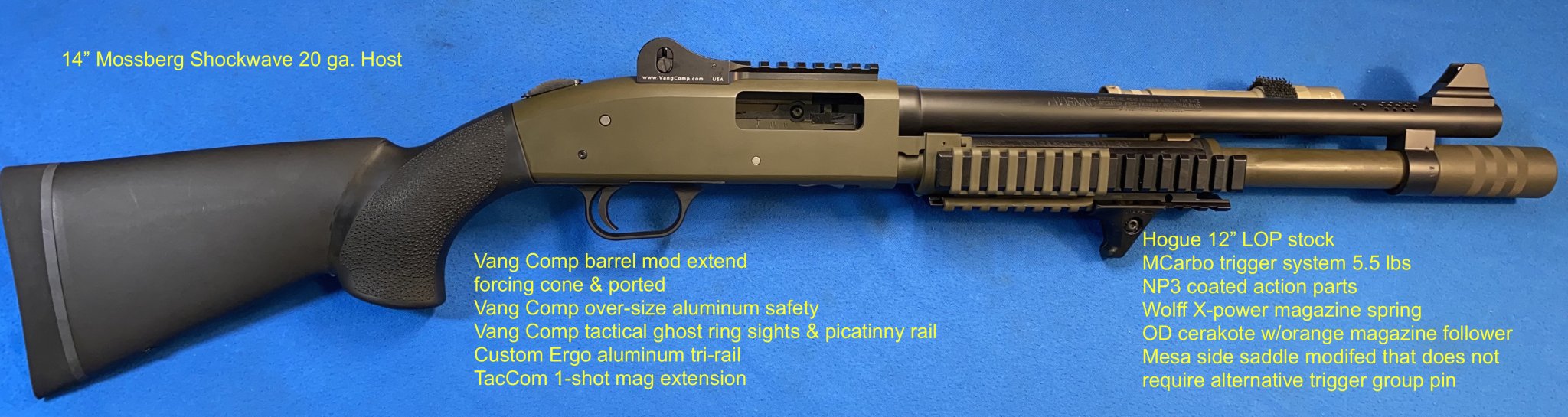

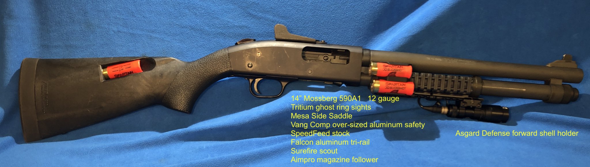

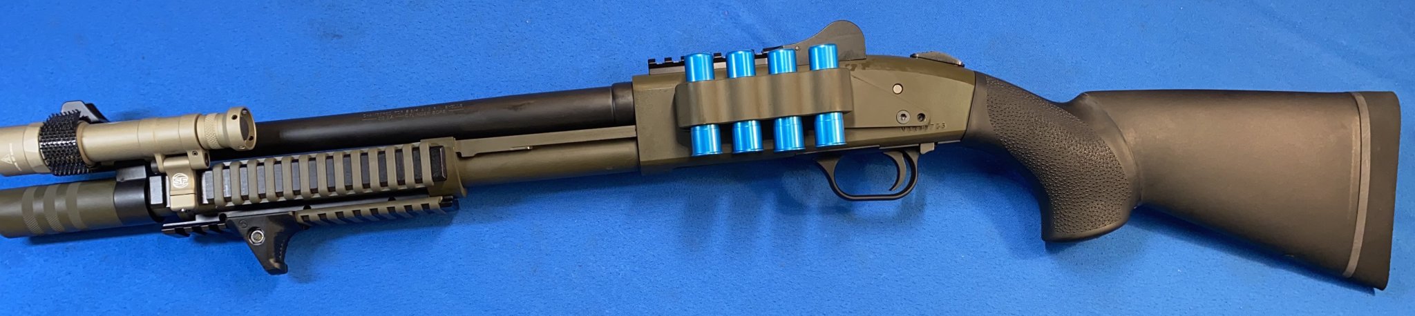

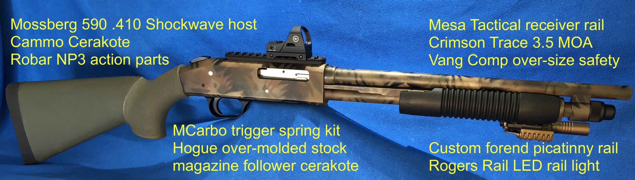

Here's a few my short ones from under the bed.
Wilson started as an 18" with a pig heavy surfefire forend-light ; replace the barrel with a stock 14" magnum then modified it.
Shockwave is a good 14" host to modify (non-BATFE to BATFE registry requirement).
I think the 20 gauge maybe the best home defense setup.
IMG_3347Mossberg 590A1 with Asgard Defense Forward Shell Holder Photos copy 2.JPG

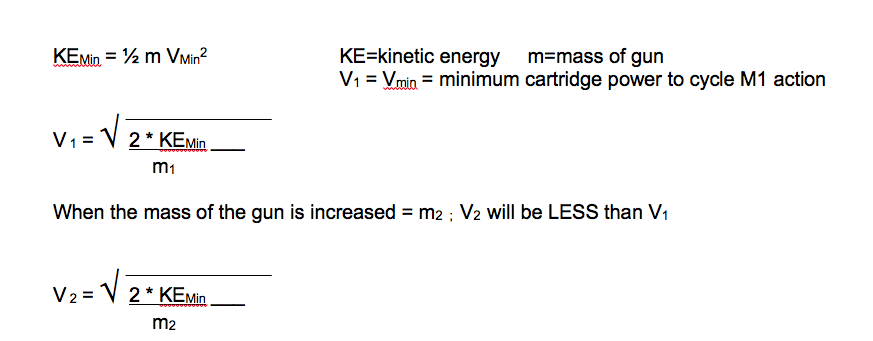

because if the inertia recoil you cant mount anything on the receiver without affecting function.
You can add weight however the total weight added to the firearm should not exceed the weight of the inertia bolt.
From the Benelli M1 Manual:
"Extensive testing in ballistics labs and repeated field-testing of our line produced weapons put at 180 kgm the lowest level of kinetic energy that must be generated by the cartridge 12 gauge and at 125 kgm for 20 gauge to fully cycle the action (the measurement was taken on a manometric barrel, according to at a velocity of V1 at 10 meter distance from the muzzle). Empirically, Benelli has determined the minimum threshold of kinetic energy required to cycle the bolt; the rest of the understanding is simple mathematics / physics."
Because V2 is less than V1, the minimum amount of kinetic energy to cycle the inertia bolt mechanism is not generated.
The Benelli M1 20 gauge inertia bolt weighs 385 grams.
Two 20 gauge cartridges weigh 65 grams
Two shot magazine tube extension weighs 300 grams
Total = 365 grams
So, a 2 shot extension tube with cartridges is within 20 grams (2/3 of ounce) weight of the inertia bolt weight.
The attached may assist in understanding how adding weight / mass to the inertia platform may interfere with reliable cycling operation. The 20 gauge M1 bolt weighs 385 grams; a 2 shot magazine tube extension weighs 300 grams Plus 65 grams for the 2 cartridges and you have 365 grams of extra weight; almost the weight of the bolt.
Third parties cite Benelli sources as stating that ~ 500 grams of added weight (1.1 pounds) begins to reduce reliable function. A 12 gauge 2 shot extension and two 3" cartridges is just about 500 grams......again, just about the mass of the 12 gauge inertia bolt.
So, the addition of the 2-shot extensions plus the cartridges do not exceed the bolt weight, but add a Picatinny rail and a light etc......therein the problems of operation may begin to be experienced.

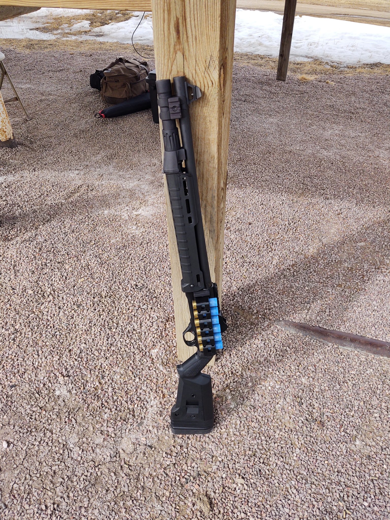

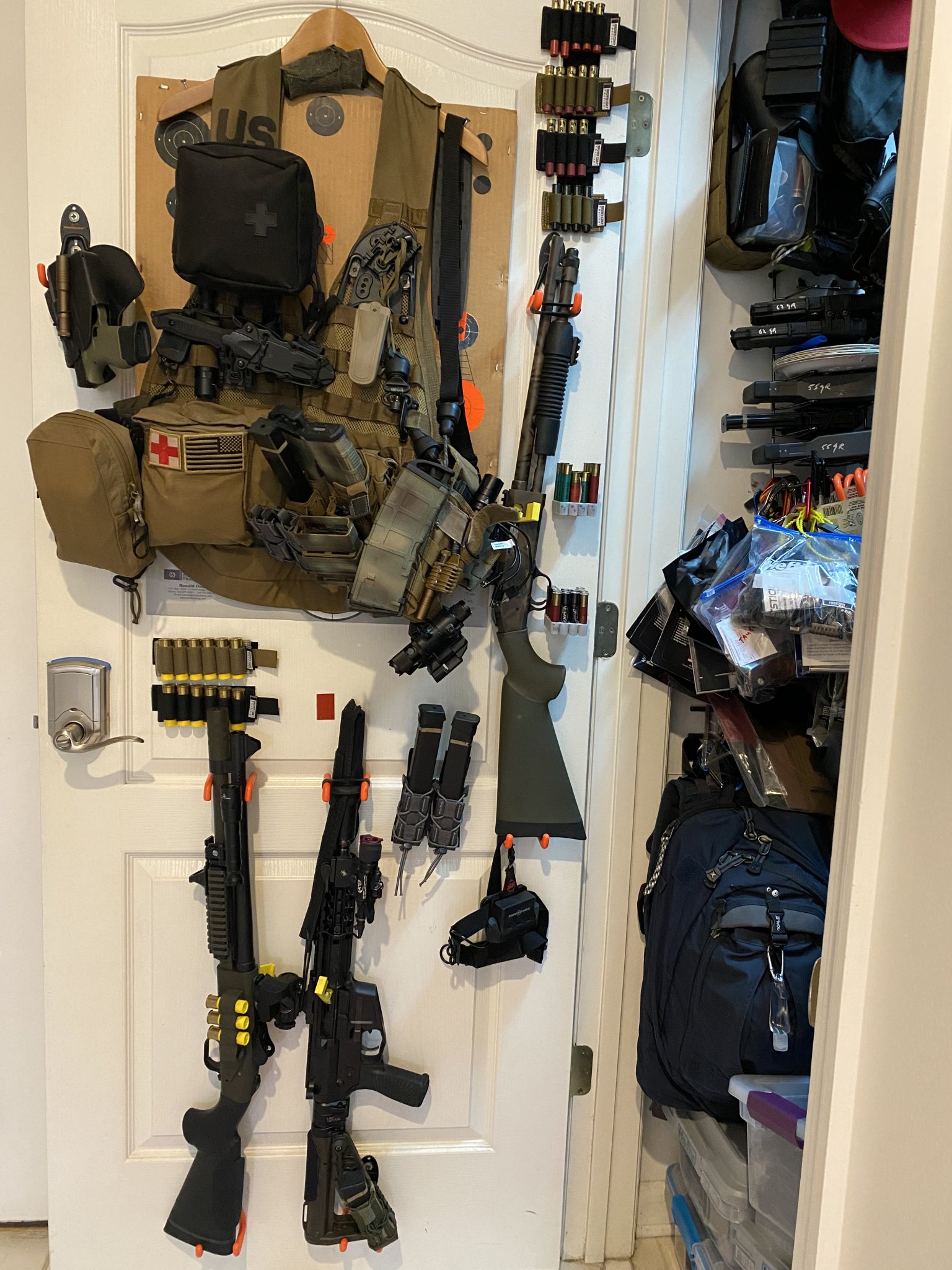

Fwiw, I have a 1300 Speedfeed mounted above my bedroom's walk in closet door, on the inside. Very much out of sight, and easy to access.
870 above my shop door in the same fashion.
The hooks are from Home Depot. Cheap garage hooks of some sort.
Who knew the hooks came in orange ?........a closet inside secure load out room1, inside secure load out room2. It's quite a rabbit hole.
Love the Home Depot.....let's do it.
