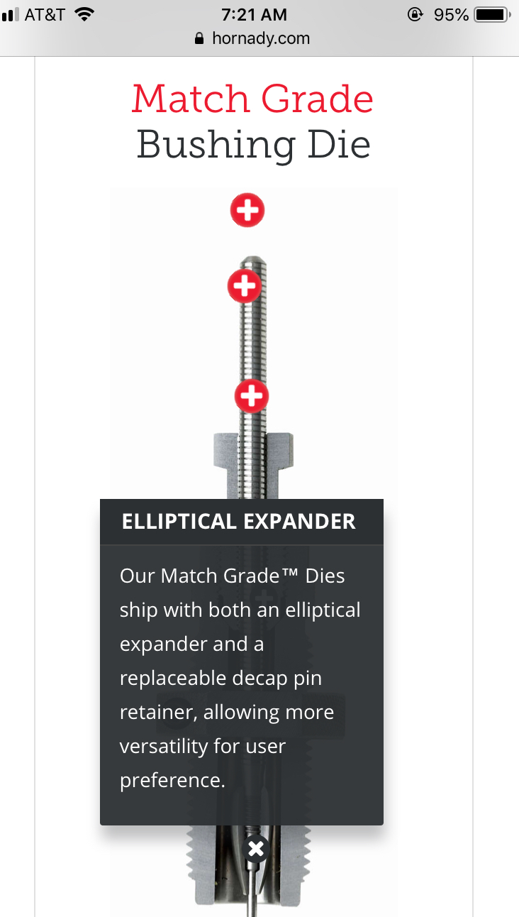

Quick question, If a buy a Hornady match bushing die and take out the expander ball and bushing, would I effectively have a body die i.e. equivalent to a redding body die? Thank you
Yes, just as you could with any bushing FL die. The rod and expander ball design(if you purchase the ball) is way better than Redding. So it’s very usable. The rod floats and the expander ball has very little bearing surface, so it won’t pull your necks off center. They are the only dies use the expander in.
Edited to remove bad info.
You sure they don’t come with an expander ball? (They come with a ball and pin retainer)
It seems to me the first few I bought sets came with them. The last two sets I purchased, in the last few weeks (300 PRC and 280 AI), have not come with balls, only retainers. I called to ask about It, and the lady at Hornady said they don’t come with them. I was confused for sure. Maybe it’s just certain cartridges?
Reactions: spife7980
Just looked at your diagram again. I know it says match grade at the top, but that’s the custom grade rod. The match grade is a different design.
Aaaaand I just went and looked at those last two sets I bought, and found the expander balls hidden in a pocket of the die box.

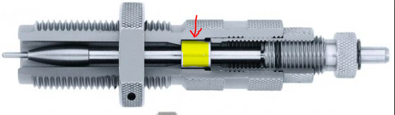

Ok I feel stupid for asking, but what is the bushing for? I bought it, but don't know what it's for.
It goes in the sizer die. Traditional dies have the neck honed out to a certain diameter and thats it. Your hornady match die has the neck sizing area of the die body removed entirely so that you can select a bushing with the diameter of your choosing to go in its place. Traditional full length dies can size the neck down way more than necessary as a means to ensure that it works for every possible combination there is, the bushing allows you to customize that aspect and eliminate that overworking of your brass.
The bushing is shown installed in the die here, shaded yellow with the arrow pointing to it.
