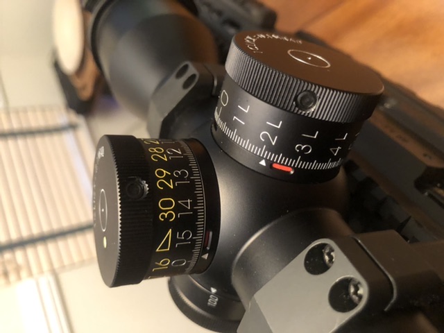

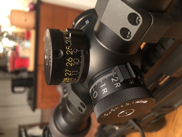

Can someone that’s got a Schmidt Bender PMII with the new DTII+ turret confirm the correct way to set the zero stop? The manual that came with my scope only shows directions for the older locking ring style, and I ran into an issue at the range today that I’m trying to figure out. Here’s what happened:
  1. Zeroed my rifle (AI AX) with the 6mm Creedmoor barrel installed
  2. Locked both turrets by switching the knob to red (locked)
  3. Loosened the two set screws on both turrets , unlocked the turrets, and turned them to zero and then locked the turrets (switch to ‘red’ position)
  4. Retightened the screws on both turrets and assumed that everything was good
  5. Switched out to my 6.5 Creedmoor barrel and took my first shot which was was .97 Mil low and 1.3 right of my point of aim (which almost exactly what I dialed back to set the zero stop
I can only assume that I must have done something wrong in the process above and actually dialed an adjustment into the turrets instead of actually resetting the stops.
I ended up rezeroing the gun on the 6.5 barrel but I’m a bit hesitant to try to reset the stops until I can confirm them proper procedure to do so with the PMII+ turrets
Any help is appreciated

Pretty sure that there is 3 set screws, but I dont have my MTC/LT PM2 anymore to confirm.
That is the correct process though. I loved that turret lock to prevent moving while losening the screws.
there’s only two hex screws on these turrets that I can see. The elevation turret has two additional openings but they’re plugged. The windage turret has two hex screws and a plugged opening
Okay.... Here we go. The new turrets should only have 2 screws.
Make sure your screws are tightened...
Rezero turning the elevation and windage knobs to get you corrected on target
Loosen the screws
Turn down to zero... Make sure you turn the turret in the correct direction to get back to zero. Should be clockwise.
Tighten screws
Verify zero...
You should have roughly 24 mils of up travel assuming a normal 6.5 cm load with a 30 moa rail
PM me if you still don't get through it
Reactions: carbonbased
Loosen the screws
Tighten screws
Verify zero...
Thanks - just to make sure I understand, your saying don’t flip the switches to red/lock before loosening the screws, just loosen them, turn the turret to zero, and then lock the screws down again
No need to lock the turrets and don't remove the screws from the turret just loosen them 2-3 turns.
The turret will still click with the screws loosened don't worry about it that's normal. Loosen them then turn down to zero.
