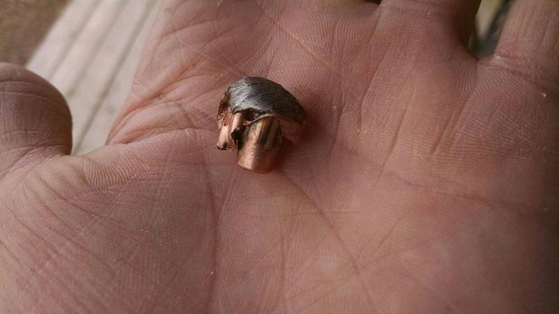

ya the 178's eld-x's work good out .308 win . . heavy hide bone should be no problem . my brother's daughter just dug one out a small 6'+ Bear few days ago . I will get it and weigh it/with a Pic. of bullet . Also the accubonds are top notch. for great penetration heavy bone and still retains good amount of bullet weight .
I loaded up the last .308win. loads with 155 Scenars last few years and they were doing good on lighter-weight hide and bone for Deer and Antelope . But the Scenars on the last two Elk were a little shitty on bullet integrity. They was dropping the Elk-doa but A lot of copper jacket recovered and no Lead . So (imho) the not good choice for the heavier hide/bone game .
178 ELD-x . .308 Win. ( 325 yard hit ) . ( size 6 ft.+) black bear, Hit threw front shoulder, straight threw and hung-up opposite side under the hide .
post-hit total weight ( 133.2 )
Reactions: shooter65
