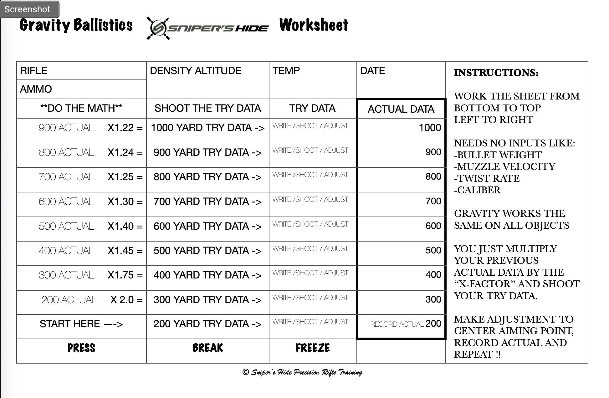

Use Gravity Ballistics
The Calculators have to be trued, they will not work out of the box the way you envision. They are not just drop in the numbers and go.
Dope the rifle with Gravity Ballistics then true the calculator with the numbers from GB
Start at 200 or 300, either 2 MOA or .5 Mils at 200
Understand too, your Q Fix has a super short barrel, the numbers will be much different because you have no velocity
So nothing is averaged to a 16" barrel, most are averaged to 24" hence your dilemma
Gravity Ballistics will true as you go, work much easier than chasing an App that hates a 16" barrel.

Okay thanks a lot I'll try this. I've been using GeoBallistics and figured that when all the inputs are correct the BC Calculator would get pretty close.
