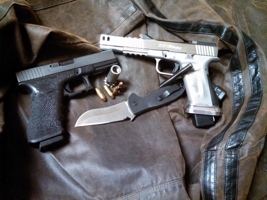

    Always have to change out to a lighter spring on a Glock when using a compensator or suppressor. IMG_20130722_214418_817[1].jpg
