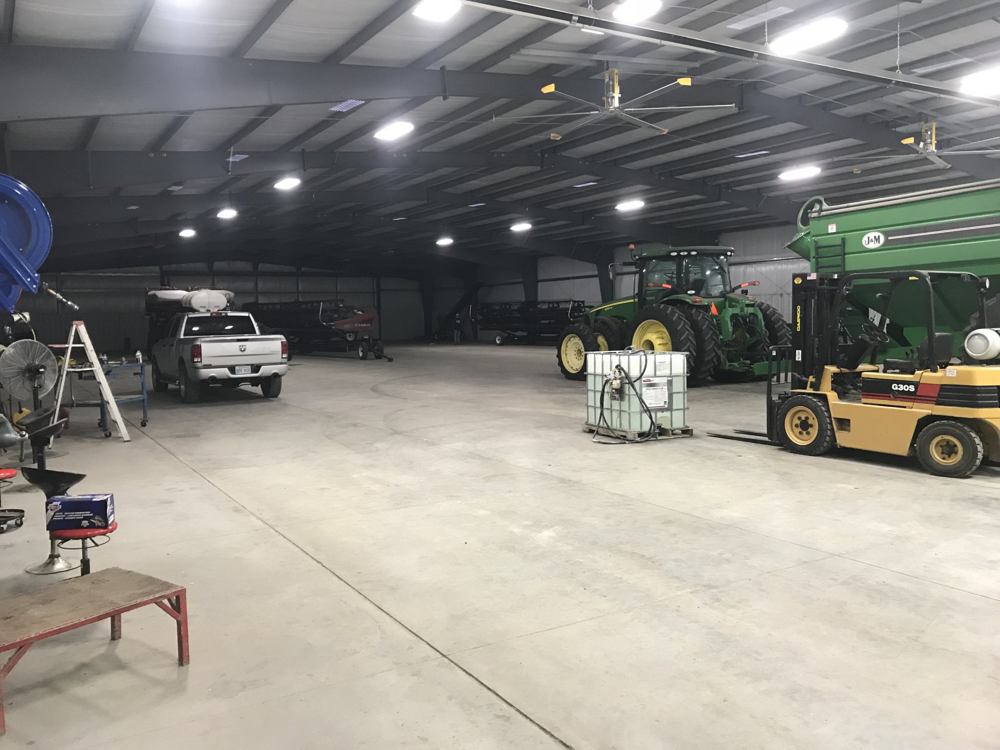

I built my shop 75x50 and am beginning to run out of room. Size DOES matter and bigger IS better.
ETA: also if you pour a slab, you can build dollies for all your implements/attachments and they're much easier to store/hook up if you can simply roll them off in a corner of your not-round shop. And instead of backing up to the implement, you can simply roll the implement up to the tractor.

Whatever you decide on, build it bigger. If you think it’s big enough, go bigger. Nothing sucks more than cramming equipment into every nook and cranny.
This. I built mine not deep enough. Park tractor on ground. Run tape around,it. Or spray marking paint. Put mower deck on back.... Unless you want to take off implements every time you park it.. Cheers, sirhr

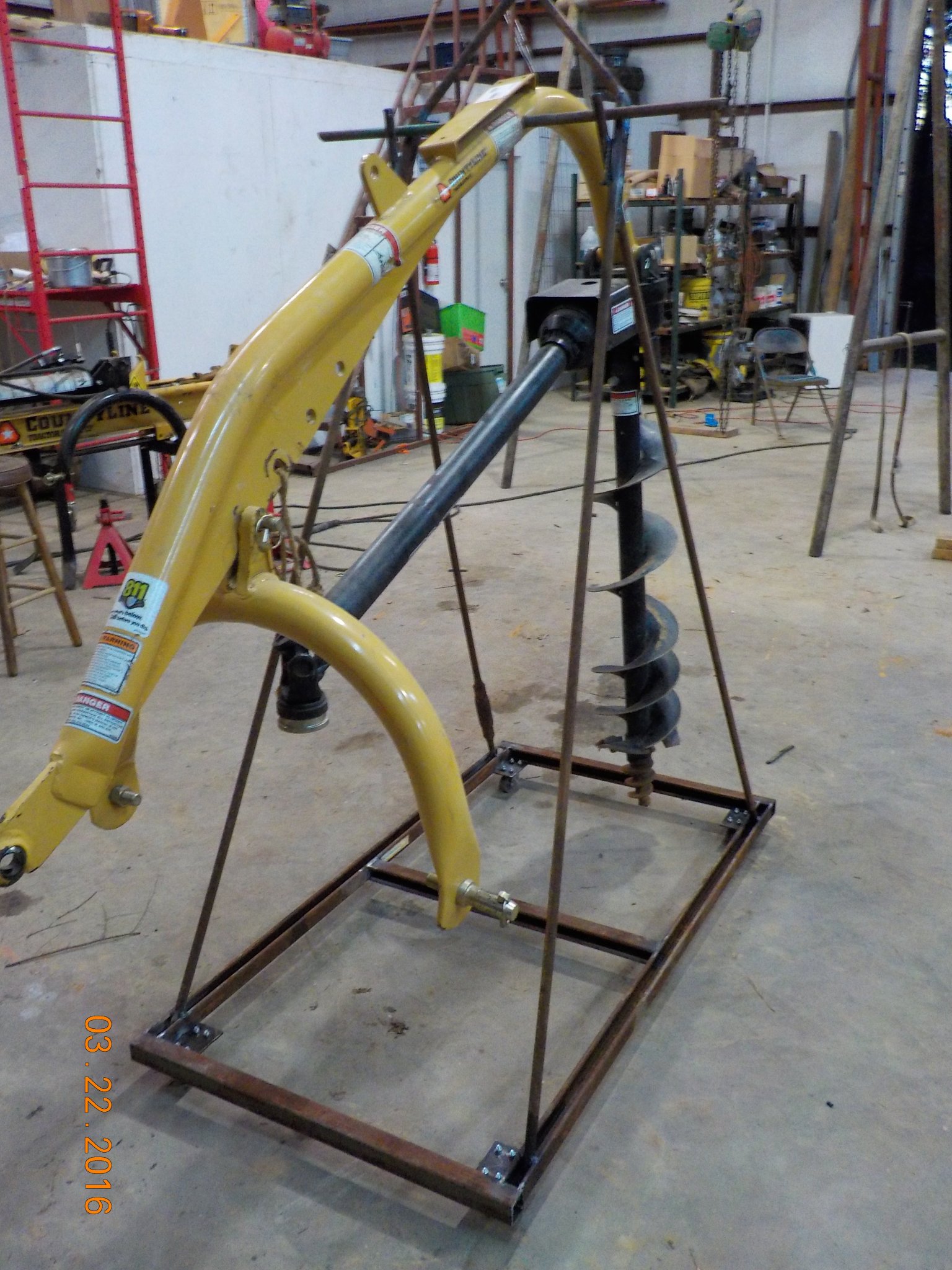

The last time I took mine off I dug it down about 18"" and then took it off. Actually worked pretty good but I like your stand, Not going to concrete this shed at this time.
Reactions: mtrmn

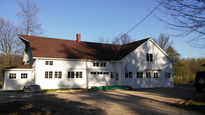

This is a 1940's era barn I'm in the middle of renovating.
My addition is on the right. Who barn is probably about 70x40, it's not a rectangle. Bigger is better. Use scissor trusses for a higher ceiling. Buy the 20' long galvanized plain box rail for smooth door movement. Don't use two pcs for the door rail. If you can do a pull through, with doors on both ends, that would be nicer. Lots of windows, mine was dark inside when I bought it. Windows are inexpensive, about $150 each, and make seeing things a lot easier.
