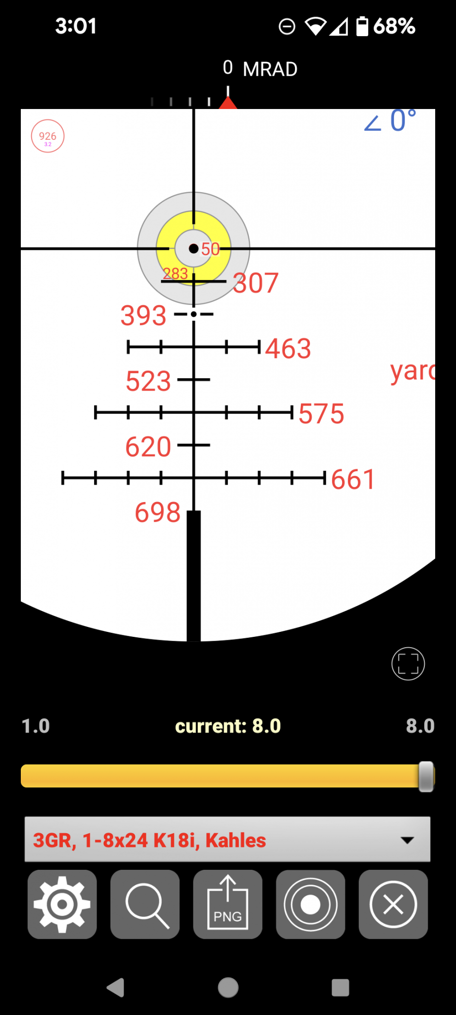

At 1x your next hash mark is impact beyond any practical range of that setup. You will likely never shoot past 100yds and not crank up the magnification. Even at 8x your next hash mark is 250-300 yards away depending on ammo choice. This is for a 60g V-max at 2,750.

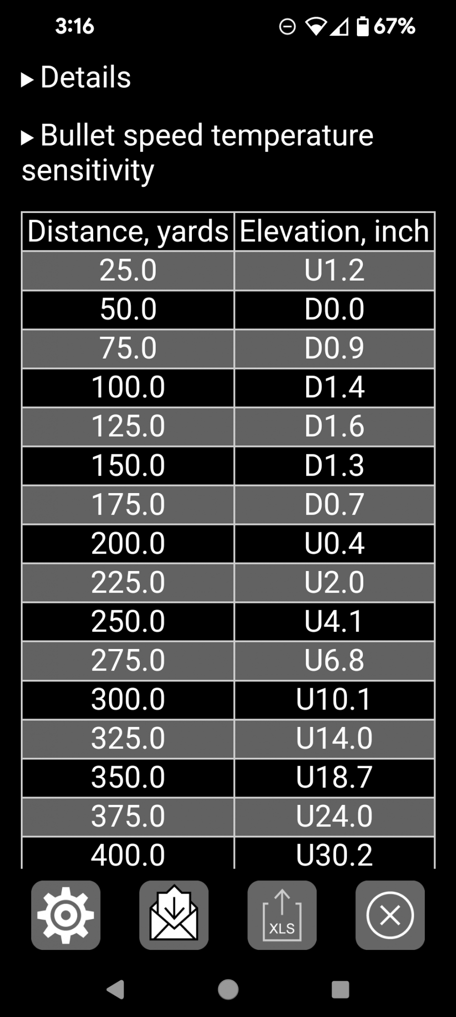

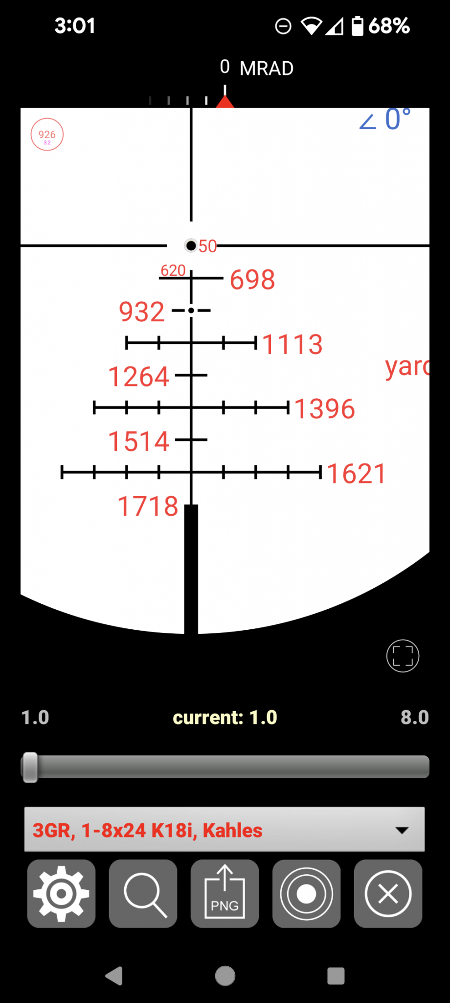

If you really want to be able to visualize this and play around with holds at different magnifications, get the Strelok Pro app. Its the app that is screenshotted above.
