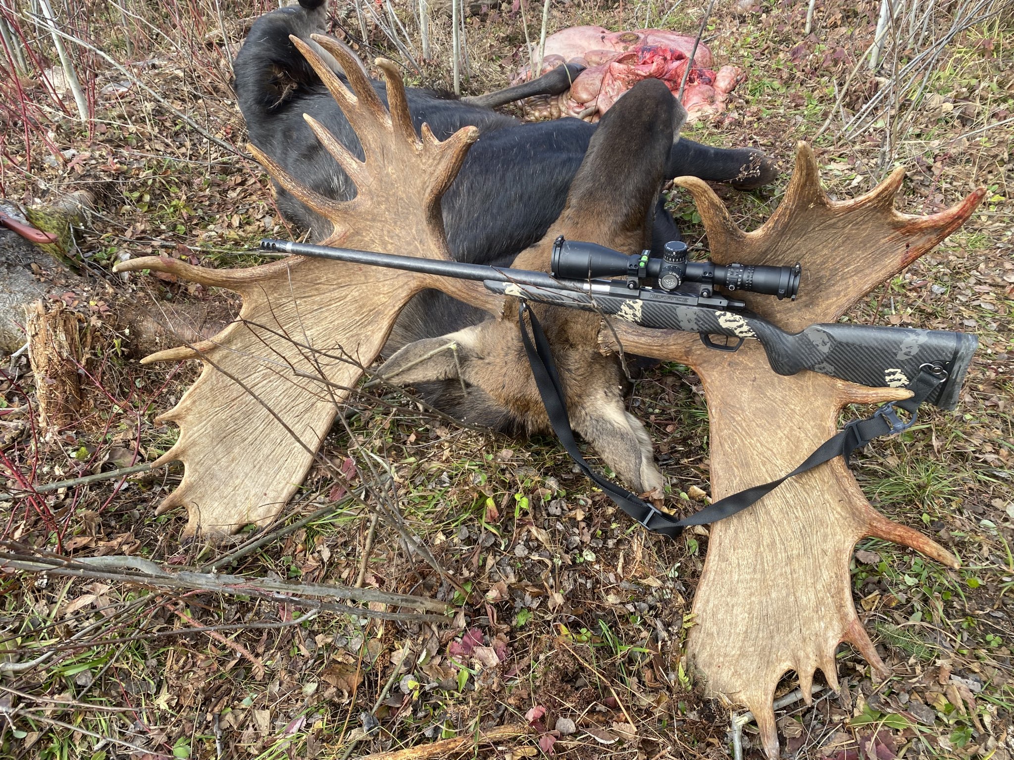

Can you show me a picture of your 4-32 on the rifle? I wonder how it looks being shorter than my NXS.
