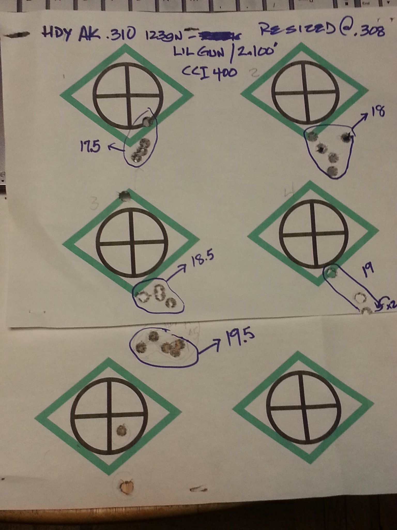

    ...10.1" BA Hanson @100yds....HDY AK VMAX (.310) resized to .308 w/Lee bullet sizer, cross lines within the circle are 1-3/4" ...
