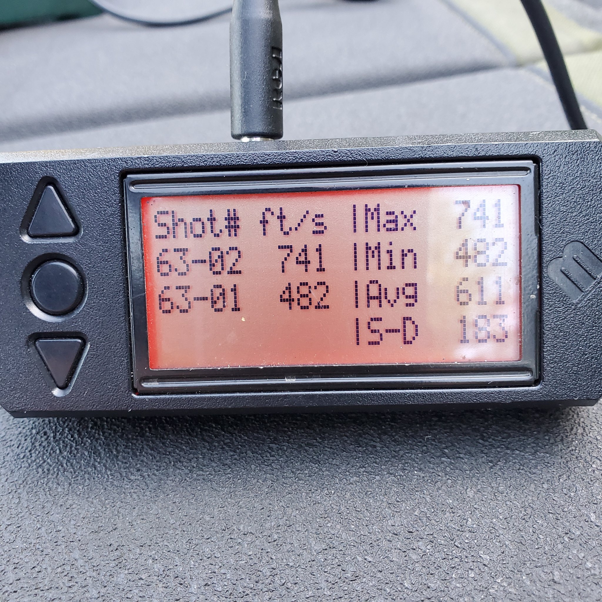

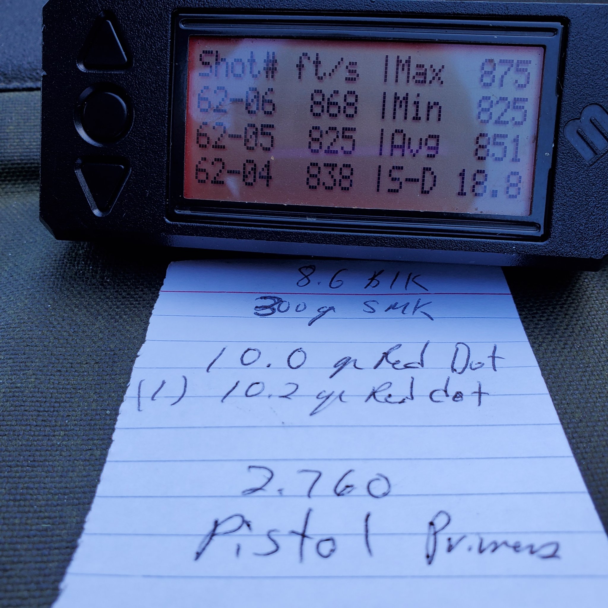

A lot of experimenting with the 8.6. Such as pistol primers. But ran into trouble with one powder ...the velocity dropped from 741 to 482 fps on a pistol primers...creating a situation...does the bullet make it out the barrel on the next shot.
At these low velocities the 300 SMK is quiet and accurate in the 6.5 twist.

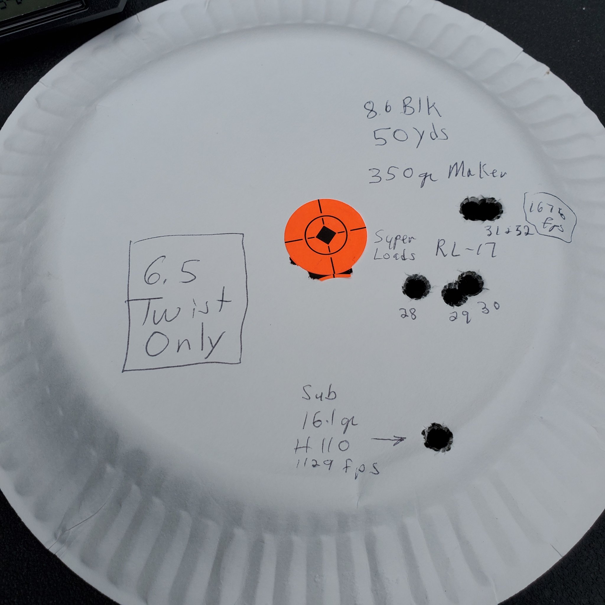

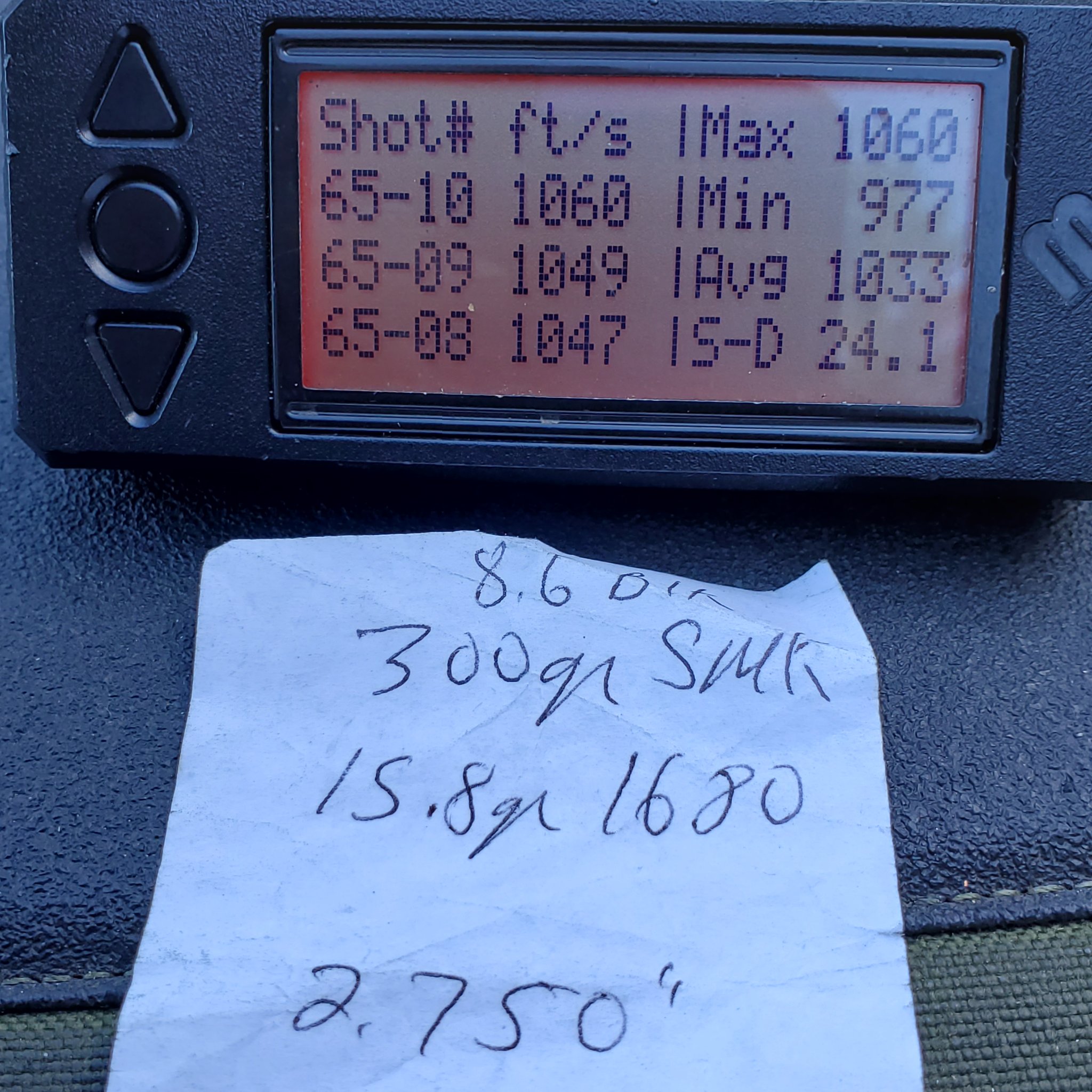

And finally a 50 test with the expensive 350 gr Maker bullets, many could not get them to shoot accurately, just change to the 6.5 twist no trouble their sub recommended load is spot on...but I can run it supersonic with no problems of bullet fragmenting in flight or inside the muzzle device...and the bullets cluster together as the powder charge jumps 1 gr at a time, with each shot.
Well that's my experience with the 8.6 Blackout, run the limiting 3 twist if ya want, but so a much better option is the 6.5 twist..in my experience.

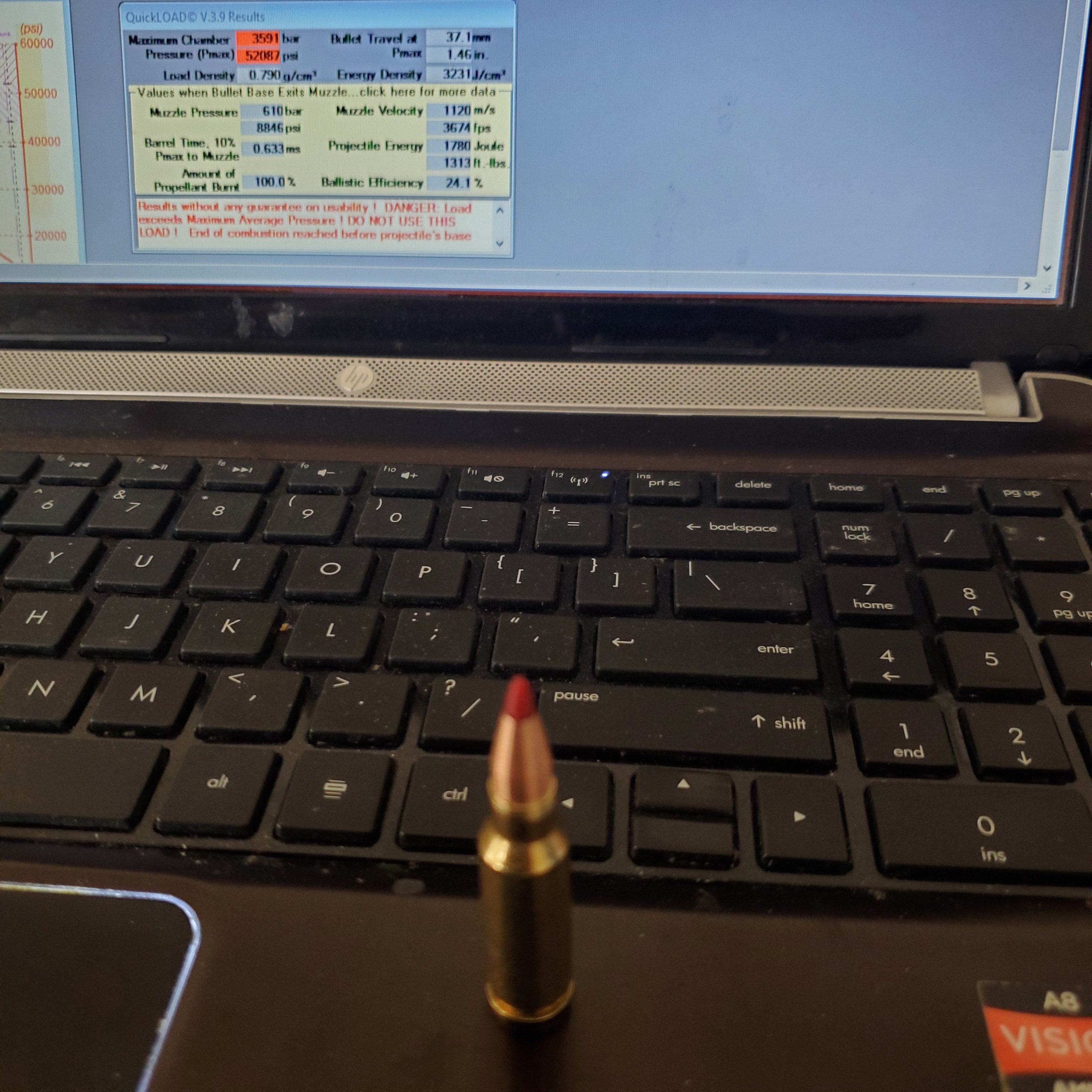

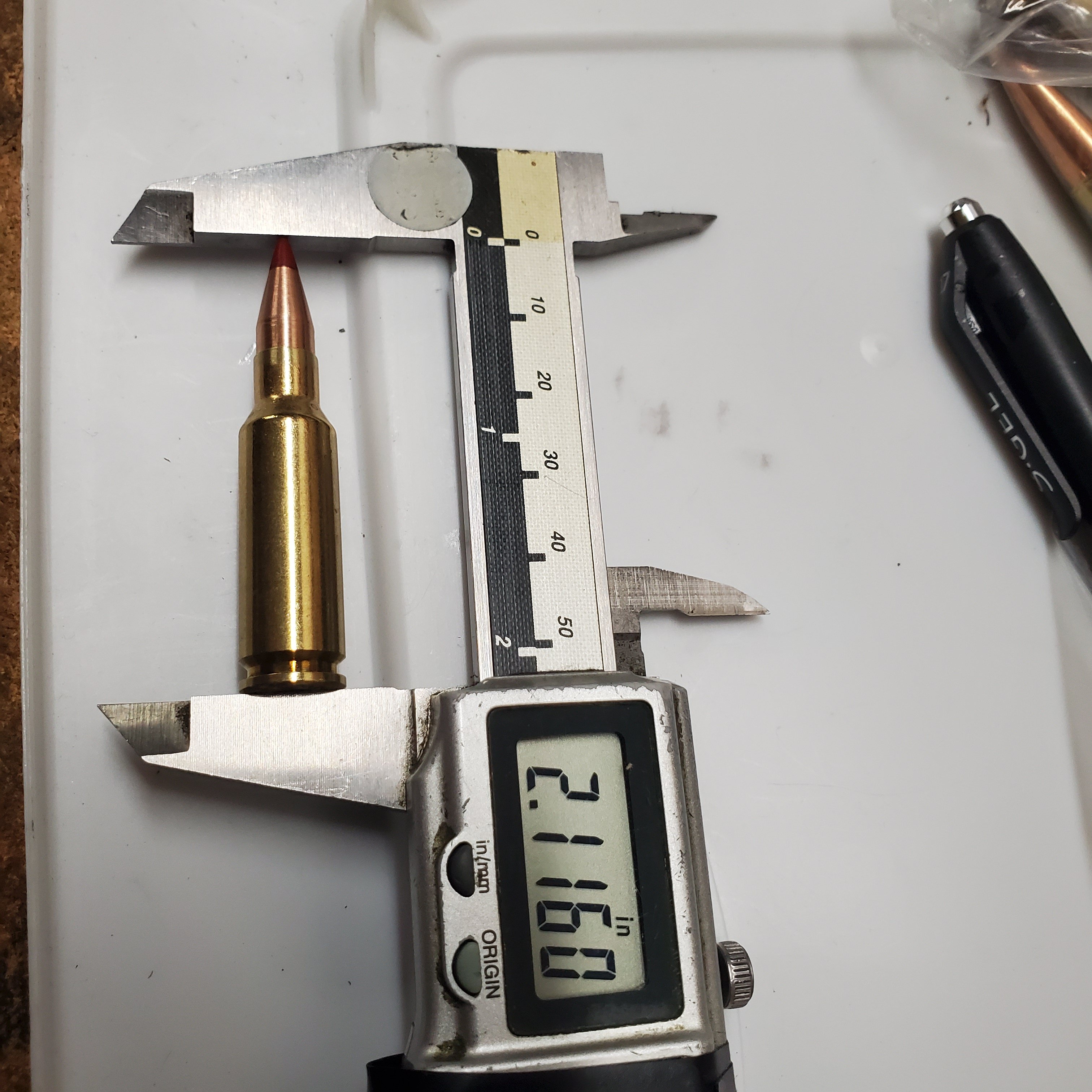

Okay, only interested in a high velocity grendel...only way to get there in an AR is reduce bullet weight...

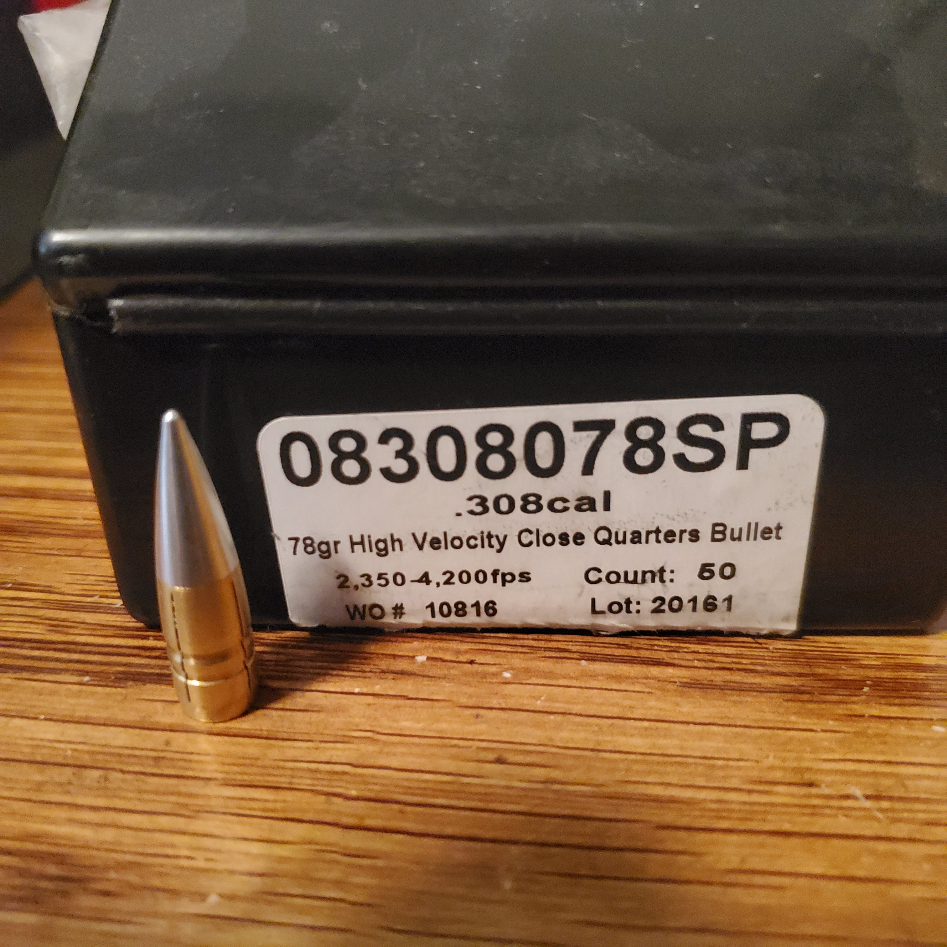

Here is an example 78 gr bullet for 300 blk 2700 fps...cut down to .264" it'd probably get close to your desired velocity in the Grendel.
They used to make these CQB bullets, but if they don't sell well they quit making them.
I make my own on a lathe...or cut down copper bullets to a certain weight, hollow point them, cut boattail, etc. To try to get the velocity you desire.
But most have to rely on industry to make their bullets...so you'll have to check around to see if something in the 60 gr area is available in 6.5.

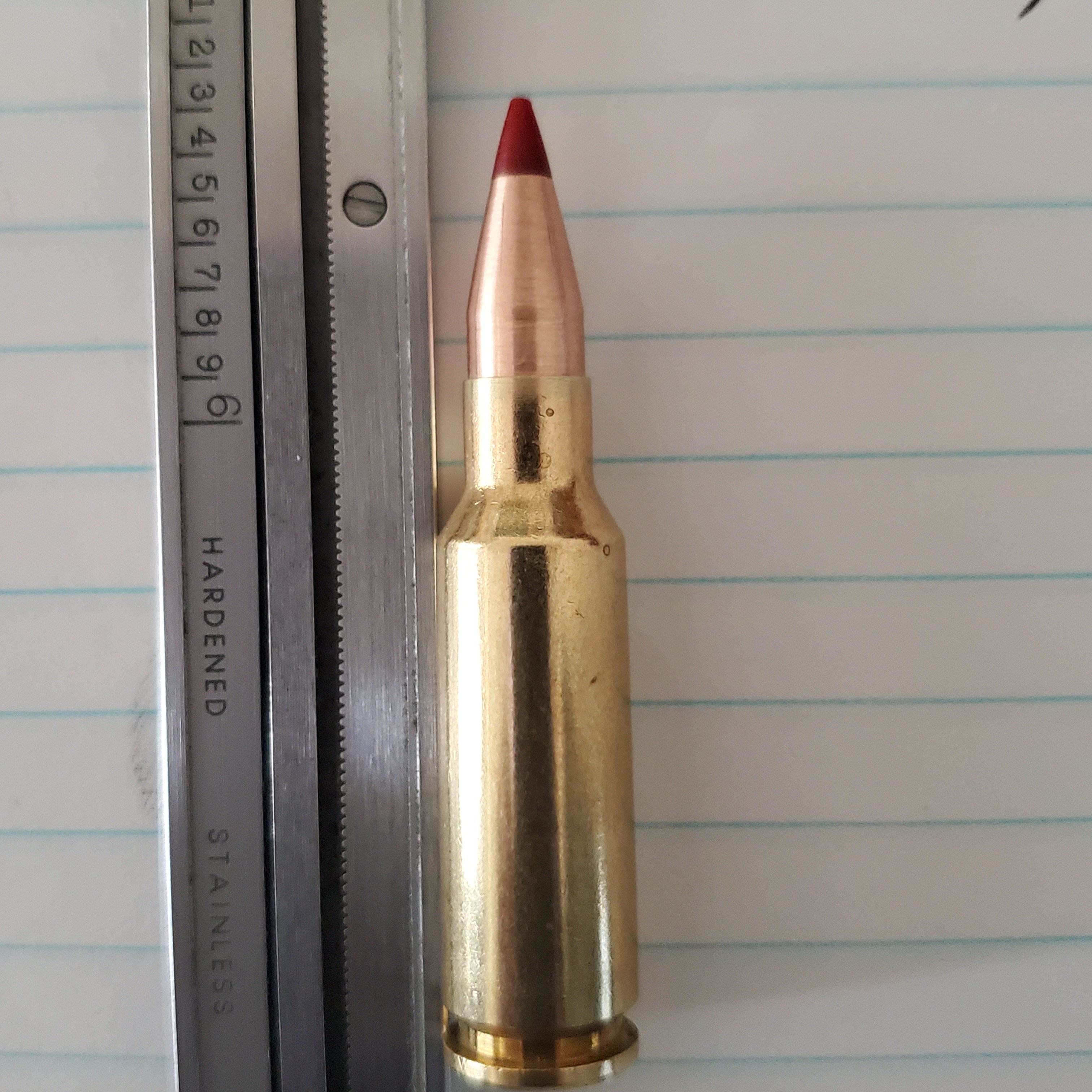

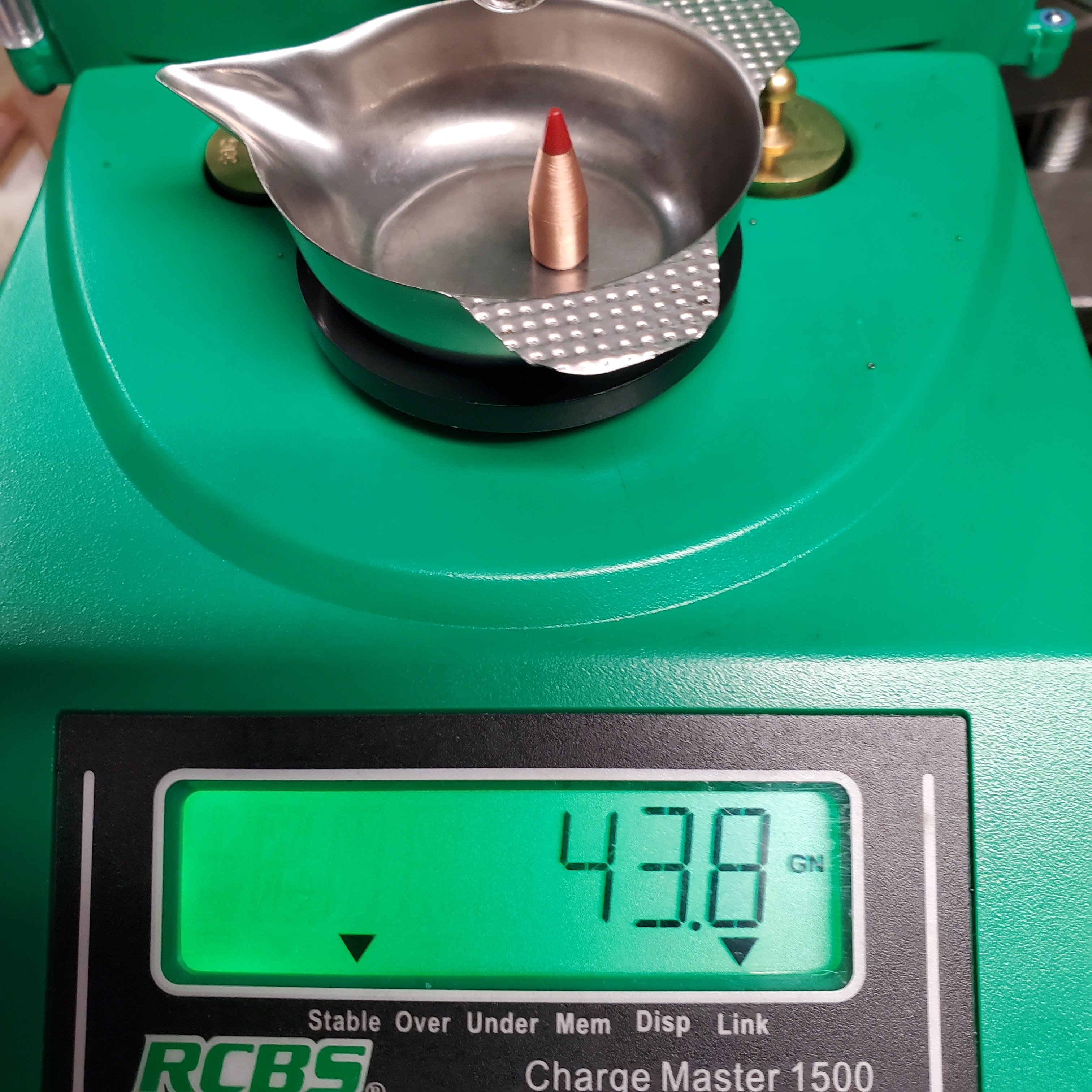

So here ya go 12" Grendel high velocity load...do it yourself. Only takes a half hr to make the bullet and develop the load.
Machined 43.8 gr Hornady copper 338 bullet down to .264" cut to .758" long.
Leave the plastic tip of the hollow point on they are lighter than copper.
COAL 2.116" WIN 296 AND LILGUN are the powders.
12" Grendel = 3395 fps with W 296.
12" Grendel = 3412 fps with LilGun.
16" Grendel = 3681 fps with W296
16" Grendel =3684 fps with Lil Gun.
You definitely lose velocity in a short barrel.
But here ya go... do it yourself if no one makes what you want.
The 10" = 3210 VS 3684 for the 16" and the powder is not being consumed 100% now, as it was in the 16".
