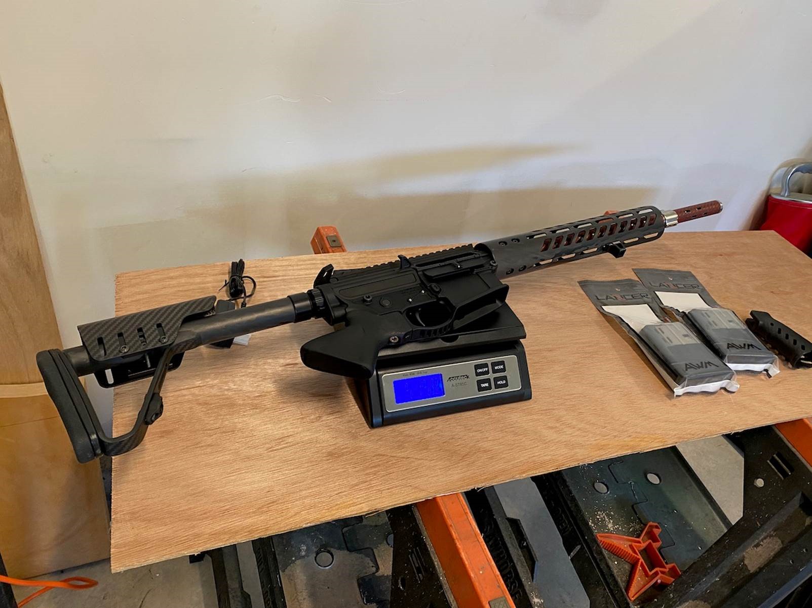

I have an 18" fluted carbon-wrapped barrel from BSF that I wanna put a muzzle brake on but want someone who has done this before. BSF is quite specific about the manner in which this is done (as shown at https://94fbfb53-6b6e-4f62-acab-29f...d/5e8dd2_9d1a7e4d524d4e558410ebdc31139632.pdf) but I don't want my rifle to be part of a gunsmith's learning curve.
Need someone with experience. Know anybody? Putting it on this rifle.

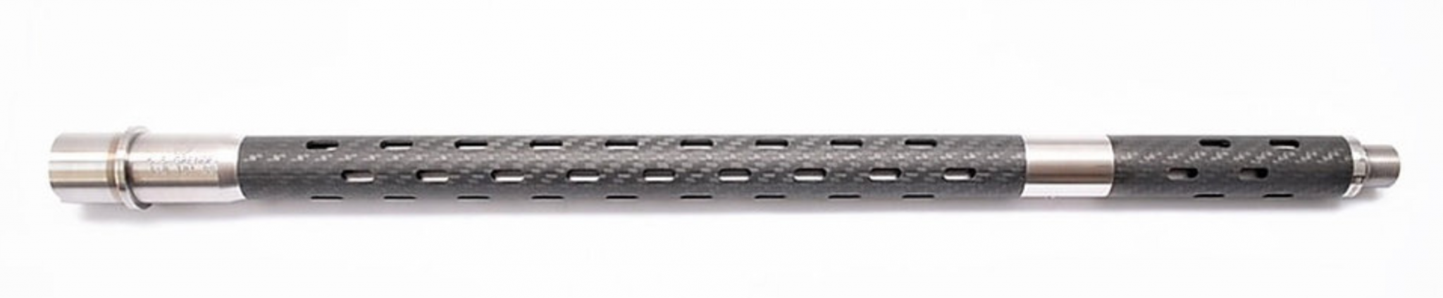

Presumably, that shiny metal piece on the end of the barrel is what is giving tension to the carbon fiber, and is held in place by threading on the barrel. I do not know this, but that is my assumption. Being able to see the end of the barrel might give some additional insight. It would be trivial to add a muzzle brake to this barrel. I am assuming that the threading on this barrel is what holds that carbon fiber wrap tensioner thing on place.
Presumably, that shiny metal piece on the end of the barrel is what is giving tension to the carbon fiber, and is held in place by threading on the barrel. I do not know this, but that is my assumption. Being able to see the end of the barrel might give some additional insight. It would be trivial to add a muzzle brake to this barrel. I am assuming that the threading on this barrel is what holds that carbon fiber wrap tensioner thing on place. View attachment 7667578
EDIT: Found a video of how they make the BSF barrels - they're not bonded. You are correct, you could shorten the carbon, rethread, and recap the end to restore tension (the carbon is under compression, the steel tension. Not generally how carbon tubes are loaded).
I still stand by the assessment it would be a better idea to replace with a barrel that matches the desired config from the manufacturer, but it is not outside the realm of possible.

Be better off to just swap to a barrel like this, vs trying to machine a square peg into a round hole.
