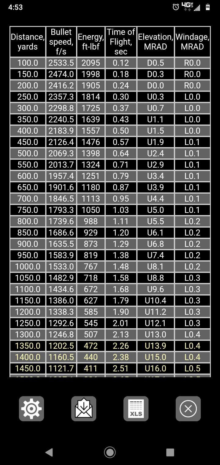

Using that configuration, I can get 17 MILS or over 57 MOA extra elevation from zero. I'm letting you know this as it takes a little over 10 mils or almost 34 MOA to get to 1,000 yards.
Without the extra elevation that the base can provide you might be mid range on the turret travel when you are zeroed in with the rifle.
According to Vortex the maximum elevation travel for the 3-15X is 75 MOA and it;s less for the 5-25X at 70 MOA.
As you can see, if you didn't have a 20 MOA base, you may be close on maximum elevation adjustment or run out of travel trying to hit something at 1,000 yards.

Dope card and ballistic calculators. A simple sheet of how much drop per 50 yards taped to the stock saves a lot of math.
Strelok pro for example:
This applies to either system. Just don't get caught up in "using moa because it's inches" because it's really not and there are several variations on moa.
