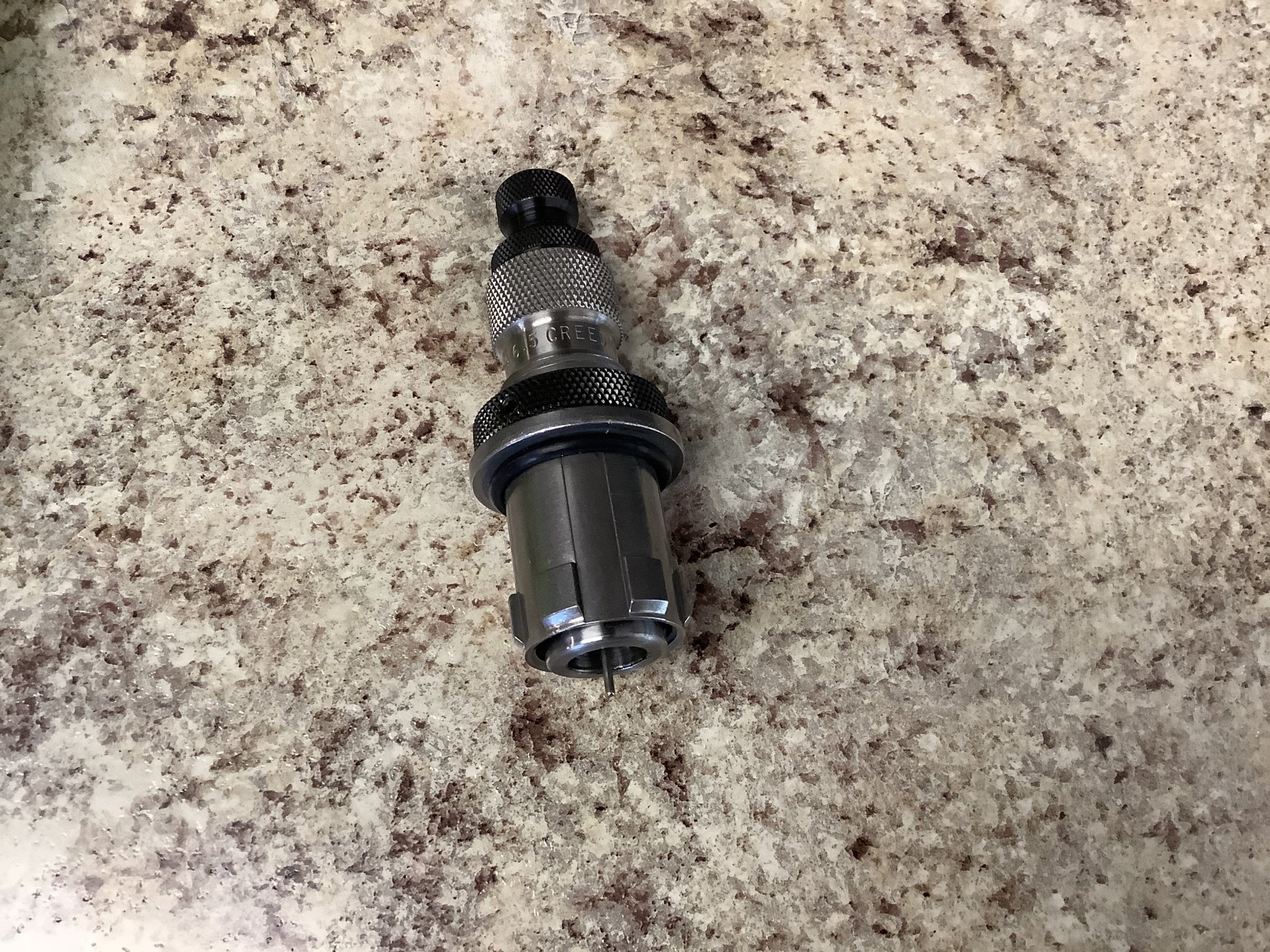

Be forewarned, I am a bit obtuse when it comes to trying to explain something via text. (I am a visual thinker) So, I might be asking a few follow up questions so I can grasp my head around it.
My layout;
RCBS Rockchucker Single Press
RCBS Scale w/Powder Dispenser (hand powered)
Redding full size die w/.289 bushing, and Redding Micrometer seating die.
6.5 CM, Lapua Brass w/ Berger 140g Hybrid Target ammo.
A common theme I keep running into with the dies, is when I screw them into the press, I feel like I am starting from scratch on adjusting it to the right height. The locking ring tends to get stuck when I try and take it out, and I need to loosen it so I can get the die unscrewed.
This is more apparent in the seating die, as I am concerned with pushing the bullet too far into the brass, and not being able to adjust it anymore.
The powder I have 0 problems with, as well as the priming. It is the die side of things that gets lengthy, especially the seating part as I feel I need to start from scratch every time I put the die back in the press.
Even when I get a good seating height for the round, the next one could be a bit off. I have it is because of the bullets point not being all the same, so when I measure it varies a few thousand from round to round.
Is there any tips around this? Should I look into getting another press where I don't have to remove the die for the two stages of handloading?

1) That ring is what is on the redding dies.
2) Ok, I'll look into that.
3) Problem is I am measuring for the magazine, not the ogive. So, with that said, how do I measure the ogive in relation to the max COAL of the magazine?
Take the pos redding lock ring off, screw the set screw all the way in so that it exposes the lead tip on the inside threads and take that lead crap off. Then it will function like a good lock ring. Just dont go super crazy tightening it onto the die, you dont want to roll the threads, just needs to be snug to hold it in place.
See that black piece at the top? When I start to screw the die out, that piece does with it as if its stuck to it.
I would take a little blue thread locker and put a small dab on black hex piece bushing and then tighten it down with a wrench so that it doesnt spin out easily.
Once you have the large bushing held securely in place and the redding shit ring fixed youll find it works like it should and finger pressure will be adequate when screwing the die in and out.

That’s exactly what I do. Find the ogive that matches your magazine-fitting COAL and then dont worry about measuring every COAL...the bullet tip variance will change a little...the ogive should not. Ogive is what interacts with the rifling and is the thing to make consistent.

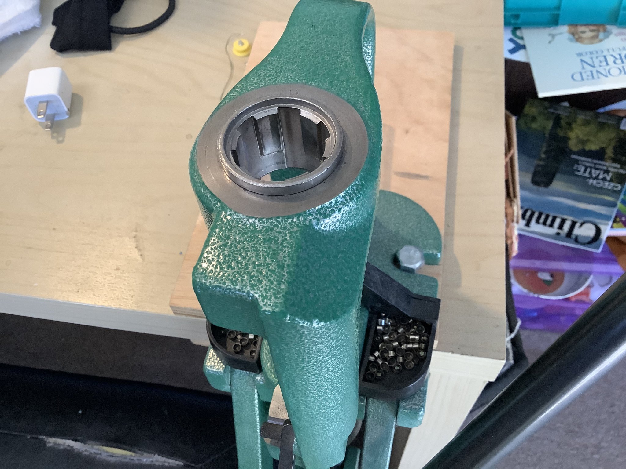

Ok, I have had this problem in the past. Do not tighten your lock ring when it is all the way down in position touching the press. Once you find where you want the die, back of the die and the lock ring simultaneously a hair off the press, tighten your lock ring set screw, and screw back down to touching the press. The ring distorts things and locks onto the press when you tighten the lock ring when it is in contact with the press. Hope all that makes sense. The cause on the set screw types may be the thread pitch causing distortion as the lead engages the tapers of the thread. For split ring, the opposing sides of the ring become less than flat, putting pressure on the press. Once again find your spot, back off die and ring at the same time so as to not be touching the press, tighten lock ring, and screw back down into press until touching.
I don’t remember why I went to the Hornady bushing system but it had something to do with changing calibers and not wanting to deal with the RCBS press insert coming out/having to reseat dies to get what I wanted...I was also really new to reloading when I made the switch so I may have been effing it up. Now I’m use to it and I set a die in a bushing once and rarely touch it again. No real complaints. Looks like this:
Awesome, thank you.
I used the hornady lnl bushing system as well. If you tighten the lock ring when it is in contact with the bushing, the same thing happens. Not a problem if you never move your die, but I have various makers of brass of the same caliber, so I need to change often. If you don’t anneal and don’t have the same maker of brass you will encounter problems. I ditched it PDQ.
I did this earlier and it worked great.
