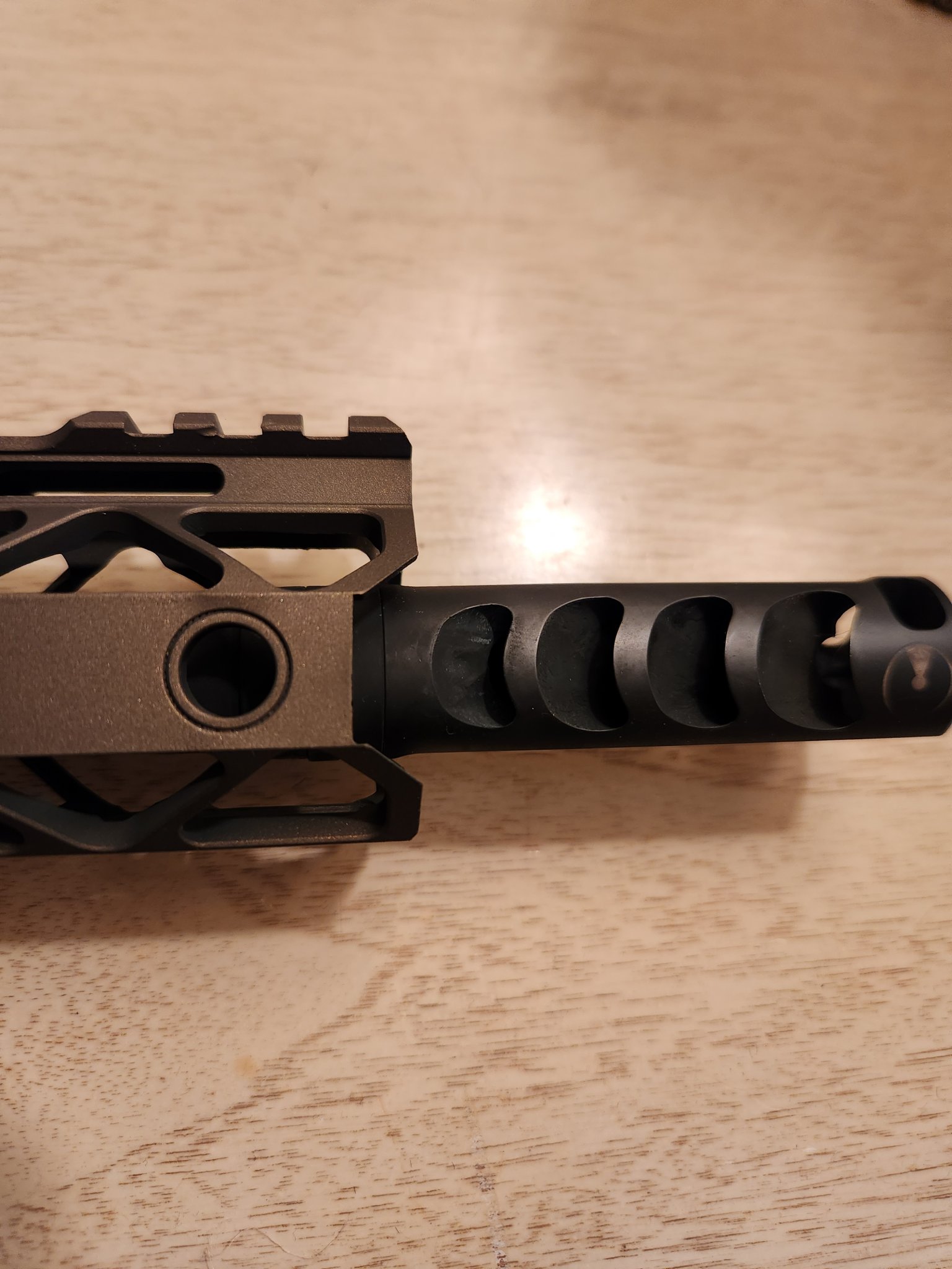

    Hey guys I am swapping out a BA barrel for a Krieger on my MK18 SPR.
    Problem: 16” barrel (it’s the only length I can get my hands on right now for a really good price) and a 16” handguard don’t exactly mix when I am using a plan B mount and cherry bomb on a converted SDN6
    Solution: maybe find a muzzle device that moves the suppressor forward? Or some other type of solution.

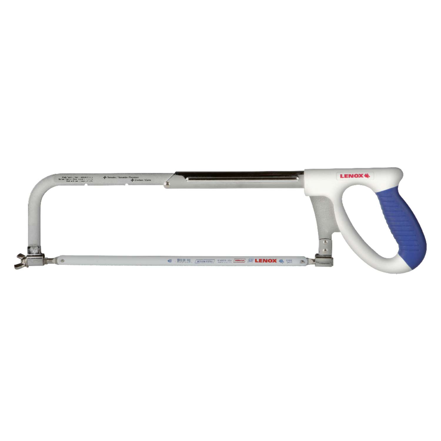

    Your only option is cut the handguard or run a longer barrel. I would do the former. I think 16" barrels are the sweet spot of do it all. Find a guy with a local mill, or use the hacksaw and carefully file after. Spray it black or even better rattle can the gun.
    Kaw Valley Precision makes barrel extenders, as well as other mfg's. 3/4", 1" and 1-1/4" are common. Don't know how precise they would be for suppressor alignment.
    I was half joking when I quoted the hacksaw picture. A regular old miter saw with a wood blade will happily cut a handguard. I've cut a ton of aluminum with mine, you've just gotta have a solid hold of the aluminum so it doesn't catch and make a mess of things.

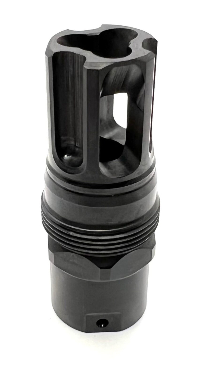

    Another option would be the LPM pin annd weld eclipse flashhider. It is a plan b mount and has extended threads on the back to make it longer without making go further into the can.
