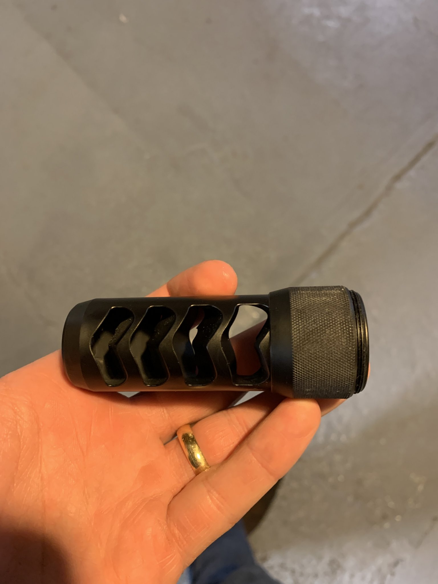

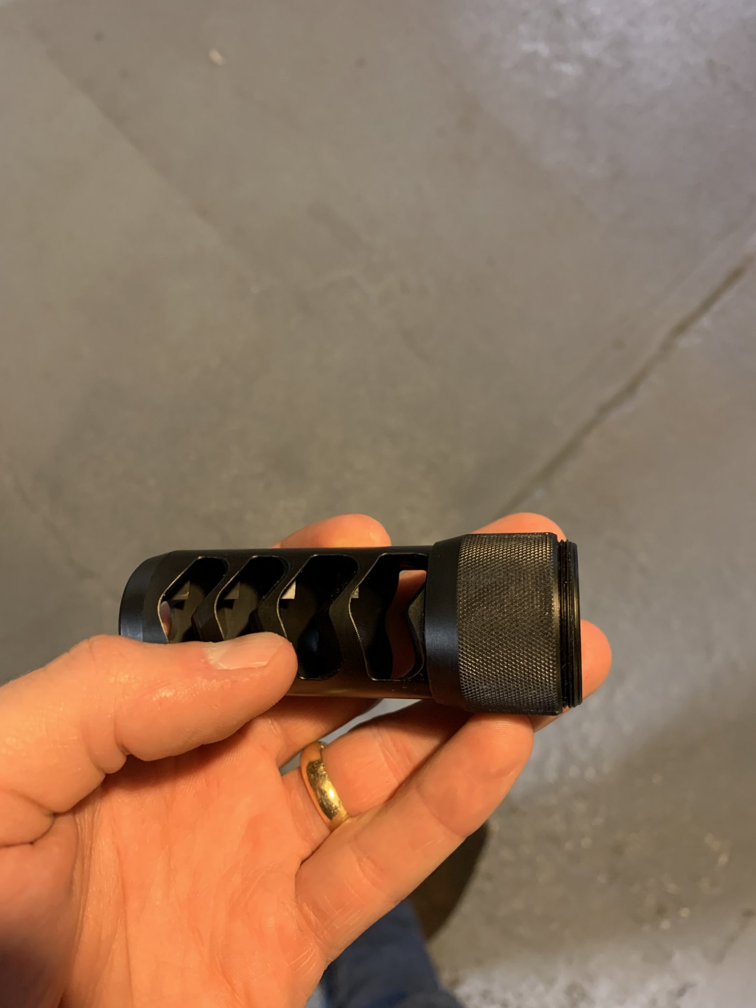

I picked this brake up on a rifle off of here. Unbeknownst to me, the brake is locked onto the adapter.
move tried strap wrench, on blaster, etc. any other suggestions? It looks like it’s almost free. Maybe soak in CLR to see if it’s carbon gumming it up?
I can’t move the locking collar either way. When I first got it, no threads on the adapter were showing, so I’ve moved it some. Threads don’t appear to be galled/crossthreaded

Screwing the knurled portion clockwise frees it. Therefore if you screw the whole mess
Onto a muzzle, it should come right off, because you’ll be simultaneously tightening the universal adapter onto the muzzle thread, and forcing the brake off the adapter.
I agree, but no such luck here. I was cranking on it both with strap wrench, vice grips, screw driver I stick in the port.
No CLR. Per 419 it will turn your brake pink.

In my experience (and that of those in my shooting circle), these A419 brakes are pretty prone to this problem.
My guess is the threads are pretty fine with little clearance, and as such don't tolerate debris such as carbon well.

Due to the tapers, carbon cannot reach the threads. Only thread on the brake are exposed in the OP’s pic. Note how clean they are.
Knurling ring won’t move either direction
may have to try boiling.

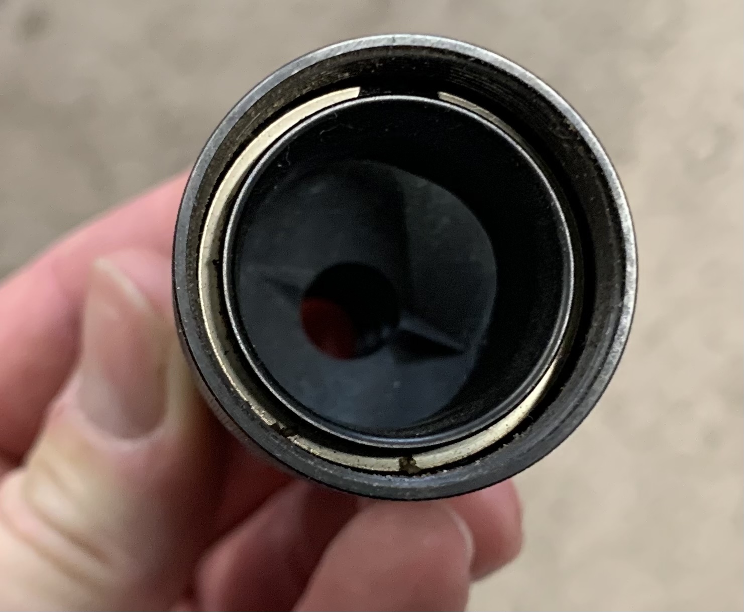

Something is way wrong. Id send it to 419. This is not a carbon issue. That knurled ring is only retained by a spring clip to the brake. The clip is the only thing i can imagine that is stopping it. Its out of it’s groove which bound the ring. Here’s a sidewinder.

Looking at the 2nd and 3rd pic, I'm guessing the lock ring is cross threaded onto the adapter. There are 3-4 threads showing. I have two and can barely see 1 thread on mine when they are tight. Instead of beating the crap out of it, I would send it to Area 419 and have them look at it. Hopefully the brake hasn't been damaged and you only have to replace the adapter. OR, you can send it to me and I'll dispose of it properly for you. ;)

I’m fairly sure that he said that he got it moving just a bit and then no further and that’s why threads are showing.
That’s as far off as he could get it.

Have. You tried heading out up with a small torch?
Had the same issue with a PX buy Sidewinder. Area419 gave me guidance, with my gorilla hands it finally popped free. Hope you get it worked out.
Sent the brake off to area 419 about a week and a half ago and a new brake was at my door today. Apparently it wasn’t only me that couldnt get it undone. I’m going to reach out to see if I can get a root cause from them but I’m atleast glad it wasn’t easy for them to get off.
Either way, hats off to Area 419 for just straight up replacing it! Awesome company to work with.

I dont know how often you clean, but take the brake off now and again. Clean the tapers, dry them completely, and reinstall. You should have no issues with sticking. No tools needed either.
