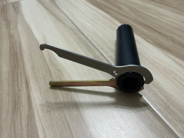

The YHM can should have come with a set of spanner wrenches, and both the can and the phantom mount have indexes for these wrenches. You can buy a steel spanner wrench from YHM. The brass/bronze wrenches they ship are soft and will eventually bend break (ask me how I know). I usually index the wrenches on the can/mount with everything lying on the floor, such that the floor is applying opening pressure to one wrench. Then I tap on the other wrench with a rubber mallet until it all pops free. Works every time.
The nomad also uses a spanner wrench. Same trick… I’ll try to create an image if you’re not getting what I’m writing…
This is the wrong wrench for the mount (I sheared the lug on my other brass spanner), but taps/hits downward on the silver colored wrench will break the mount free…
Yeah I may try that once i get a decent spanner wrench. The one that came with the Nomad just isn't rigid enough to do it , but I ordered one from the guys posted ITT with that vise block thing so hopefully that will do the trick. I will remember about setting them up on the floor though

If you soak it in carbon remover and use the proper tools as I previously suggested you wouldn’t be having this problem. You’re given spanner wrench notches but you’re dicking around with trying to use strap wrench’s and by the looks of it pliers too. Just buy the right tools.
I did buy the right tool. The spanner wrench that came with the can sucks. Also, the new mount does have a taper in front of the threads, so yes it should make a difference, that's the idea anyway. What other proper tools did you suggest? I haven't had a chance to soak it yet, I'm closing a house so it's another long day today but I will try soaking it. I have to have a spanner that won't just bend on me to do anything else.
You can buy better spanner wrenches, I doubt what DA is selling is very good stuff. Harbor freight chinesium is going to be a step up. I would soak it first for several hours and let the solvent penetrate and try again with what you’ve got. Being carbon locked can easily double (or more) the effort required to remove it. If that doesn’t work buy better spanner wrenches.

I guess you've missed a few post ITT but I already have a quality spanner wrench as well as a vise block made for the Nomad suppressor coming and will be here Saturday. I would prefer to have the right tools no matter if I did get it off before then. That outfit dude posted earlier ITT is pretty cool and makes suppressor tools for the specific model of can.

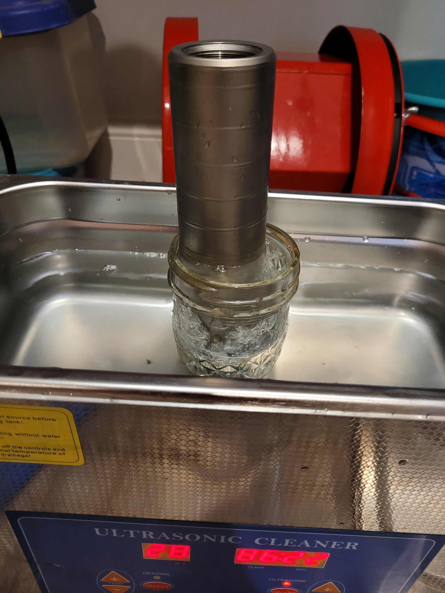

I have it in the ultra sonic now with hoppes inside the suppressor and plastic around the end tight with rubber bands to make it water tight.

Well I'll be..... you were right man. I ran it in my ultrasonic cleaner as shown above for 3 cycles of 90 min with heat.
I just took it out and poured out the hoppes. I put the mount in the vise and turned the can with my hands and got it to move, then was able to unscrew it. Thank you! I'm still glad to have the correct Nomad tools coming since I have 3 of them, but I'm very happy to have that mount out of my can!!!

The ultrasonic works really well to get that stubborn carbon out. I usually have to run many cycles with heat. I just use water in the tank then the can inside of a jar or bag or Pyrex dish ect , which is filled with water around the suppressor then whatever you choose to use as a cleaner inside the can. Hoppes with the ultrasonic works pretty good but CLR works a ton better IF that's an option for your can. If not then simple green works good too.

Yeah I poured hoppes in it and put it in the ultrasonic and got it at the suggestion of a few members. It worked
