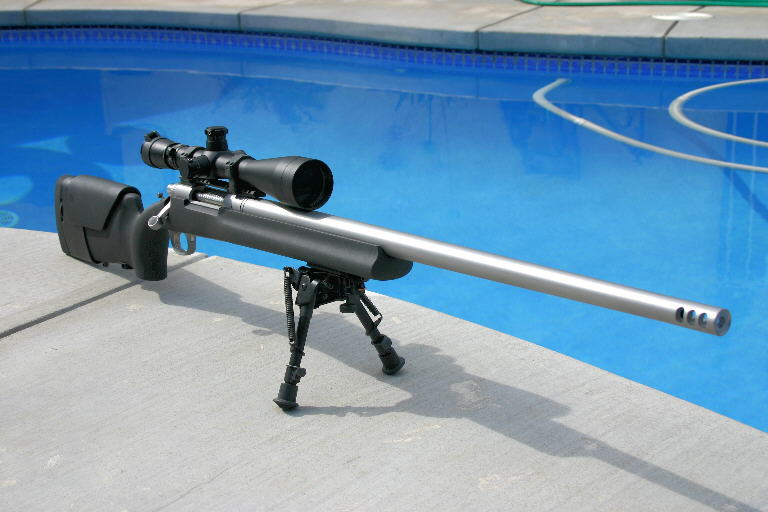

When I built my rifle there weren't any ready to use magazines at least that I was aware of. It too is a .338 RUM I had built on a stainless action. Here is what Randy Cain at R&D Precision assembled for me.

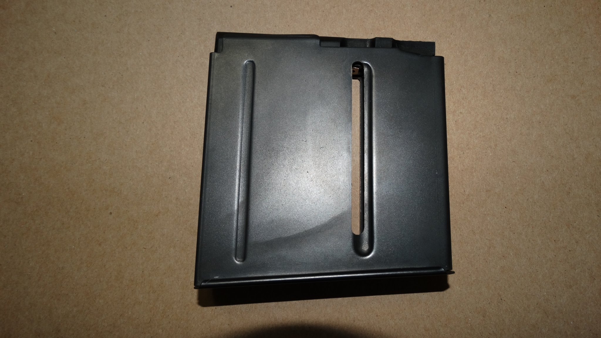

Now this is with factory bottom metal, It actually got dropped into an AICS stock when I could afford it. The problem was the .338 RUM rounds would not fit in the .338 Lapua magazines. The problem was shoulder hit the front rib of the magazine. I had to have the magazines milled. This is what was done:
Once that was done it worked like a charm. The RUM shoulder just sits further forward than the Lapua.
You may have also noticed the muzzle brake. It's a Badger Thruster and believe me it makes the rifle SO MUCH better to shoot. Between the weight of the rifle and the brake it doesn't recoil any harder than a .308 or maybe a .30-06 and that is with the 300 grain Sierra's.
I can't help with much more because I didn't have a barrel nut to contend with but I felt you might need to know about the magazine issue.

B y r o n, I've read about nodding the front rib off of 338LM aics mags. If I would end up with going that route it would definitely be an option. I would have to come up with some kind of way of plugging the split. Do they feed good out of the modded 338LM mags?
. . . B y r o n, I've read about nodding the front rib off of 338LM aics mags. If I would end up with going that route it would definitely be an option. I would have to come up with some kind of way of plugging the split. Do they feed good out of the modded 338LM mags?
There is no need to plug up the milled area. The shoulder of the RUM case rides right up at the front edge of the milled slot. It does have a small clearance but don't remember the exact amount. The rounds feed flawlessly from the mags I had modified.
I was able to get an 0.008" shim between the cutout and the shoulder on both sides at the same time.
