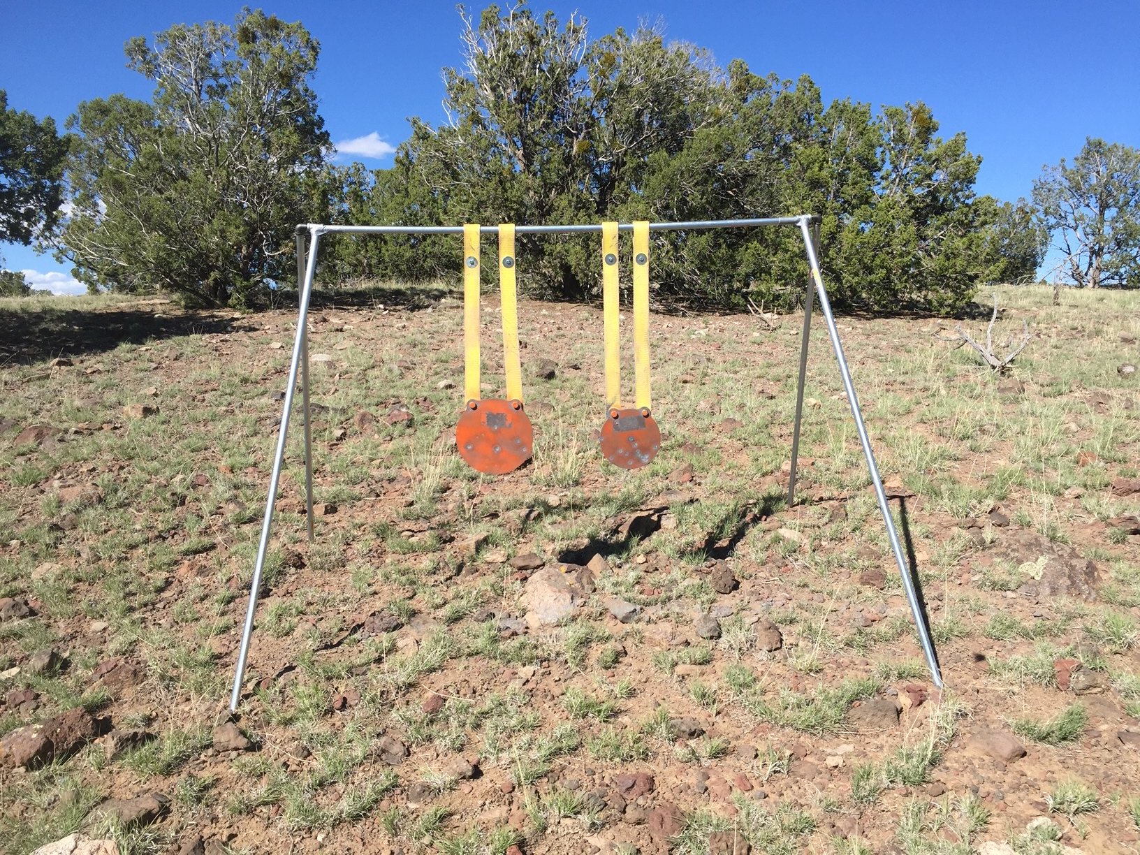

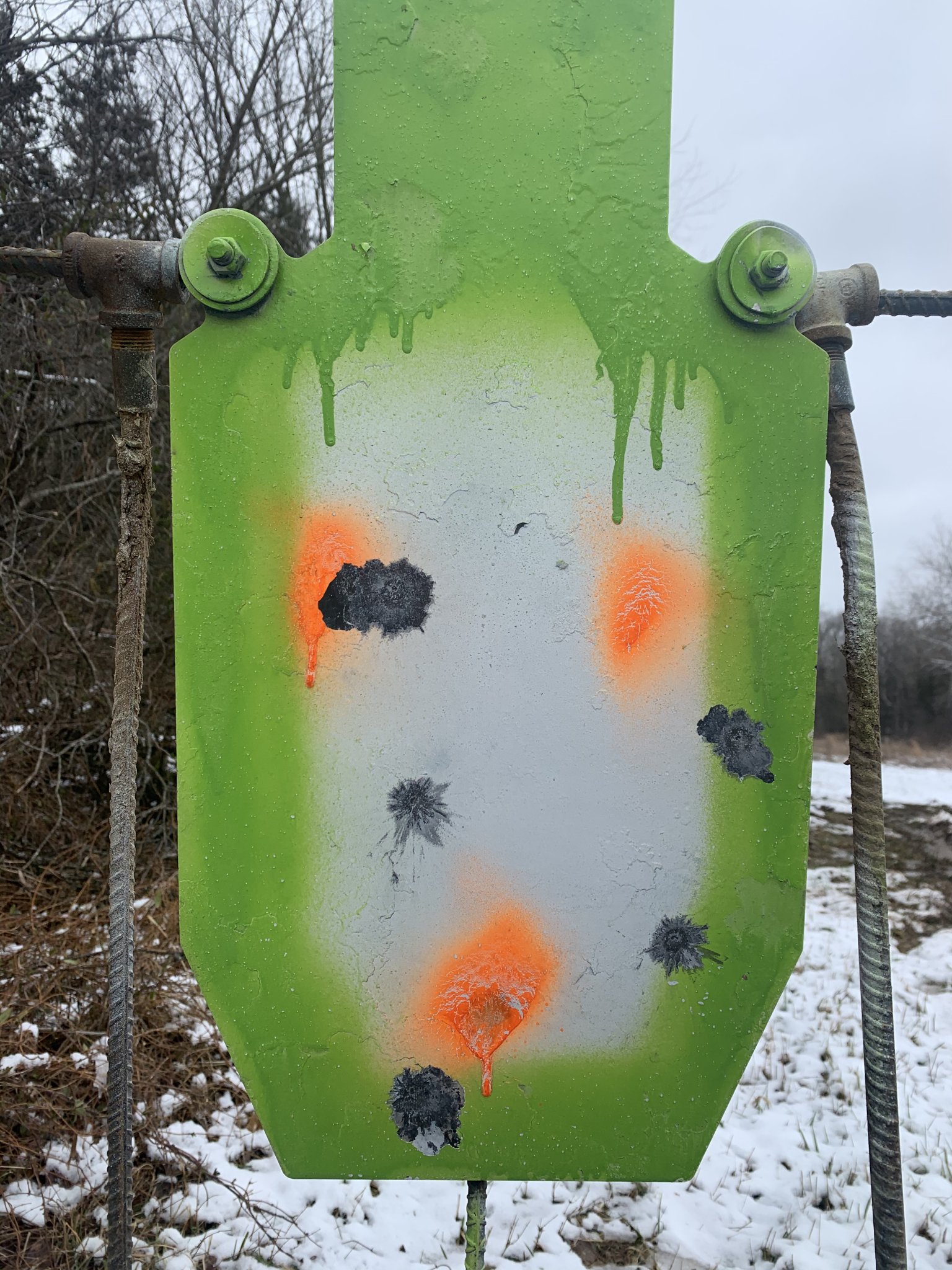

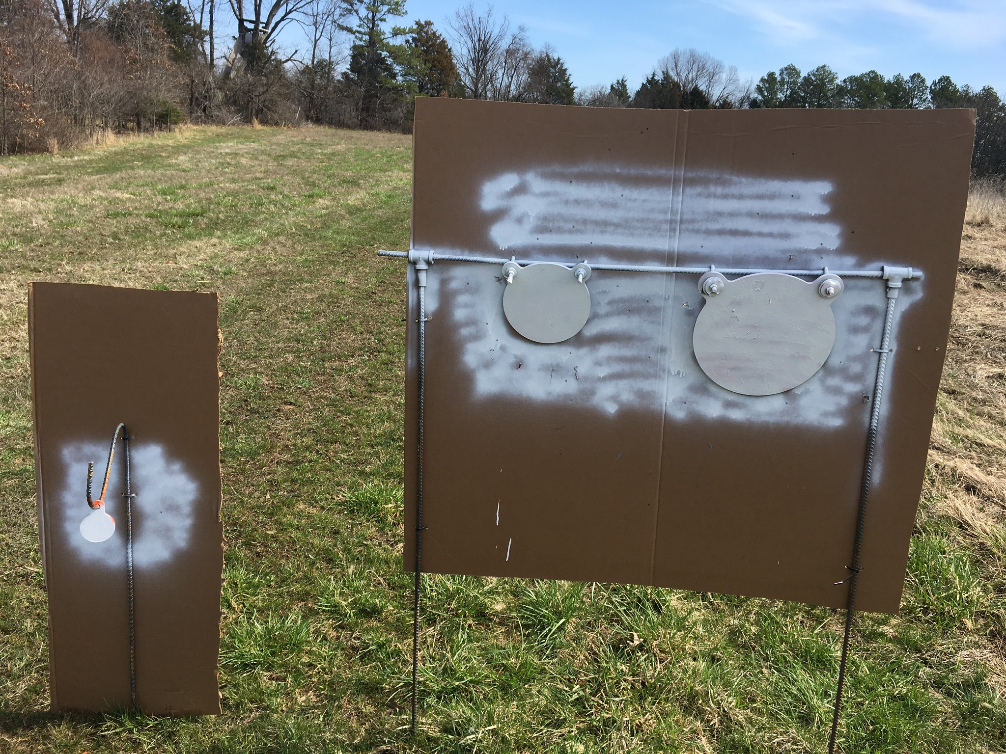

I got my AR500 targets from ShootingTargets7 and made my stands from 1/2” rebar & 1/2” black iron pipe. I use 3” nipples & 1/2” tees (thread a tee onto each end of the nipple & cut the nipple in the middle) to put everything together. Then, put a tee on top of each vertical piece of rebar with the piece of rebar for the target through the horizontal openings of the tee. I put eye bolts through the holes in the target so it can’t fall off from impacts (as opposed to s hooks).
For my smaller rimfire targets, I bought a rebar bender from Zoro online & made Shepard’s hooks from 3/8” rebar.
they hold up very well, hardly get hit and are easy to replace in the event of damage.

My mobile target system uses 2X4s to hang the targets, and I use steel conduit instead of black pipe (which is ten times heavier). For the legs. I use AR500 target brackets that look like these:
I just use steel bolts and chains to hang the targets. Everything is cheap and easily replaceable if it gets shot up. I've tried to go with more bulletproof stuff in the past, and it just gets shot up and costs more. 2X4s and conduit are cheap, and I rarely shoot the chains or hangers.
You just slip them on the ends of the 2X4 and then stick the conduit legs on them. I like to use a full IPSC at long range, so I have different lengths of conduit 8', 10', and 12' to get the target completely above any vegetation or in an otherwise easy to see position.
my gong rack is the same thing with a string of different sized gongs (I think from 2"-12") that hangs by the same system.
I like the full IPSC because it's so versatile from painting a target on it or head shots for close range to just shooting the whole thing at long range.
If I'm only gong to mess with one target I always bring the full IPSC. It also gives you some wiggle if you're shooting in terrain/conditions where it's hard to spot your misses.

  • Exposed BOLTS and chains are alway the weak link on any system~
We just did some testing with bolts and found that standard (NON grade) bolts are prone to breaking off the head because of the tensile stress effect of the bullet impacting the steel target plate. High Tensile GRADE 8 bolts resist these forces and will not shear the bolt head.
Of course a high velocity hit directly on the bolt head can cause failure even with GRADE BOLTS but 99% of the failures of bolted targets are caused by break forces on the bolt head.
Grade 8 carriage bolts are practically impossible to find locally at hardware stores. Hang Fast Targets keeps a good supply of GRADE 8 bolts in stock.
Here is a pic of a bolt that lasted about 20 rounds of 7.62 x 39 @ 25 yards on our "close range rifle target" set on an sharp angle.
We thought we had hit the bolt and shot it through but I found the bolt head on the ground. I had cameras on the target at the time so upon review we could see the hit and the bolt failure. We were testing longer bolts and did not have a GRADE 8 in that length and used a standard bolt instead.

I have been using 3/4" x 5' EMT for the legs and cross beam with 1/2" pipe hardware to connect it all. It is a pretty inexpensive setup that is easy to transport and has been very durable. I have also found that old fire hose or old tow straps work well for hanging the plates.
