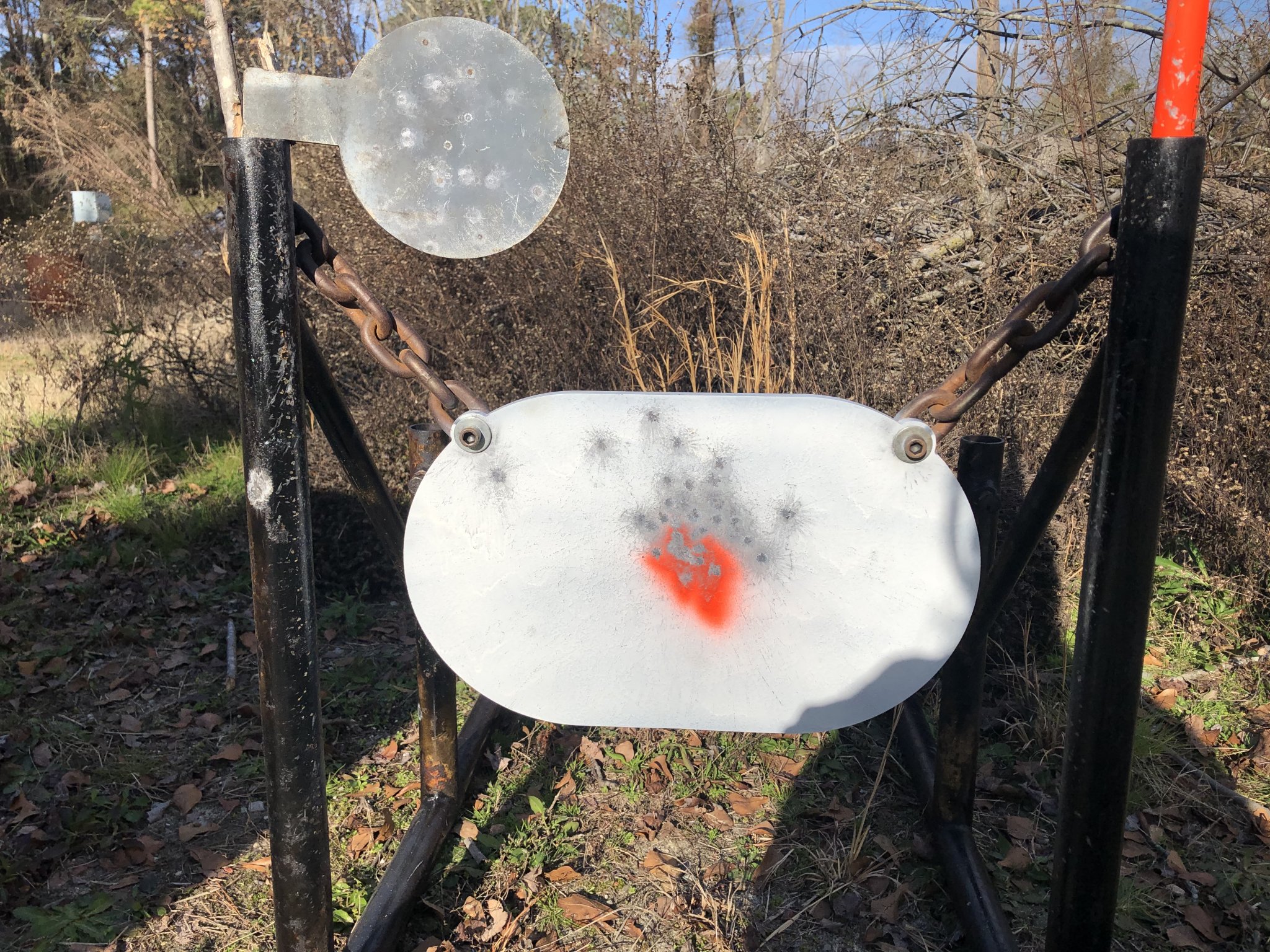

A few years ago I bought a few JC Steel targets. They’ve held up very well w/ no cratering or pitting. That being said, I’m not shooting them closer than 250 yards or w/ magnums.
I’ve got a few silhouettes I hang w/ brackets off T-posts & I’ve got a target stand w/ rebar legs & crossmember that I hang a 25% IPSC from as well. Our local range only goes to like 500 yards, but the steel rings very loudly, - even the 25% IPSC leaves no question whether you hit it ir

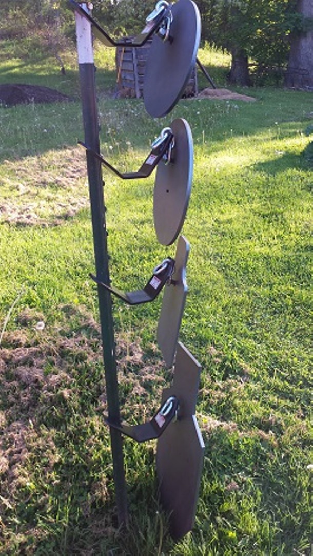

I help manage a club range going out to 600 yards. The steel that stays out on the range for general use all the time hangs from rubber straps from stands. All the hardware, especially anything exposed to possible bullet impacts is grade 8. It can be a real pain sourcing grade 8 carriage bolts but they can be found. It's worth it though because anything lesser blows up with a single impact and then you have a target down.
I'm working on transitioning all the steel that is used for special events to the JC steel target type slotted hanger with a t-post and hanger bracket. So much easier to set up and take down the range for a match using these style targets. I don't have to worry about a piece of hardware getting shot off or loosening up and causing a target failure.

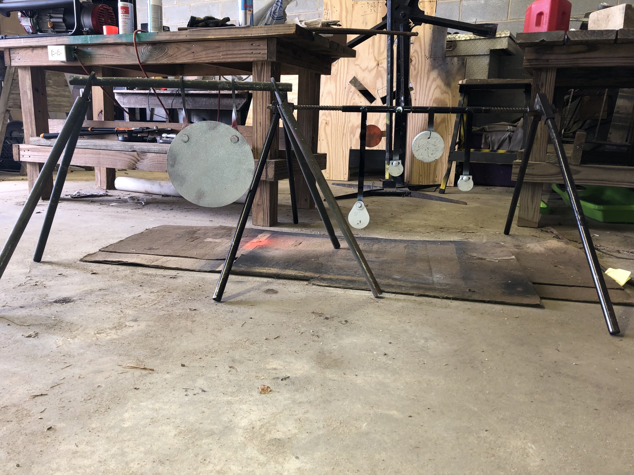

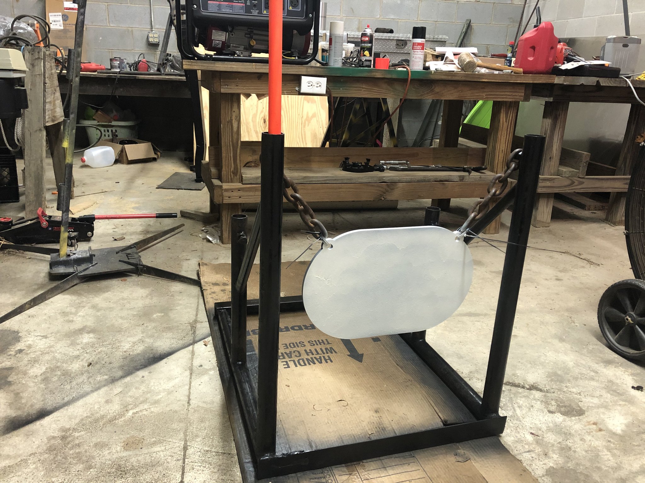

Made at the house and portable. Target size can be changed if you feel like it based off range. I add a small paddle to the top for a challenge sometimes

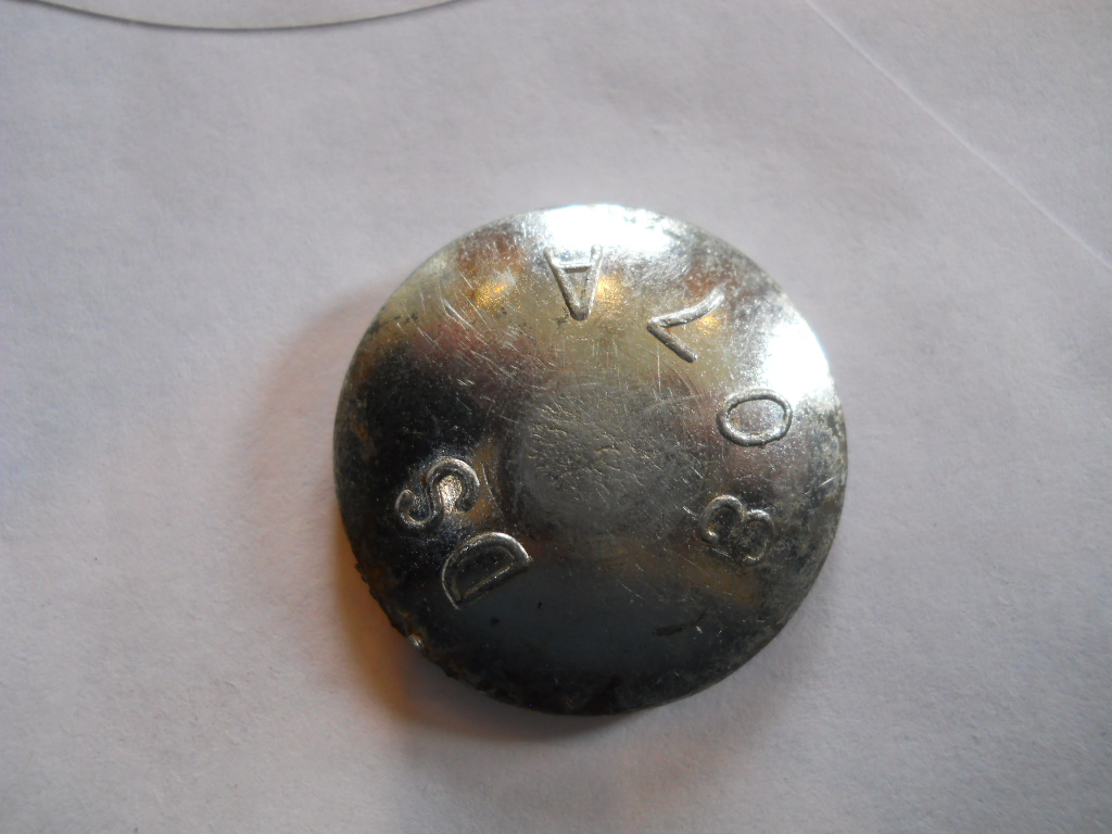

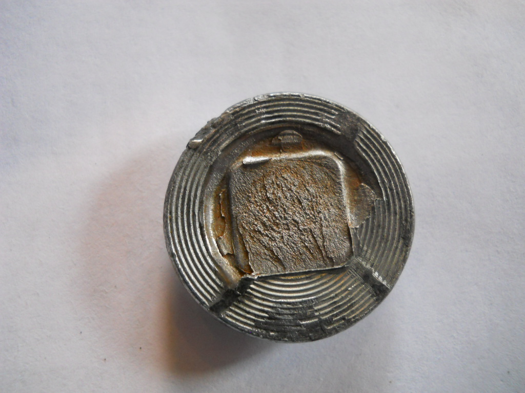

We did some testing on GRADE 8 bolts and found that most of the failures of NON GRADE bolts involve the heads popping off from torque forces on the target plate from bullet impacts. It usually looks like they were shot off but most of the time the heads just pop off. High Tensile strength GRADE 8 bolts resist these forces and target failures are greatly reduced.
Hang Fast Targets has a good supply of GRADE 8 bolts available HERE
Here is an example of a NON GRADE bolt head that popped off during testing of our new CLOSE RANGE RIFLE TARGET. It popped off after about 20 rounds of 7.62 x 39 @ 25 yards. I thought I hit it with a "lucky" shot but upon reviewing the camera footage it was obvious the bullet did not strike the bolt head but hit the lower corner of the plate imparting torque stresses on the bolt head. I went back to the range and managed to find the bolt head.
We switched to GRADE 8 and the testing resumed for hundreds of rounds with no problems.

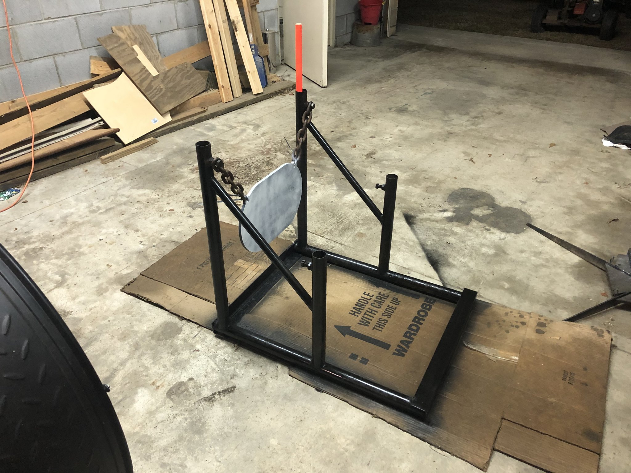

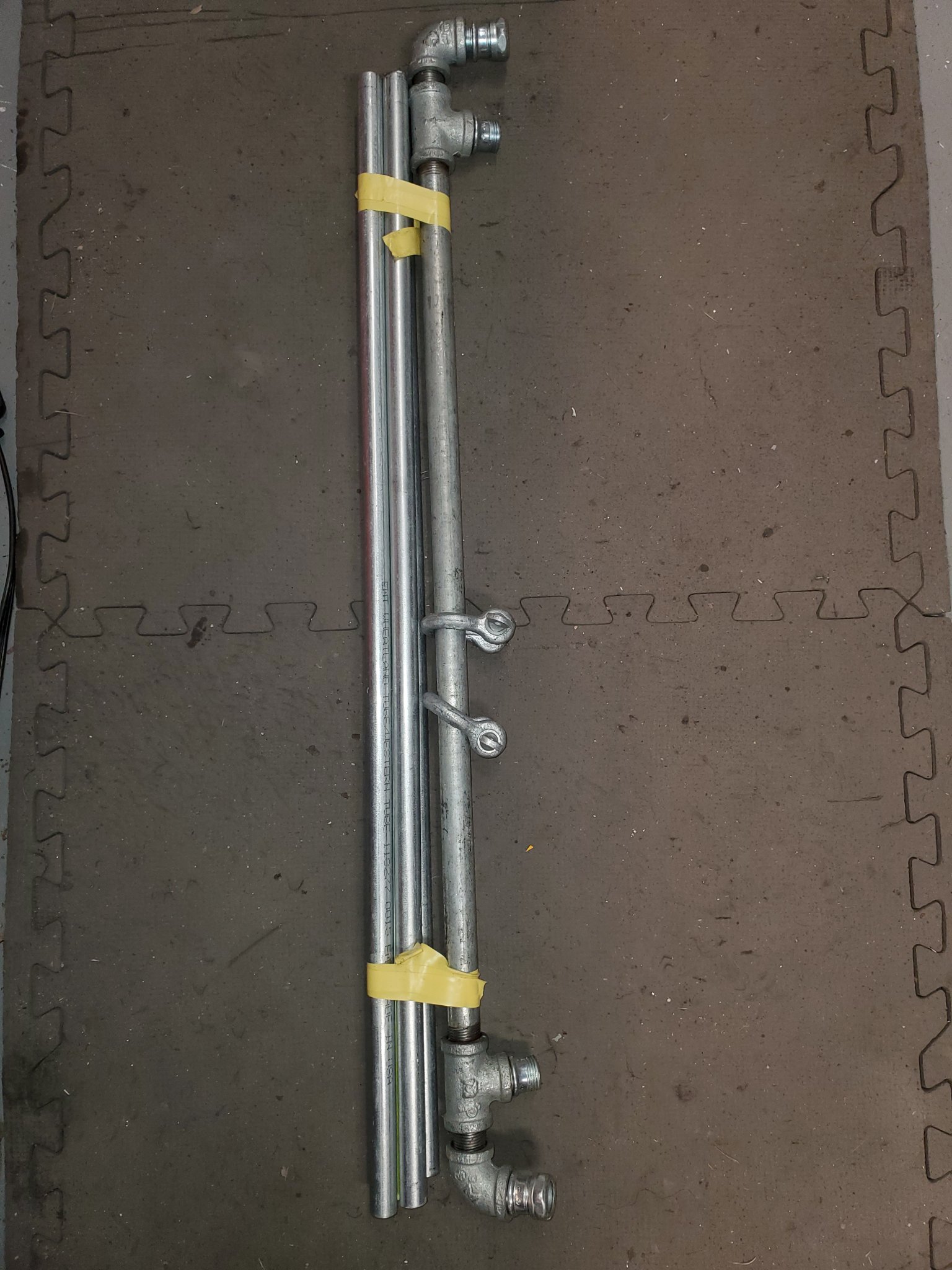

Just for the sake of portability here are two more I use. The one on the left is purchased as a kit and the right one I made with leftover 1” conduit (sourced from local scrap bin) for legs and some cheap 1” square tube stock from Lowes that cost 6 bucks. Flat steel from Lowes probably another 6 bucks. Cut and weld myself, so minus steel I have about twelve bucks in this setup. Both break down and will fit in a backpack just about completely.

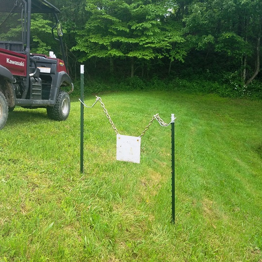

T Posts cost less than 5 bucks each and I can hang multiple targets on each T Post. T Posts can be used ANYWHERE except solid rock.
Hillsides are no problem.
Here is another system for those that must use chains that works on all terrain.

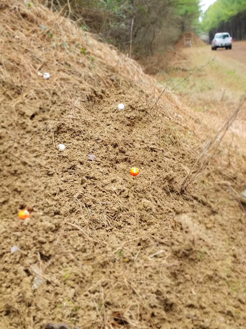

steel is fun you shoot it , if you hit it , it makes noise happy happy add the those lights when hit they flash that is pretty cool as well least till you or someone else hit the light and they break another fun one is golf balls those things shoot out where ever its pretty cool trying to re find them and hit again and again
golf balls on berm started at 300 yards some ended up out around where that truck was around 400 yards some go straight up others I will have to look for next time at the range .

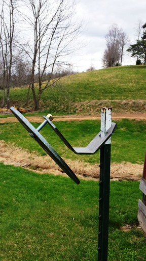

@vinconco what kind of brackets are those? I like those and look like some flexibility in hanging height.
Hang Fast.. The plates are reactive and loader than most other hangers.

@vinconco what did your stack up look like on the bolt head that popped? I have a piece of rubber between the plate and nut so I find it unlikely the bolt heads were popping off. Most of the time one shot takes the majority of the head off and the next impact on the bolt head takes the rest. This is on a club range that sees a lot of use. If you are using chain I could see the head popping off. Bolt stretch is also an important factor not often considered.
It took some searching last year but I finally did find a source for grade 8 hardware that I could purchase in bulk for not to much more then standard hardware.
The holes in my plates are square so I use 1/2" Grade 8 CARRIAGE bolts.
I've been using this setup for over 5 years never popped a bolt head until I used a non grade bolt.
I know I didn't hit the bolt with the bullet because I had 2 video cameras on it at the time and the video showed the hit at the bottom of the plate. I posted a pic of the bolt head earlier in this thread and there isn't a mark on it.
