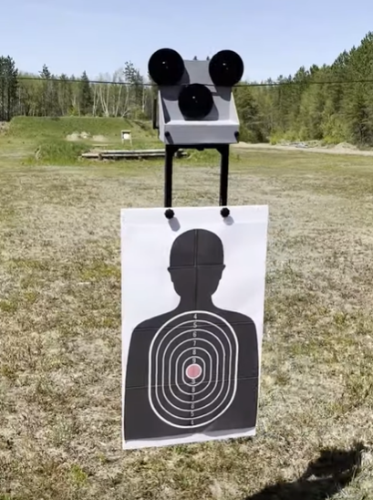

They can't hold steel, but these systems could do the trick on a budget. https://www.dynamicrangex1.com/
I was looking at these for rimfire mover for matches where we have berms. I was thinking make up a track of some kind for behind the 100 yard berm, and have a sled of some kind on maybe roller skate wheels or something attached to this so the cable is protected, the sled is also behind the berm and the rimfire target stand is holding the target up above the berm. I would prefer to power it by deep cycle 12 volt marine battery but electric power might be possible I suppose.
Anyway, that system for under a grand is a good start if it can be adapted.
