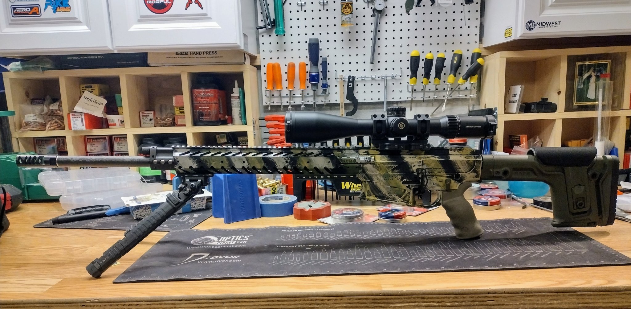

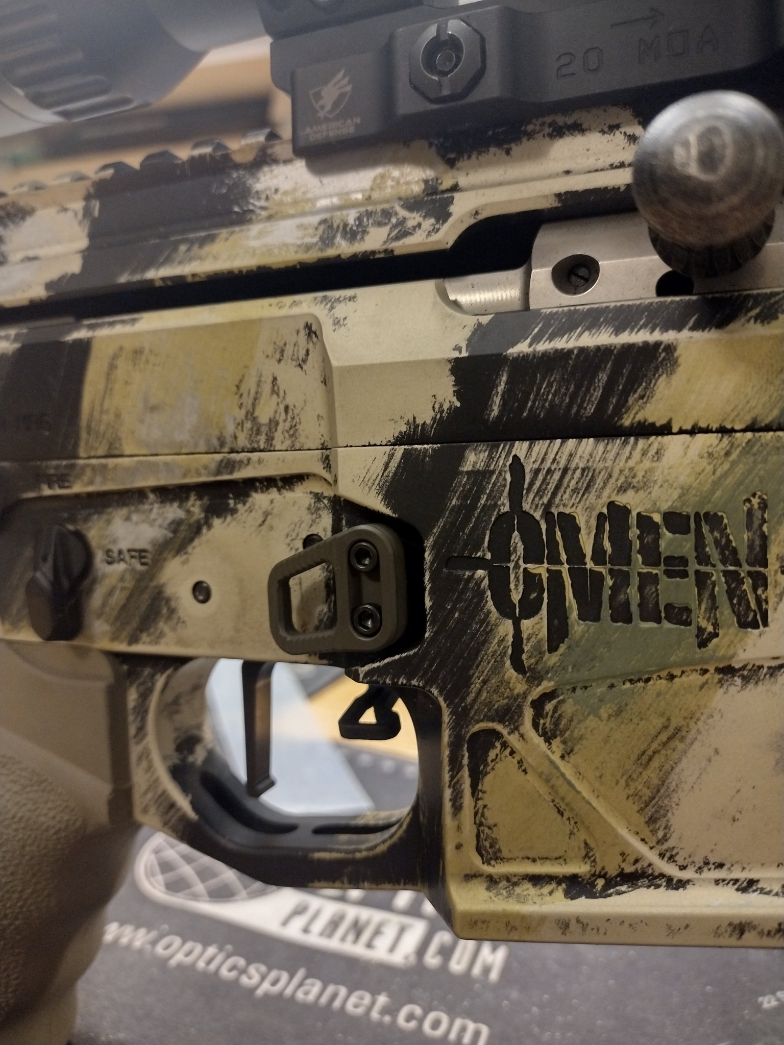

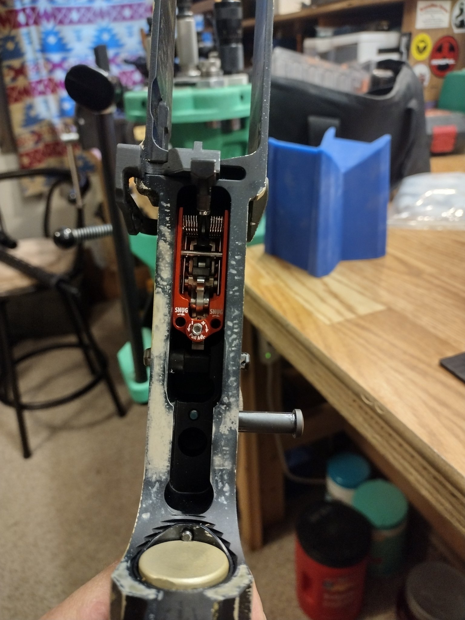

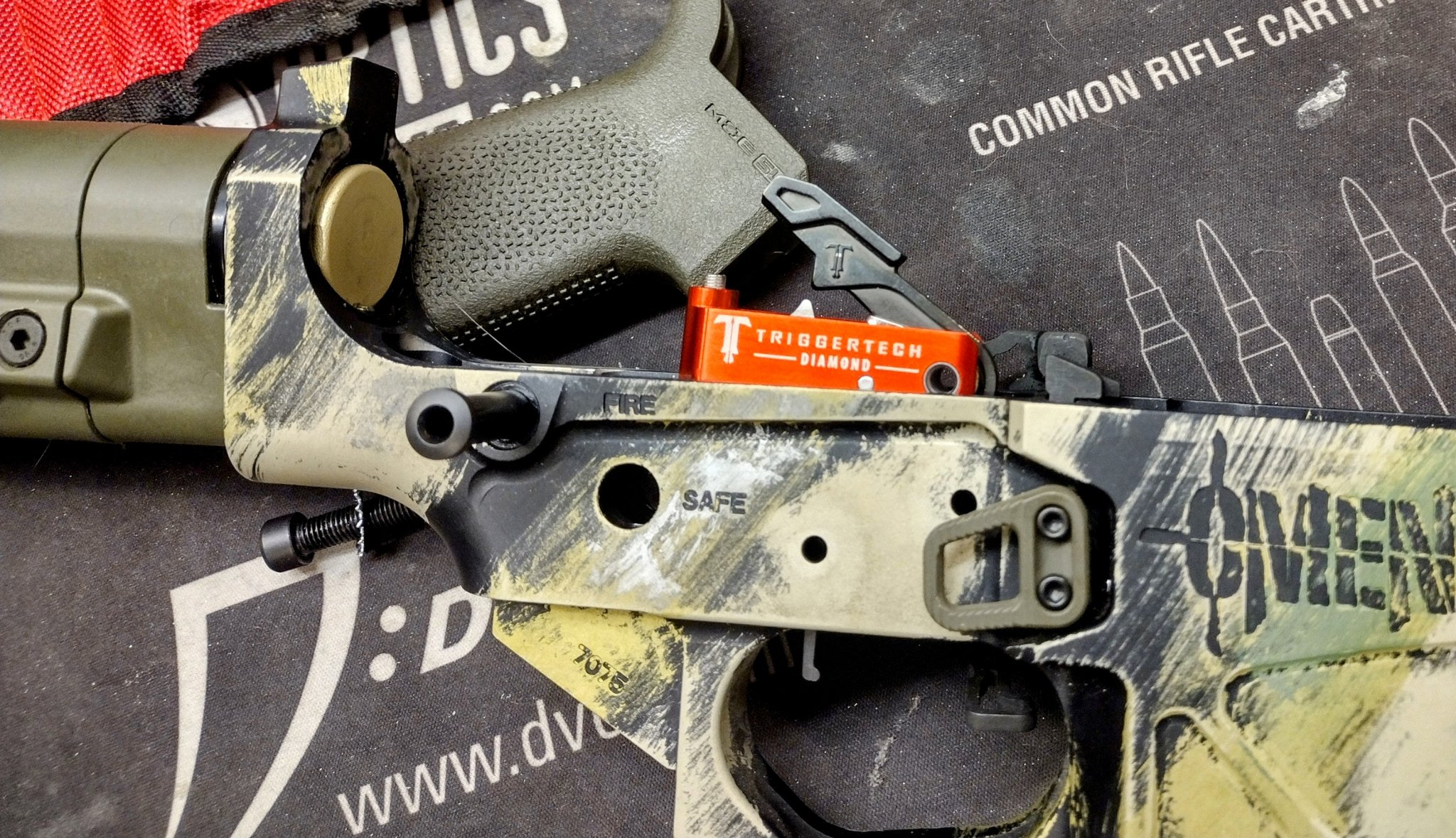

I have done some changes of the years. Mine is a bit different. And done some of the upgraded items that you find on the current Watchmen. It shoots very well. And is easy to got though your ammo as the recoil is not bad at all. I did replace the buffer. It cracked into little piece.
