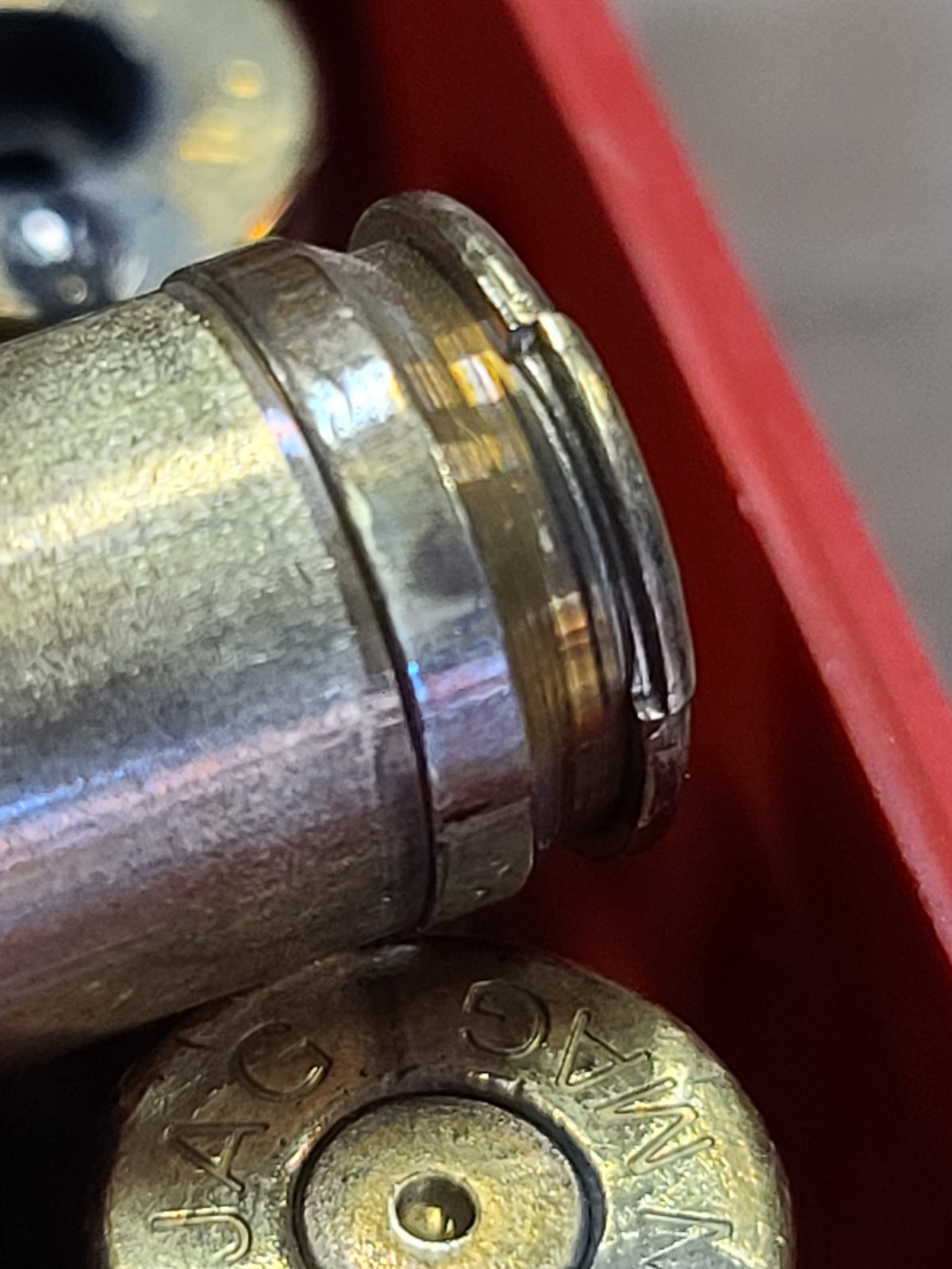

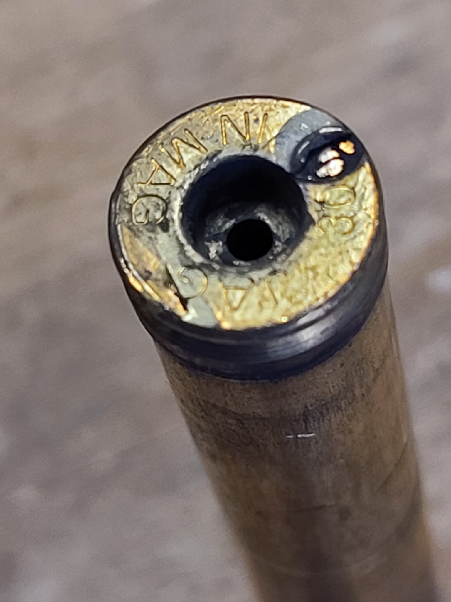

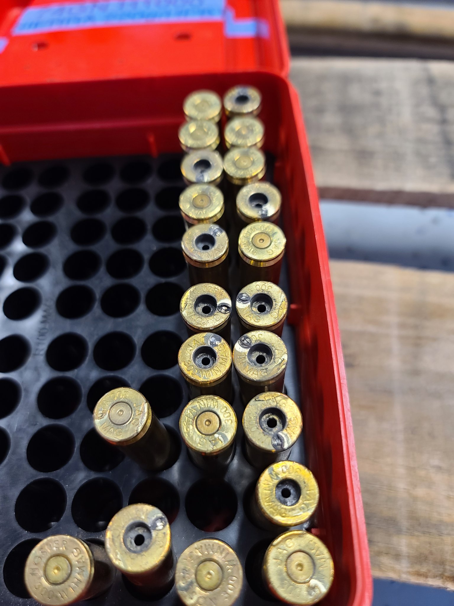

I purchased the Nemo Omen Watchman, July 2020, to get into competition shooting and reaching out past 1000 yards.
From the first time I shot this firearm it would not feed. 4 different factory loads, and handloading at least 20 different loads with Hodgdon H1000 and H483, bullet weights from 175 to 220.
Cases get jammed in the barrel, it blows primers, and breaks the foot off 1 out of 10 of the cases.
Nemo ignores my emails and phone messages. I have been trying to get a hold of Nemo since August 2020. Finally last week, May 17th 2021 I was contacted, and after a few emails back and forth with the issues I was told they would bring it in for the engineers to look at, but it could be at my expense. Now as of May 24th Nemo will not acknowledge my emails or phone calls once again.
Any advice would be appreciated. This gun is unusable as it sits.

Well first start with some pic's of the damage to the brass. Next completely tear it down and inspect, pay close attention to the gas system. Look for signs of leaking gas. Either from the gas block or the tube. Closely inspect the chamber for burrs. Last how much are you lubing and what's your round count. BTW cool gun. Just have to get it running.

What he said. You are at the Sierra bullets max load for that round, and it is way too hot for that rifle,brass,primer & bullet combo.
You clearly haven’t a clue what you are doing behind a reloading press.
Thank you slowworm. But 71gn worked up to 74gn with not a single round ejecting brass.
Semi-autos don't work that way! At 71grns you were probably already over pressure, you should have started at 68grns.
There's something else that you need to consider is your COAL, there's a possibility you could be jamming and causing overpressure.
Another issue which most people don't take into consideration when reloading for semi autos is that when you chamber a round the bullet has a tendency to slide forward due to the inertia of the bolt slamming it into the chamber, so if your neck tension is not correct that will happen. Always take a few of your loaded rounds and chamber them in a safe area then extract them to see if the bullet has moved forward upon chambering.

The pics are of brand new brass. Loaded with 74gn H1000 230 gr Sierra Match King. Not one ejected.
FWIW, my 300 win mag load with 220s/H1000/Fed215M and Fed brass was 74.4g in a mk13 mod 5 with the mk248 mod 1 chamber (designed to handle much higher pressures than SAAMI chambers) so your 74g with a 230g bullet is smoking hot (Selma Hayek in her prime-hot) this semi auto . Agree with @bigjake83 that 68-69g may have been a better starting point.

The damage in your pics is much worse than I visualized from the description. And the difficulty feeding throws another wrench in the gears. Glad you got some response from Nemo.
I found very early in my reloading venture that the listed velocity and my real life results are rarely even close. I no longer pay the listed velocity figures any attention other than a ballpark estimate of what's considered a normal range for any given caliber.
The damage also confuses me.
I have gone through my reloading manuals and the starting loads are all 70.6 to 71. What manuals are you guys using that give 68gn?
Again, an overwhelming majority of the data in reloading manuals was gathered using bolt guns. Gas guns have a lot less tolerance for pressure thus require lower starting charges all things equal. Especially magnum gas guns, which are a while different animal anyway.

That was me, and I was probably a bit harsh.
The rule of thumb for starting loads is 10% less than max. so 74 - 7.4 = 66.6 (o_O). That's where the 67 came from.
Secondly you cannot load for FPS from a manual. Some barrels are fast and some slow. You need to load for your gun and only your gun. You will get what you get out of it. Get a labradar or magnetospeed if you need to know what the barrel is doing. You may well hit pressure signs before the book max. It's voodoo and it's governed by all sorts of things like chamber slop, throat depth, headspace, how you size your brass, what sign of the zodiac the Sun is in etc.
Lastly you would have been showing pressure signs way before 74 grains. There are loads of posts here on pressure signs, so use the search function. Once you start getting swipe marks & flattened primers you've gone to far. If you start blowing primers STOP! Once might be a bad pocket. Twice in the same string is an immediate issue. Find out why (Headspace, hot load, bullet tension issues, gun out of spec, etc.)
Even in a gas gun at the starting load you should still at least half decent extraction. You might get the odd stove pipe and extraction may be weak, but it should still extract most of the time. If it doesn't then that points to other issues. I've run some pretty anemic loads in the AR platform with (almost) no issues.
