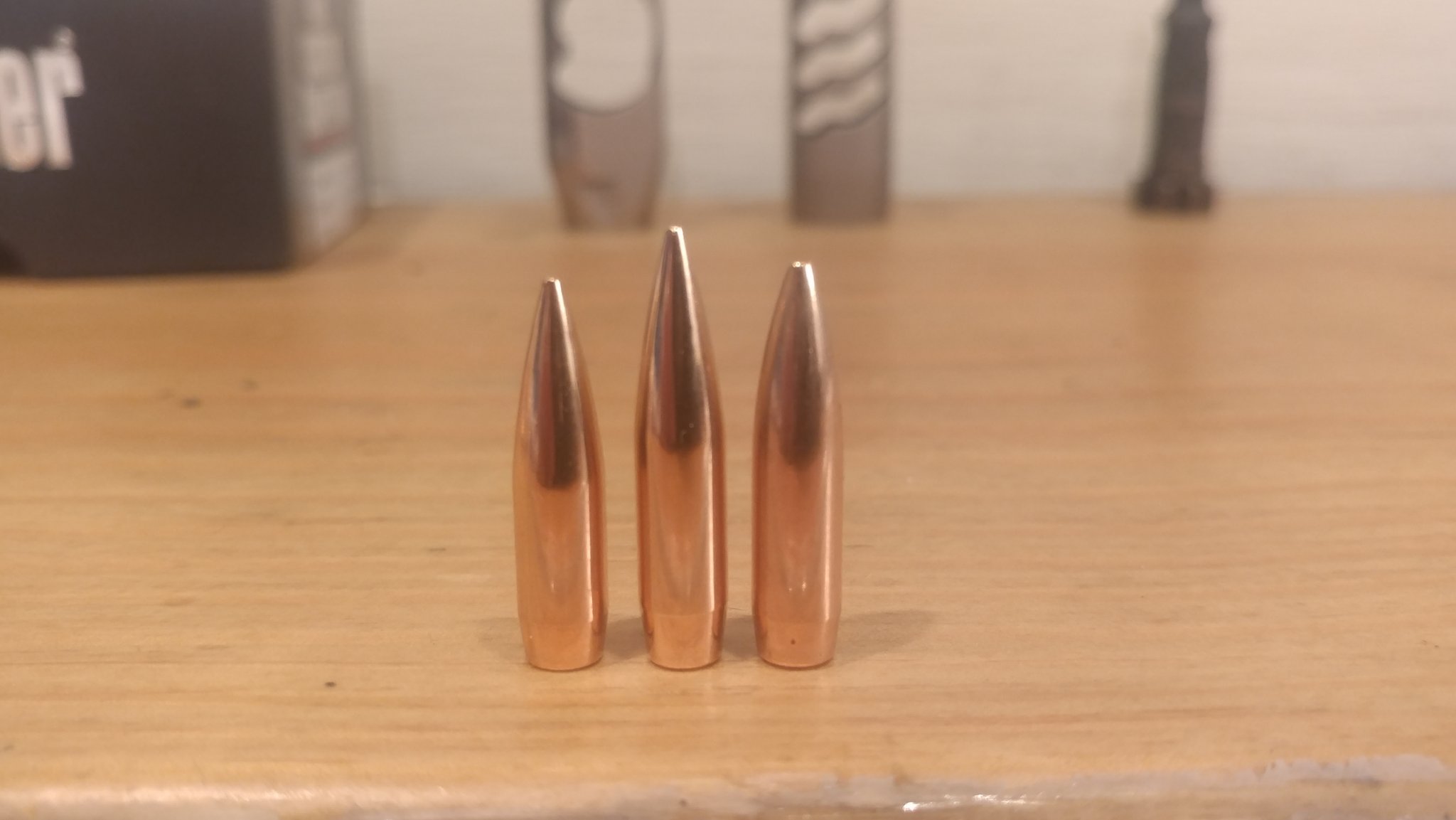

New .224 77gr Nosler RDF
TonyTheTiger
Like a Boss
Feb 14, 2017
5,177
8,695
https://www.nosler.com/rdf-bullet
No BC's listed yet but the weight is mid way between the .41bc 70gr RDF and the .5bc 85gr RDF, these could theoretically be in the .45bc area which would be a big deal if they're designed to feed from AR mags.
Honestly the 70gr RDF's didn't want to shoot that well for me but I'm a bullet whore so I'll probably try these anyway.
Well the G7 for the 70gr is .211 and 85gr is .245 so im guessing somewhere in the middle of those 2 numbers. These are per strelok pro ballistic calculator.

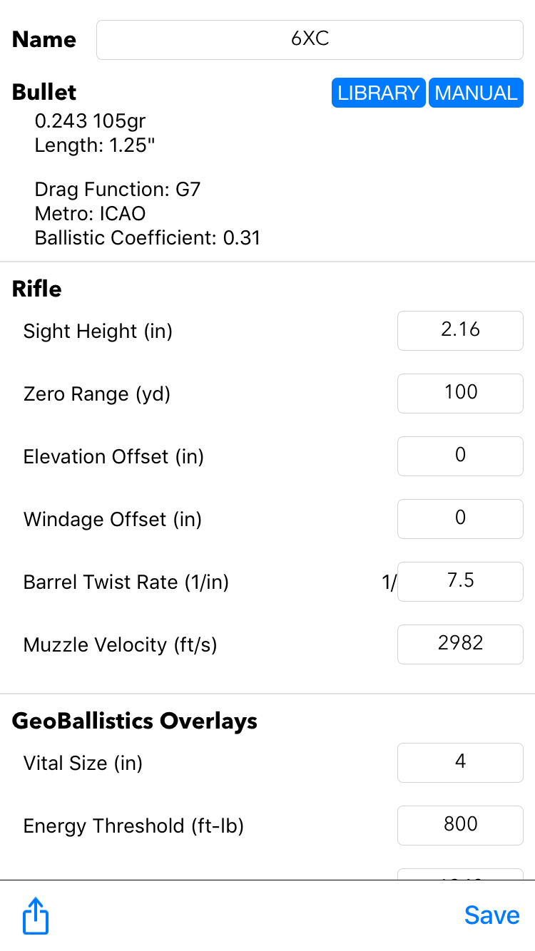

Well damn, I already trued my 105 bc up to .310 to line my data up
No way you're getting .310 out of a 105 bullet... unless it's a flatline or something. I know many many guys who have run or tested the RDF's and the highest I've heard of is mid .290's.
The preliminary reports on the 115 from my buddies who have tested put the 115 in the neighborhood of .310.

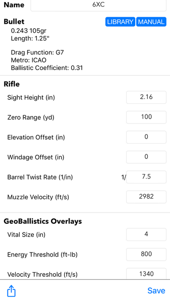

Don’t know what to say, it’s what lines it up. I even set it back to .280 for this most recent new lot but had to turn it back up to get things to line back up at distance. Velocity via ms3 and lab radar.

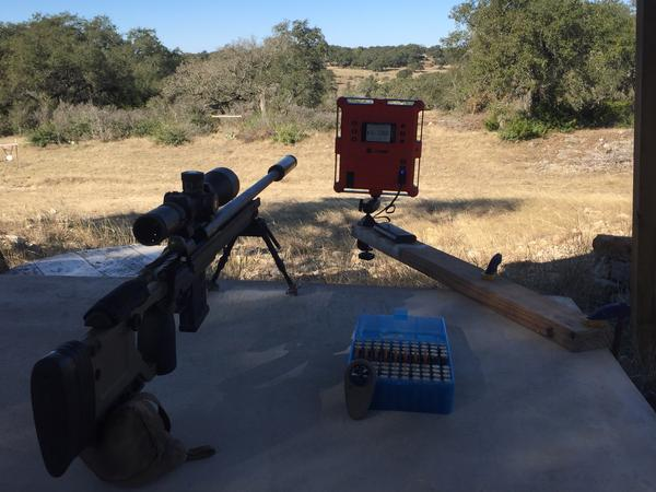

6xc, 24” 7.5 twist criterion, 4x norma brass, cci200, 105 rdf sps blems, 39.5gr 4350, seated 2.120 ogive so .015 from touching at 2.135
I’ll take data in the morning via labradar while zeroing (and every other shot as well). I’ll enter that into my BallisticsARC (jbm engine) and see what it says. I’ll then shoot at 500 to verify velocity and then I’ll shot to 810 to trim the bc as that’s all I have access to during hunting season. Luckily I can do all this from the same seat at my bench.
But it worked for me consistently at 1050 last summer and carried me all the way to 1570
I’ll run it again in the morning but it’s been working for me for at least a year now.

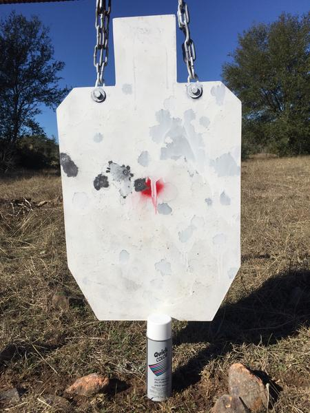

I put a red spray paint dot in the middle of the full size ipsc and read it in relation to that. I’ll even put out some paper to shoot on if I have time. Funeral at 2 so my day will get cut a bit shorter than I would like but I should have enough time.

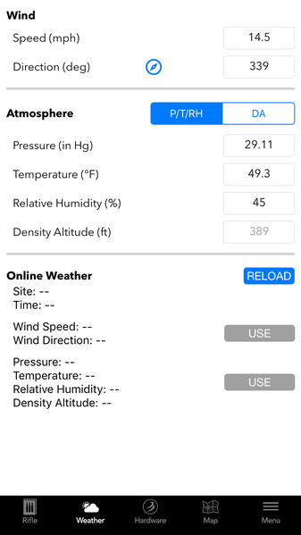

Edit: 20-25 mph sustained winds according to the weather and gusts up to 40 mph. This test may not work too well.
Weather
Rifle Profile
Set up
Zero- Cold bore bottom right, #2-7 are the group but Im not actually going to change my zero setting because its really windy, so noted as one tenth high as is.
500 Yards 66% ipsc- Lots of wind... I didnt dial any windage, just going to shoot to see where it would land. Where did the first one land? The center of the next plate over on this KYL rack :ROFLMAO:. Dial .9 mils right and I put a few on it missing one off to the right, but centered vertically.

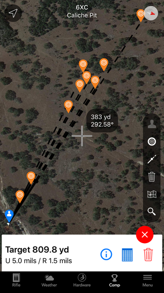

800 yards- Sent the first three off the left side of the plate, wind seems to have been dying as they worked their way back to the right.

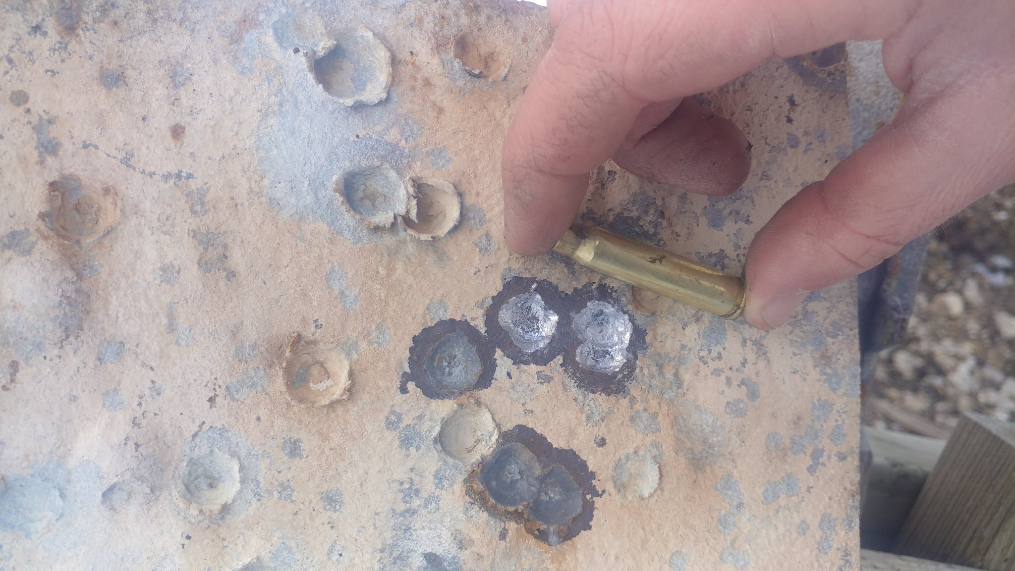

So I was hitting slightly above but my highest hit was 2" above perfect. And Im too stupid to calculate exactly how much the 2" im hitting high is at 810 yards in mils (something like .04 mils?) so I will instead switch the ballisticsarc settings to inches to get some actual numbers here, I can clearly see the difference on the reticle but its tougher to get a pic of to show.
With a .310 BC it calls for 5 mils (146"), with a .280 it calls for 5.3 mils (153"). 153-146=7" of difference, with a .280 I would have dialed and been hitting 7" higher. Which is what I saw when I first was truing this, only it was more like a foot+ at 1050.
So Im hitting less than .1 mil high at 810 and my zero was about .1 high at 100. I might be able to throttle it down a bit but it lines up pretty well.

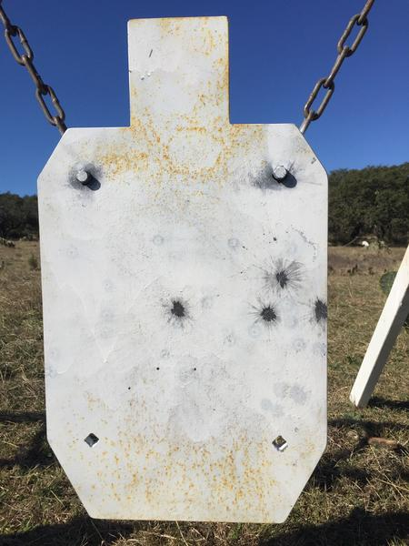

Was going to do a thorough load workup today, but a high temp of 3 degrees and lots of snow didn't make me feel very scientific so instead I just threw 23.4gr of XBR in some prepped LC cases at max mag length on my 550 and ended up shooting a bunch instead of any serious testing.
I was pleasantly surprised by them. Before I talk about group sizes I'll preface with rifle details. It's my 16" rifle gas 3 gun blaster with a 1-6x optic with a fairly coarse reticle. Not a benchrest gun by any means and I don't want max pressure loads because of the low mass components/light springs in the gun, and reliability trumps ballistics every time for match use.
That out of the way, 4 five shot groups averaged right at 1" which is actually about as good as I can usually do with a 6x optic while lifting my head between shots to write down velocities. Velocities were better than expected at 2650fps avg with 50fps extreme spread (remember, charged on a progressive press for 3 gun, not F-class..) with only slight primer flattening, and that doesn't take much with CCI400's.
The only steel not buried by snow was at 400 yards and using a .45 G1 BC got centered hits on a 6" plate using exactly the holdover Strelok predicted. Obviously that's not far enough to accurately true up BC but it must be ballpark.
I'll do more testing when it gets warmer and test them in my precision AR but I think I'm off to a good start for my intended use. If it holds 1 MOA-ish and doesn't exhibit the wild random flyers I always had with the 70gr RDF's I'll be satisfied.

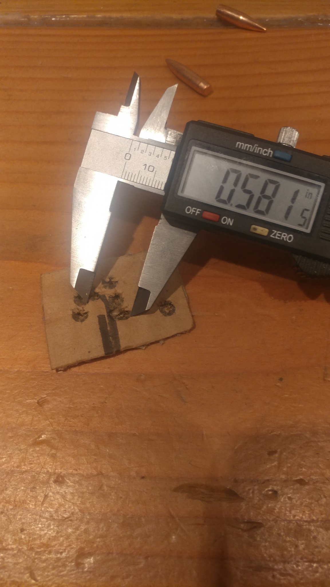

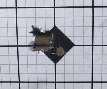

Starting to dig these 77 RDF's. Still shooting the 23.4gr 8208 load with no real development, decided to throw ten rounds at paper today at 95yds (the snow was a foot deeper at 100yds, and I was prone) and this happened:
So a nine of ten shot group at .6ish while using a snowball as a rear bag. I'll take it.

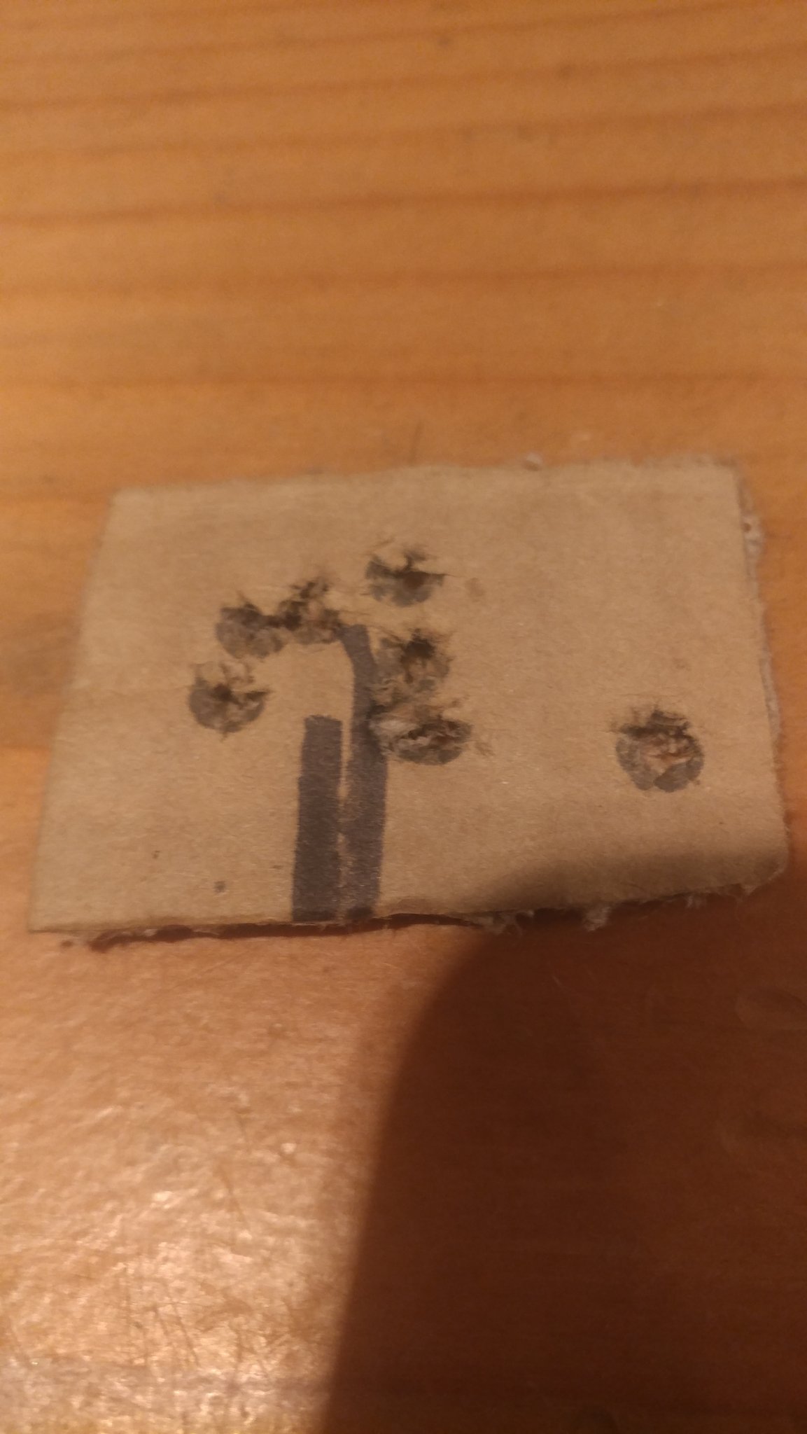

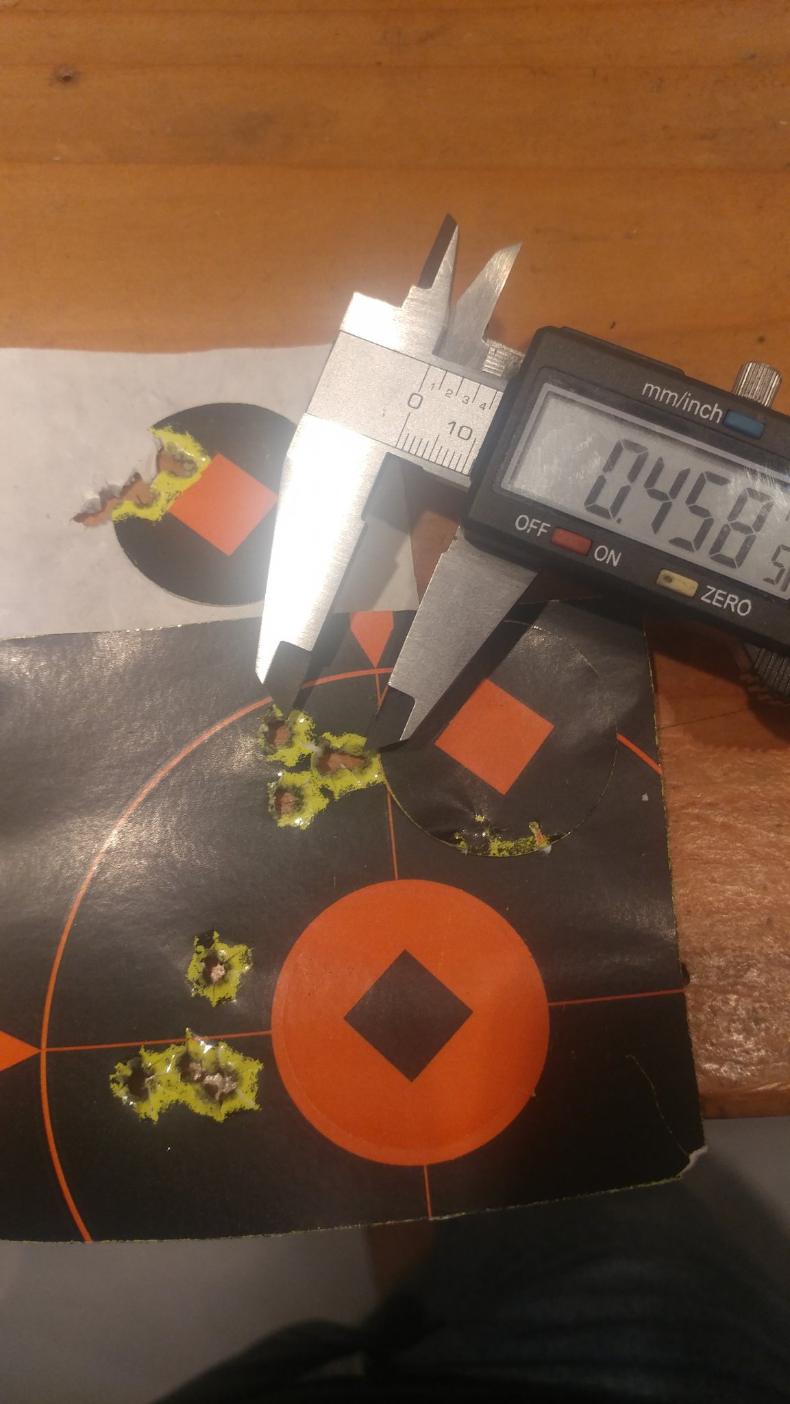

Happened to be shooting groups with my precision AR tonight and I was frustrated with how the 75 ELD's shoot well one day and not the next. On a whim I decided to shoot some of my 77 RDF loads through it. I was pretty pleased with the way that went.
Thats 3 consecutive 5 shot groups, largest about .68 and smallest at .46, with zero load development.

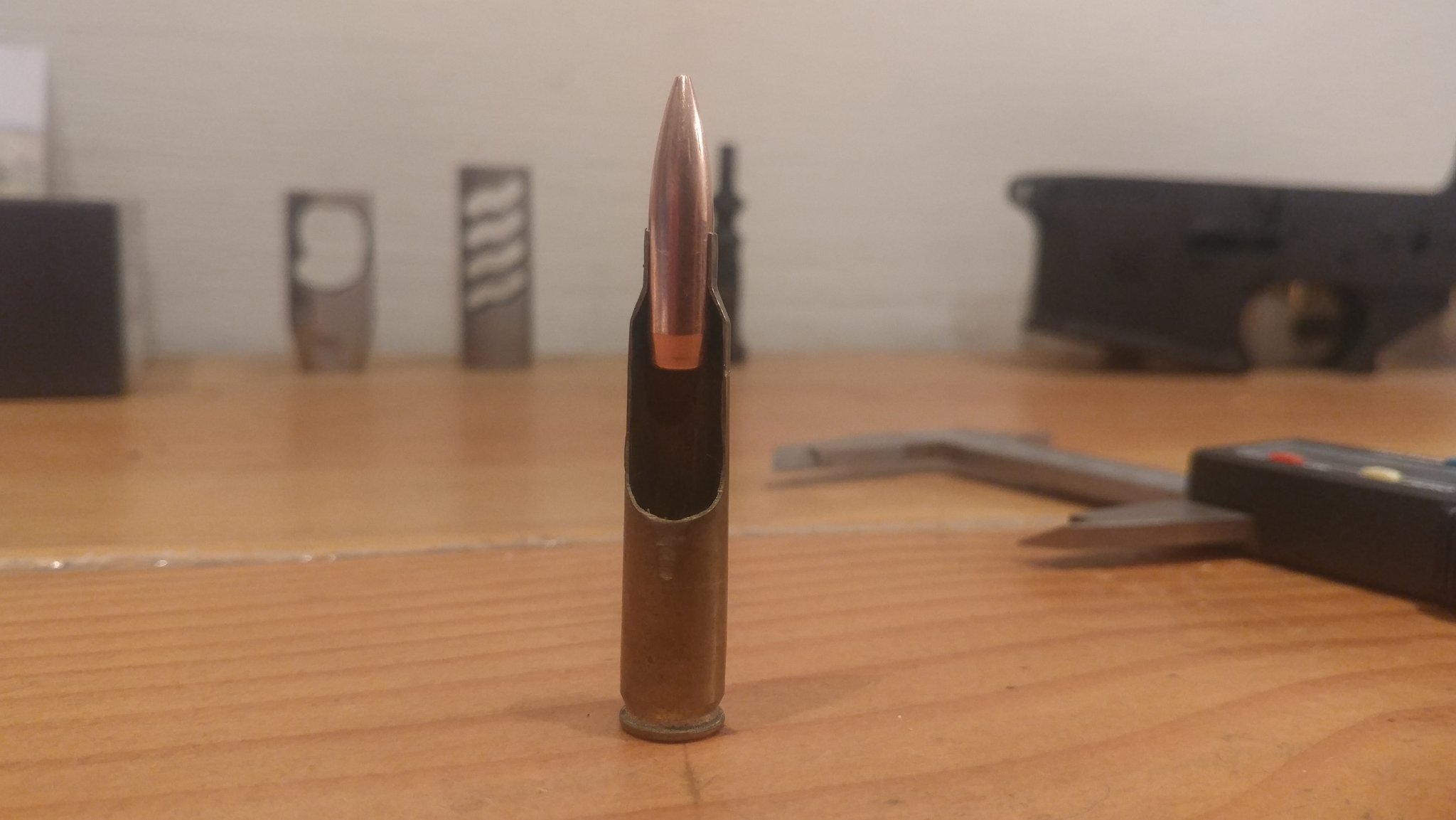

I finally got out to try the 77 RDF's. Shot in a 20" WOA service rifle barrel upper and a 18" Rainier SPR ultra match upper. I tried loads using 8208 XBR, AR Comp, Varget and H-4985. Loads were 15 rounds each for 3-five shot groups.
WOA barrel didn't like any of the loads. shot 1.5-2" groups. The only load the Ranier did okay wit h was the 23.5 8208 load. 3- five round group was 1.2"-1.28".
Interestingly, the AR Comp load was 21.9 Grains. This was near max (22.1) from the Alliant data. One rifle wouldn't cycle, the other rifle, barely cycled and both showed the load was anemic, ligher recoil from the other loads. This was a 2013 lot of AR Comp. I'm going to try AR Comp again @ about 22.9 grains and see what I get.
Both of these rifles will shoot 77 Sierra MK and 75 Hornady OTM under 1 MOA.
I had tried the 70 grain RDF's in these rifles and found the same inaccuracy.
Too bad, I was hoping the 77 RDF's would shoot as well as the Sierra 77.
I tried some 77RDFs last weekend. At the lands with VV N140, some Varget and some IMR4166. All were Sub MOA at 200yds from a 24" 1:8tw bolt-gun, but nothing special. I did not do extensive load work up but FWIW, IMR4166 was more accurate (.6-.7MOA 5-round group) than the other two powders and marginally faster than Varget for the same charge weight.
OALs were ~2.355" at the lands with a SAAMI-spec Manson reamered chamber.
Maybe I'll try jumping them from mag-length next time.

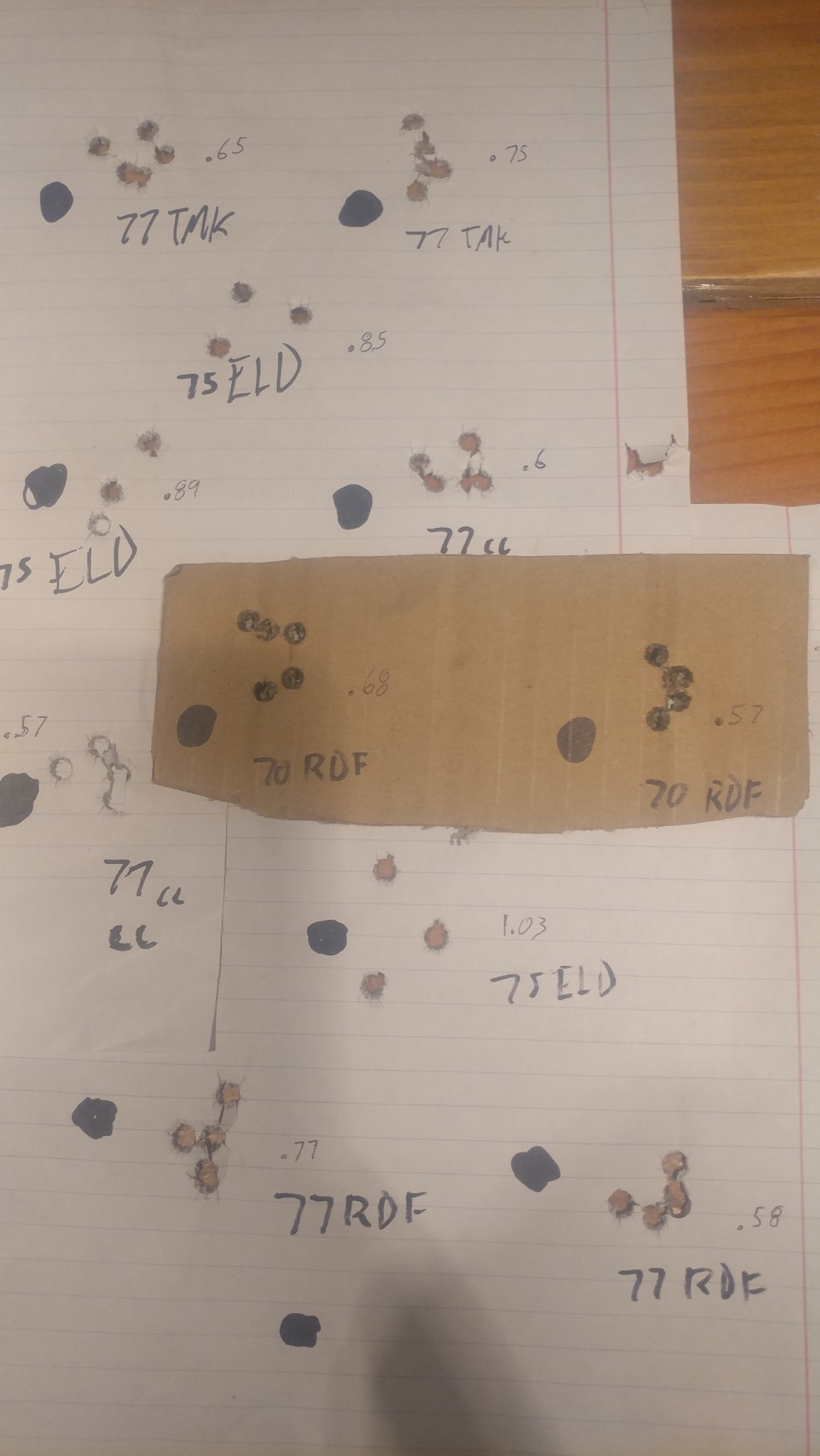

Used 77TMK's, 70RDF's 77RDF's and 77 Custom Comps. Shot two 5 shot groups with each, and the eight groups with zero load development averaged .64", which I can't complain about considering my disinterest/lack of skill for group shooting.
So even though the barrel is done shooting the ELD's its still interested in other bullets.
