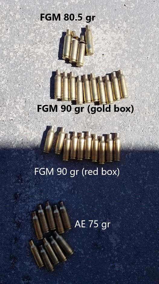

I googled FGM 224 Valkyrie Berger 80.5 gr and found this post. I shot my first box yesterday and this happened to 2 of 20. I probably have around 200-300 rounds of FGM 90 gr (1st & 2nd gen), Hornady 88 gr, and Federal Eagle 75 gr without any issues.
Production #653A338647344. I contacted Federal today so hopefully I'll hear back from them.
Anyone else experience something similar?

I didn't hear back from Federal so I called this time and they called me back less than an hour.
According to the person I spoke with, he's saying it's a headspace issue and the case is expanding too far before it contracts again before being ejected. I asked if the brass composition had recently changed because I've shot hundreds of FGM 90 gr & AE 75 gr without this problem and he said no. He also said Federal brass is softer than others. So if he's correct, I should be able to duplicate this problem with other Federal ammo. If not, it's not a headspace issue.
He also said he's going to send me return info and I can send back a box of ammo (I have 4 boxes left) and he'll have it tested.

Compare an unfired round to one that ejected from your gun in one piece. See how far out the shoulder is on your spent case. Bear in mind a saami spec case is going to be a bit undersized for your chamber..
So I sent in a box of 80.5 gr back to Federal. They initiated UPS pick up. We'll see what they say...
However, I went out today with all my 224 Valkyie ammo: FGM 90 gr (red box), FGM 90 gr (gold box), AE 75 gr, and FGM 80.5 gr.
ACtC-3dCCPvchJ_kKZzr_9bmtEY6LmKfEZn_keZW4UJGYXp6y2a5dX-Re03x6BTzcUefhNMjqCniLjsc-caGnBsTMNIUuT5P7h1RqfDrZlsvOTM-Y8-NcLRos3XS3XwObtSEDh6riweSpb_6yPnYulMp9OeU=w1666-h937-no
And as I expected, only FGM 80.5 gr had case head separation. Everything else was fine.

I'll wait to hear what Federal says after they run their tests, but If something goes wrong, it seems like ammo makers always blame the rifle and rifle manufacturers always blame the ammo. It wasn't surprising Federal's initial response was "there's something wrong with the rifle" but I think this proves
it's not the rifle.
Okay, so going back to what @Powder_Burns said in post #18, can you compare an unfired round (case length) to the case length of a fired but still intact casing? Also, how does the length (headspace length) of the fired and intact casing from the FGMM Berger 80.5 compare to fired casings from the other loads?
Anytime that you have an issue such as this one, it pays to do due diligence in analyzing what happened. First, in order that maybe you can avoid it in the future and second, because you sent off some ammo to Federal to have them test it. You already expect that they will come back to you and tell you that it’s your rifle.
So, you owe it to yourself to truly eliminate that possibility. Now, just because your rifle shoots all of the other Federal ammo without issue, doesn’t automatically mean that the rifle, and how it is configured, didn’t contribute or cause the problem.
You already know that this is quite a bit hotter than the other ammo you’ve shot in the rifle (over 200 FPS faster for a not much lighter bullet). I can tell you that when I was trying out different .224 V ammo types in my rifle, they cycled at very different rates. I had to adjust my gas block quite a bit, from one extreme to the other to get Hornady 88 gr to cycle after shooting Federal 90 gr ammo.
Even today, while I can switch back and forth from shooting Hornady 88 to AE 75 without adjusting the gas, one throws the brass at about 2 o’clock and the other throws it at 5 o’clock. This tells me that the pressure curves and therefore bolt cycle times are different between them.
The point of all that is that with what is likely a good bit higher pressure round, you may be getting a bolt that is unlocking to cycle before the pressure curve is complete, allowing the brass to over-stretch enough to separate. This is only a theory I’m throwing out for you and only your data and observations can confirm or disprove it.
Have you observed that your brass from these different loads ends up in completely different places from your point of fire?
Thanks for the input. You brought up several points I didn't consider and I remembered some some initial issues that I addressed a while back.
I had no cycling problems with FGM 90 gr, but later on, when I tried the Hornady 88 gr, I had some FTE and/or it was ejecting closer to 5 o clock. Since the upper didn't have an adjustable gas block, I think I put in a lighter buffer and I haven't had any cycling issues since and it ejects closer to 4-5 o clock.
