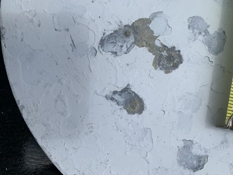

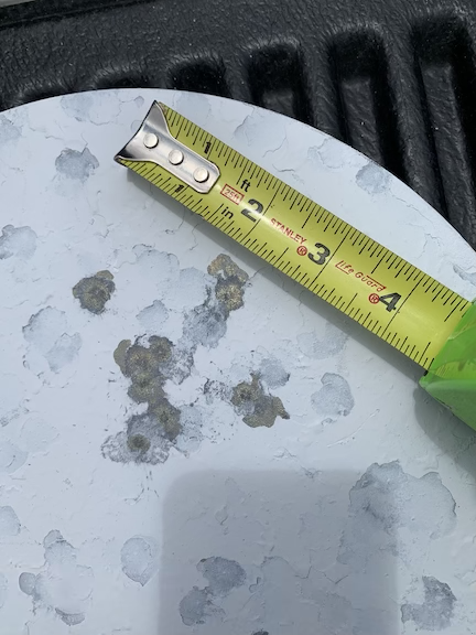

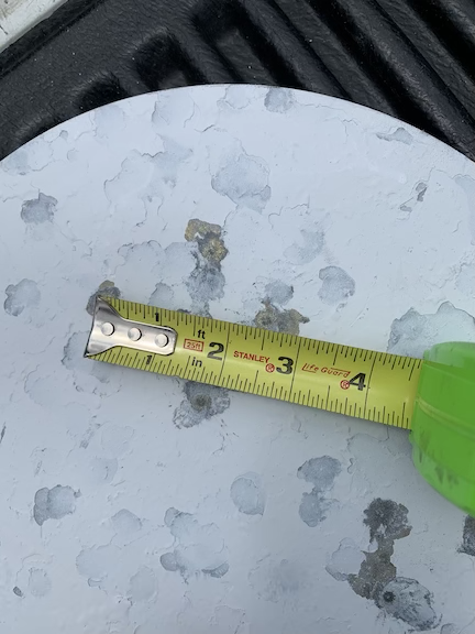

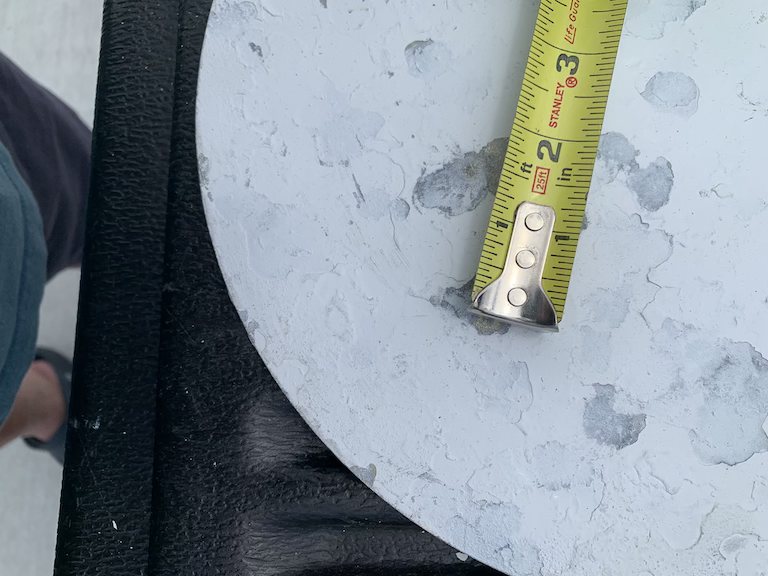

Took the 17HMR barrel off and replaced with a new 20.5" 22lr barrel. I put about 400+rds thru it today. Started out with 150rds of CCI SV. To brake it in. It did not shoot very well. Then went to Eley Contact, a night/day difference. sub 1/2" at 50 yds, then hitting 2" plates at 200 yds and 4" at 300yds about 50% of the time. SK Biathlon and LR shot even better. Shooting sub MOA groups at 300yds. This gun is going to be a shooter. 10 shot group is SK long Range at 300yds 2.75" 5 shot group is SK Biathlon 2" at 300yds

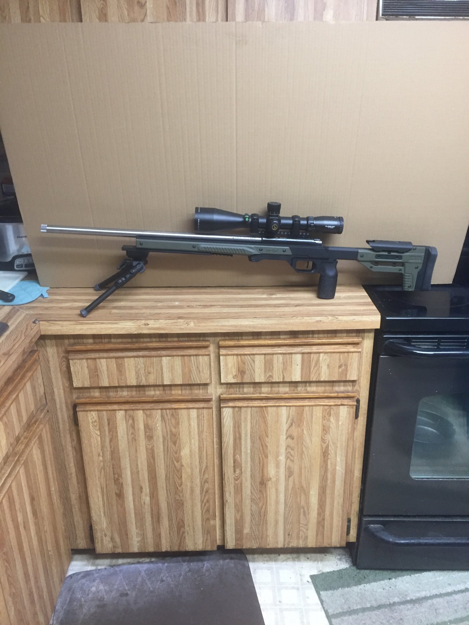

I did a lot of what you did. I put the EABCO 24" Match barrel on, the Oryx chassis, and I started with the 144 spring from Ace Hardware which I got the factory trigger down to 1lb. It was good at 1 but if you tried to go lower it failed the bump test. On the CZ USA website they have the Mr. Fly trigger for 99 bucks. Helluva deal. I have it set at 8oz. Attached is a pic of my 455.
