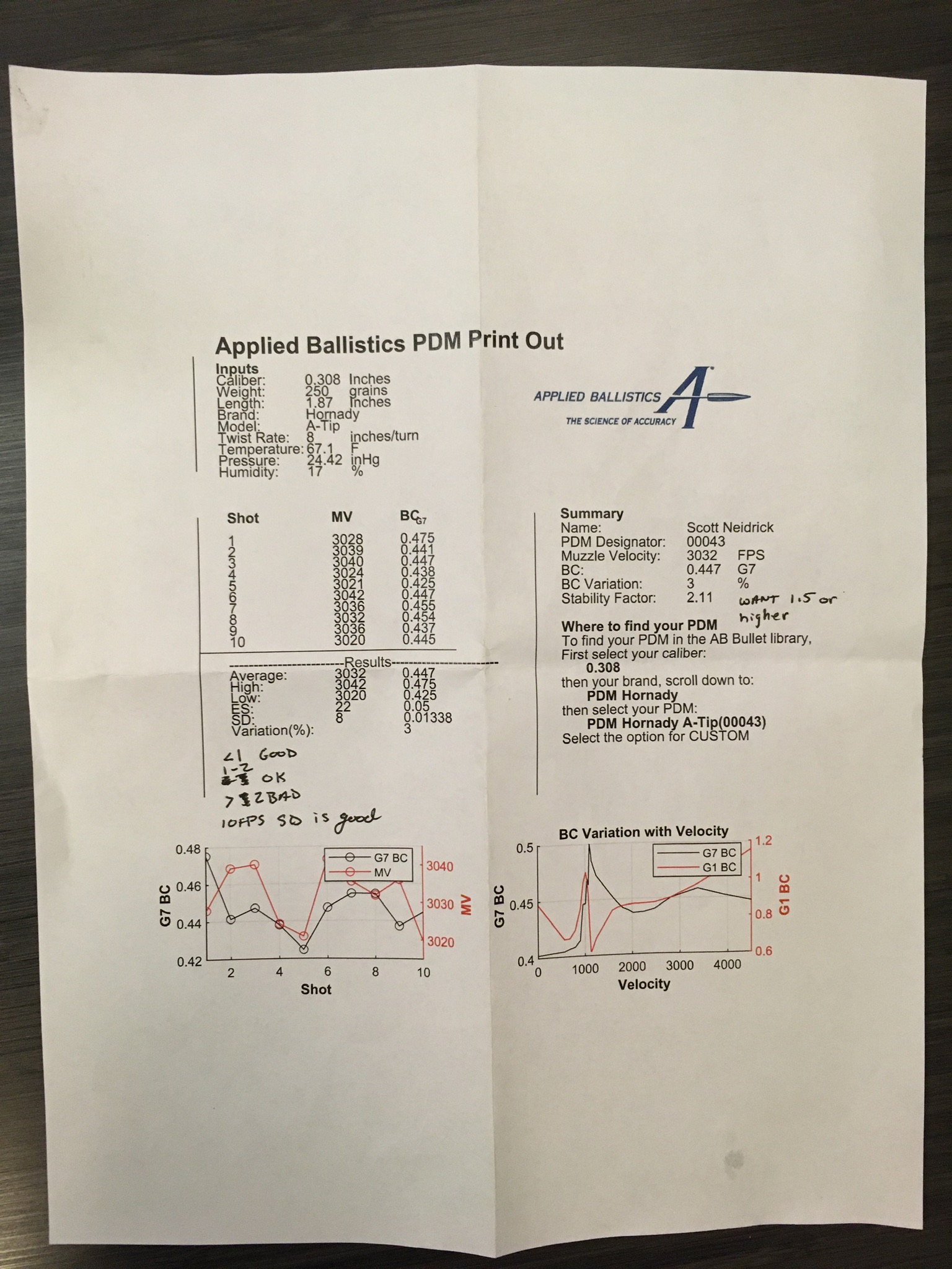

Ya, I have heard people having success- I don’t know what is causing some success vs failure- I just think the RPM is on the edge for the thin jacket. I had the same issue with my 6.5 PRC- so I am staying away from ATIPs. Also, when I did the Doppler radar with Applied Ballistics- the ATIPs had a 3% BC variation. You want 1% and no more than 2%- so I switched to Berger and had a happier life. I also contacted Hornady many time to help- but they keep blowing me off so I’m done with that customer service.
Could you post the 250 ATIP and 245 EOL sheets that you got when you did the doppler radar tests with AB?
Reactions: robb_va
