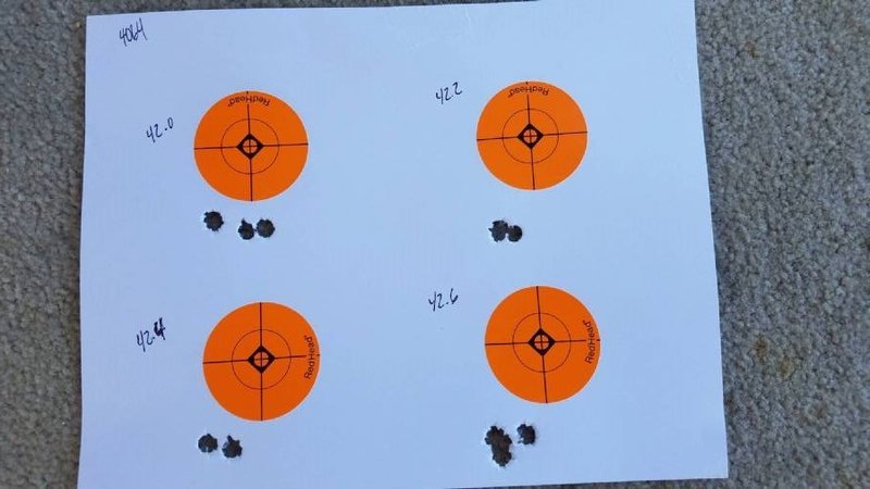

I used both Varget and IMR 4064. With the Varget I started at 44.0gr and worked up in .2 increments to 44.8gr. With the 4064 I started at 42.0 and worked up in .2 increments to 42.6. Pics of each target are below. All where 3 round groups in each charge weight.
The Varget has me most confused. The one shot in the 44.2 group I know I jerked so that may be the best of the 5 groups but none are really that bad or that great. All at 44.2 and above are sub moa. The 44.8 maybe the best.
The IMR 4064 is my go to powder for .308 My custom rifle loves 43.0gr under a 168gr SMK but its a 11 twist. Obviously the 42.2-42.4gr looks pretty damn good. I will load some 5 round tests for those charge weights for my next outing.

42.2, 42.4, and 42.6 all have about the same point of impact, indicating an accuracy node. I would play around with 42.4 and see what happens.
How did you choose the starting loads? Varget and 4064 book loads are similar yet you started much higher with Varget. My suggestion is you start lower with Varget. I've found a 175 SMK over 43.5 grains of Varget to be a common accuracy node in multiple 308s.

thanks for the input. I am going to back off 2 gr and build up with the varget to see what happens. The 4064 looks good in the 42.2-42.4 range so I will explore that a bit more. my other 308 prefers 43.0gr of 4064 so I started a bit lower than that and worked up. the varget starting point was an internet suggestion. i know, i know...... i dont have a chronograph so I have no idea what MV any of these loads produce or the SD. Once I get something that shoots well consistently I plan on getting a labradar and seeing what the performance is.

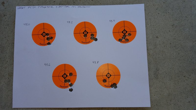

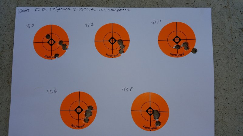

Ok so heres my update. Using Varget only I loaded 5 rounds of each charge weight starting with 42.0 and increasing .2gr up to and including 43.8gr. FC 2x fired brass with standard prep, CCI 200 primers and 175gr SMK, 2.85" COAL was used for all. 50 rounds total.
It looks like backing off to 42gr was great advice. I think between 42.2 and 42.8 maybe a sweet spot. The one shot just right of the bull at 42.4gr was me jerking the trigger. Above 43gr things opened up except for 43,.8 with 4 shots in a cloverleaf. The 1 shot left of bull hasgot to be a push althought I dont recall it at the time. Its the furthest round left of bull out of all 50 and with the other 4 at the same charge weight right of bull in a cloverleaf, I am skeptical.

Looking much better. I would now play around that 43.6-43.9 range in more detail. Do loads every .1. That is a super popular node range for tons of .308 loaders. Your 43.8 group didn't look bad, but your 43.7 might be even better :)
