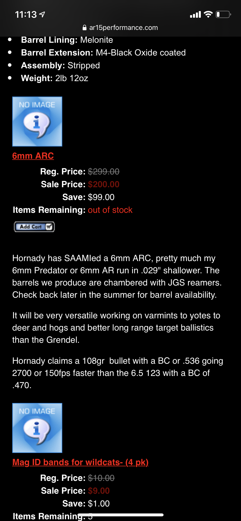

Taken off of AR15performance. I’ve been tempted a few times by a 6mmAR. Once this thing has good availability I’ll have to get one going.

At the moment Hornady will not admit they are going to do it. There are no gauges, dies, brass or ammo. I could have a batch of barrels in 60 days but I'm not going to produce barrels until all the other parts are out there.
