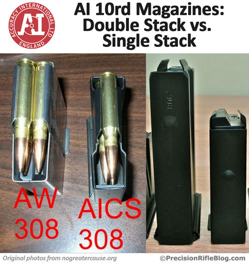

I have a personal requirement for 60° throw and flawless AW mag feeding, but that doesn't mean other actions are less than, just different.
Are you just using these mags? https://www.area419.com/product/aimags/
Did they require tuning?
I also run a terminus Zeus and while at first the bolt lift was a little heavy, after broken it it’s a pleasure! Super smooth, very very fast, the barrel change is awesome!
The quick barrel change is actually something I'm really interested in. I also like that the Zeus uses threaded trigger pins. I've been leaning towards the Zeus for a long while, but just recently started hearing about and reading up on the Fuzion and started second guessing myself.
Those are not it.
These are https://www.shortactionprecision.com/collections/mags-metal/products/aics-aw-10-round-magazine-308
All AW need a little filing on the mag catch of the bottom metal (best to alter the stocks mag catch to achieve the proper seating depth rather than the lip on the mag itself).

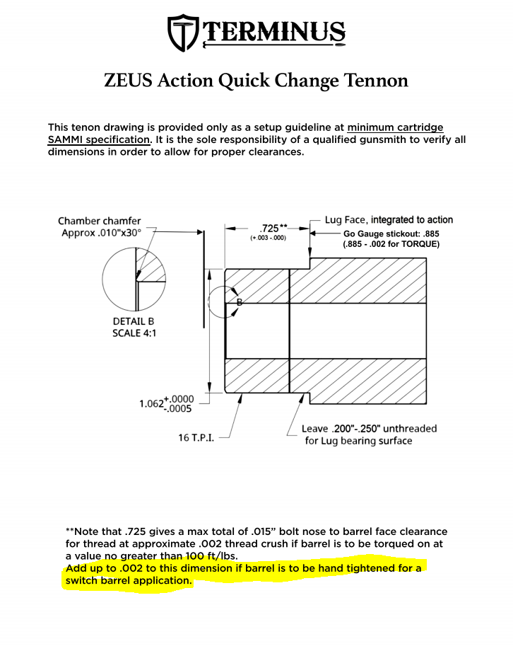

If you want to torque it on normally, you would buy a different headspaced barrel because the 70 ft/lbs of torque moves the barrel .002 closer.
No poi shift that I've detected. Headspace is consistent with hand tight torque. Literally just tighten by hand until the shoulder hits. The set screws are also hand tight.
I'll need to do more tests.
I’d imagine that torquing on a hand tight is probably not recommended then? Is the .002 the OAL of the round getting shorter or what’s getting less exactly?
It’s recommended when it’s cut for hand tight.
And yeah it would because the entire chamber moves back .002. It’s the barrel threads compressing a bit. You cant bend metal by hand, with a wrench and vice you can.
And yeah it would because the entire chamber moves back .002. It’s the barrel threads compressing a bit. You can bend metal by hand, with a wrench and vice you can.
I’m assuming you meant to say “not recommended when it’s cut for hand tight” right?
