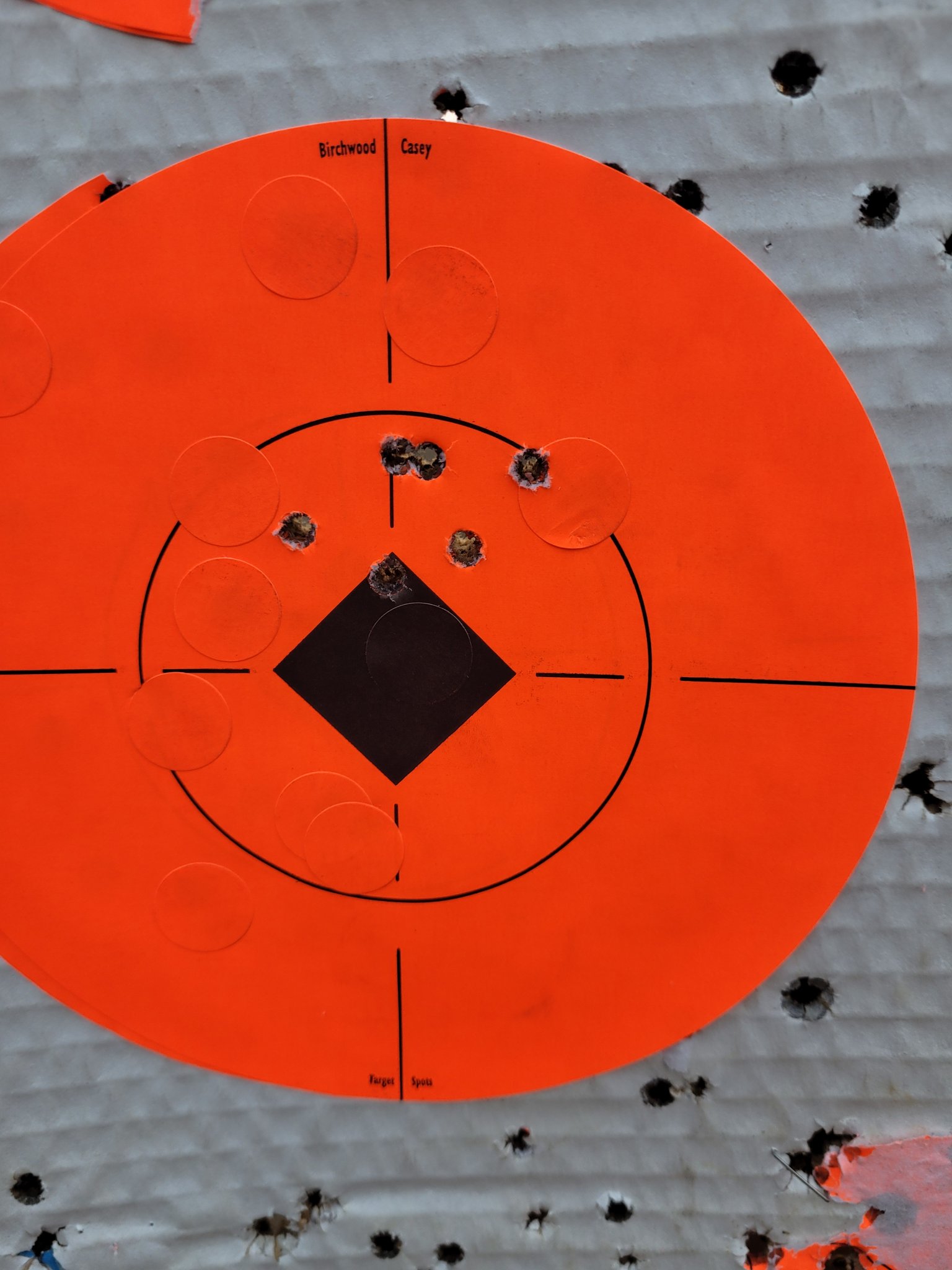

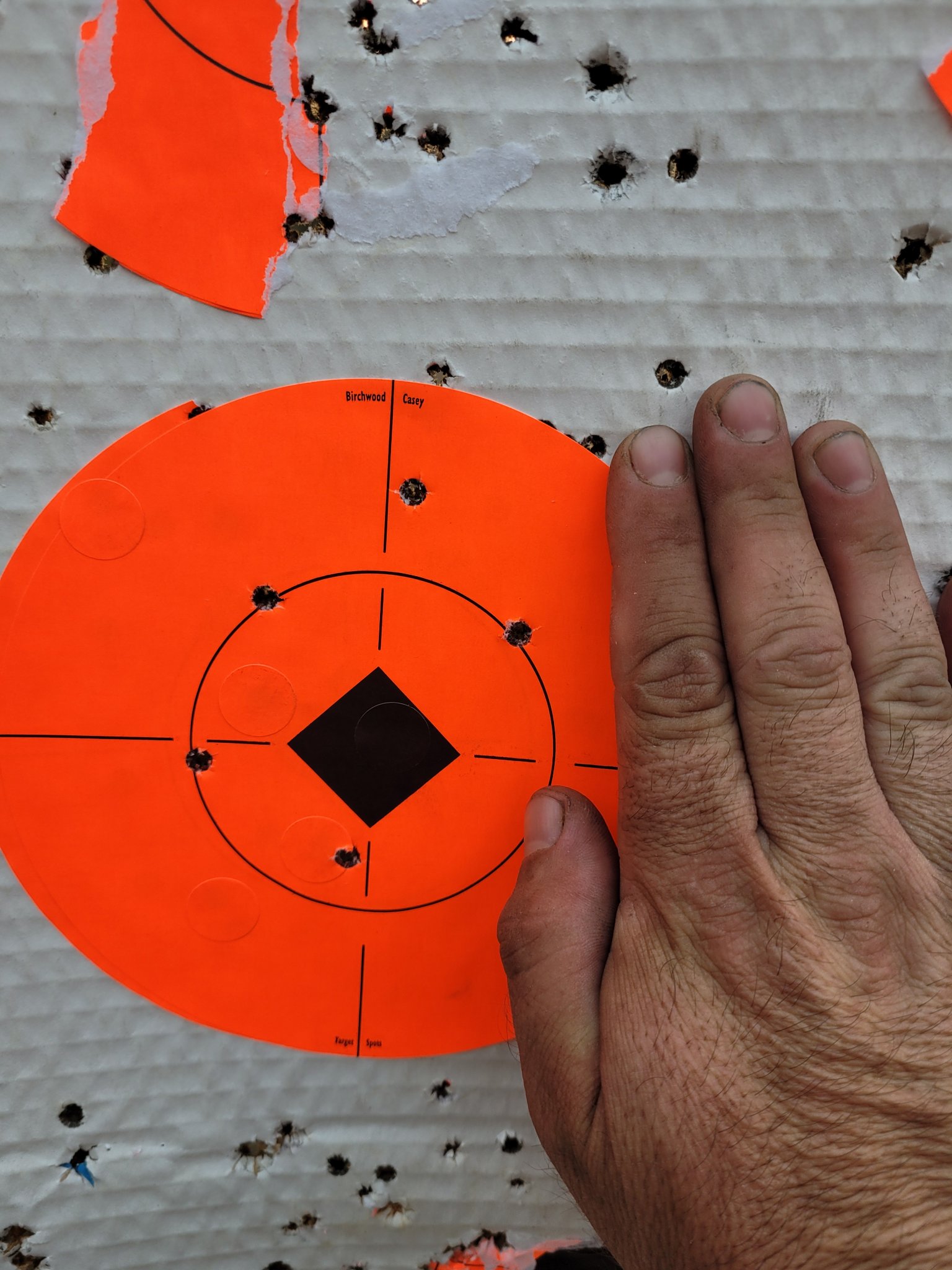

Hey guys. New to the forum and need some help. I just got a brand new springfield saint AR15 (16" barrel 1/8 twist). Took it out to zero and get some rounds through it but am getting horrible accuracy. Started off with 62 grn zeroing at 50 yards. Looks like a shot the target with a shotgun. Shooting from full rest and not pulling any shots. Ran some 55 grn with better accuracy but still over an inch. Back to 62 grn and getting like 6" groups. I've put roughly 200 rounds through it so far going between different ammunition. Used the same ammo in my old DPMS and getting great groups. I can post pictures of groups if needed. Any input appreciated.

I've run 3 different brands. Federal 55 grain, imi 62 grn, Winchester 55 grn all fmj and then some handload bthp 55 grn. I totally understand that what I'm shooting is not premium match grade ammunition and am not expecting moa/sub moa, however... when my cheap AR is printing consistent, good quarter sized groups (at 50 yrds) it makes me question why my springfield is making horrible groups. Both are 16" barrels. My DPMS is chrome lined 1/7 twist and my Springfield is a melonite barrel with 1/8 twist (55-62 should be in its sweet spot). 10-12 moa seems insane to me. In short I quess I was wandering if I needed to send it back or start looking into a different barrel? Free float? Just not super happy with a 1000 gun performing like this when my 200.00 .22 shoots better groups with cheap ammo.
