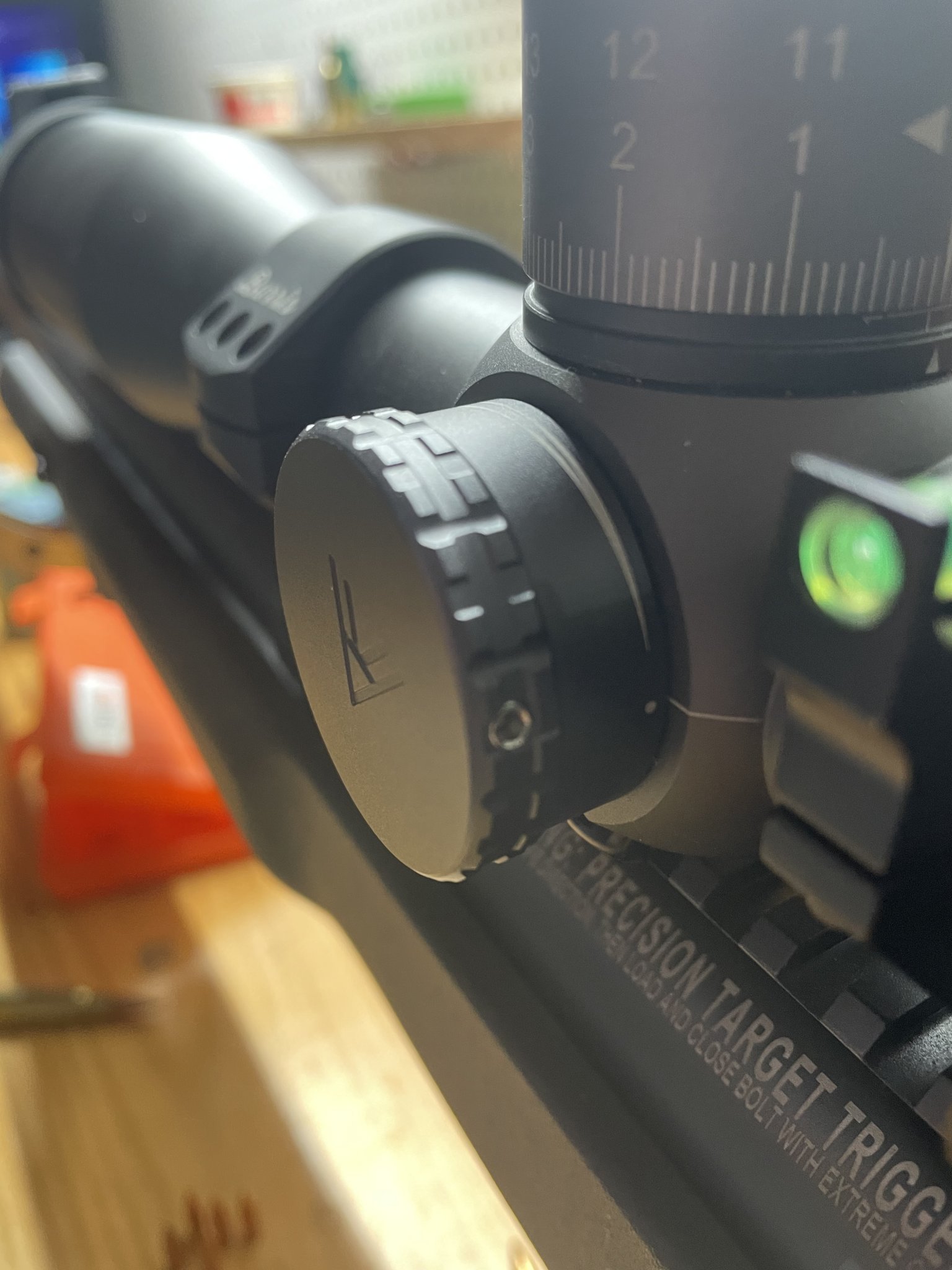

Has anyone loosened the set screws on the parallax to try and index it at the right spot? Or is the screws not on the ep5?
I’m sure it’s set up just like the directional turrets.

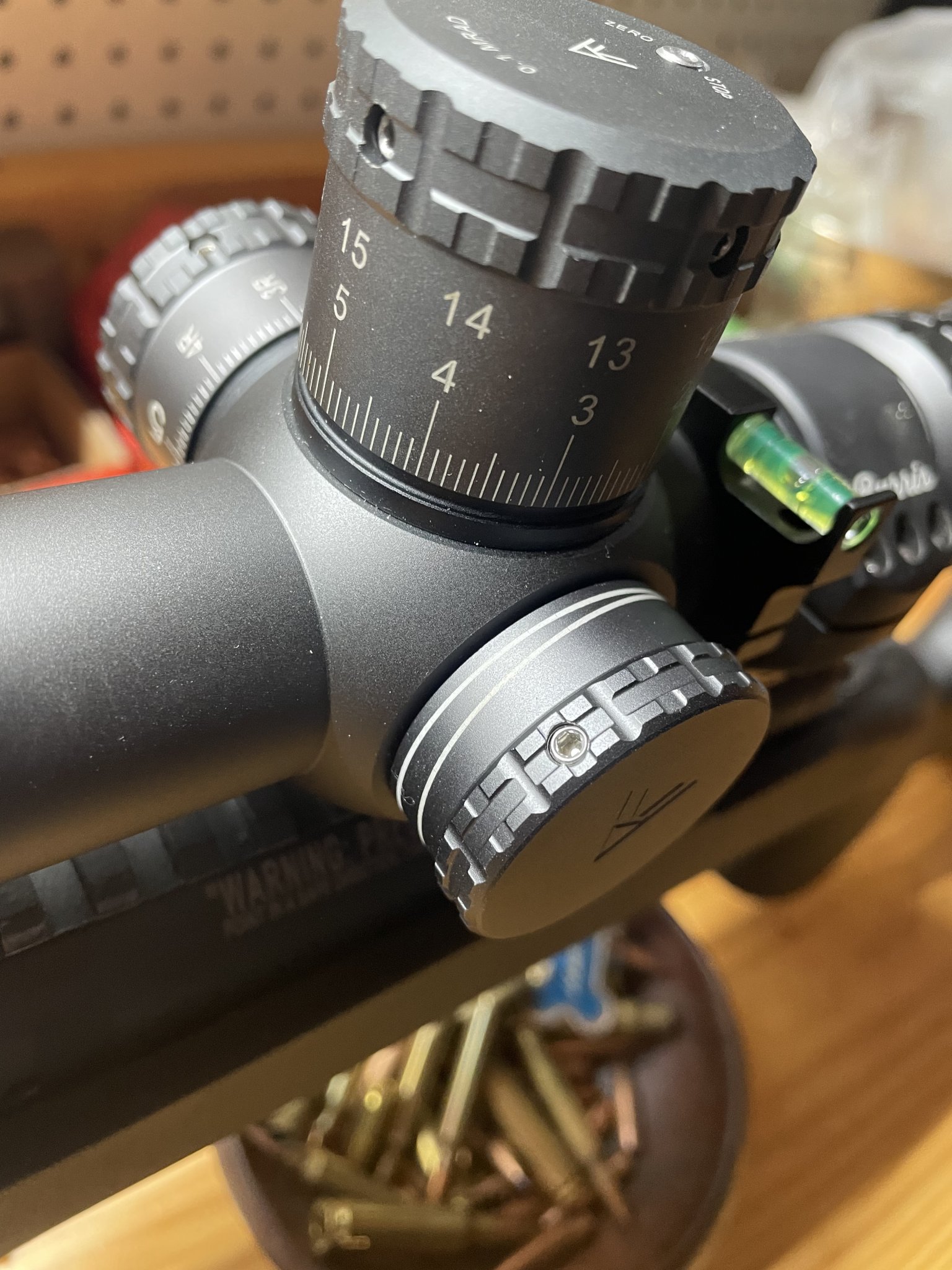

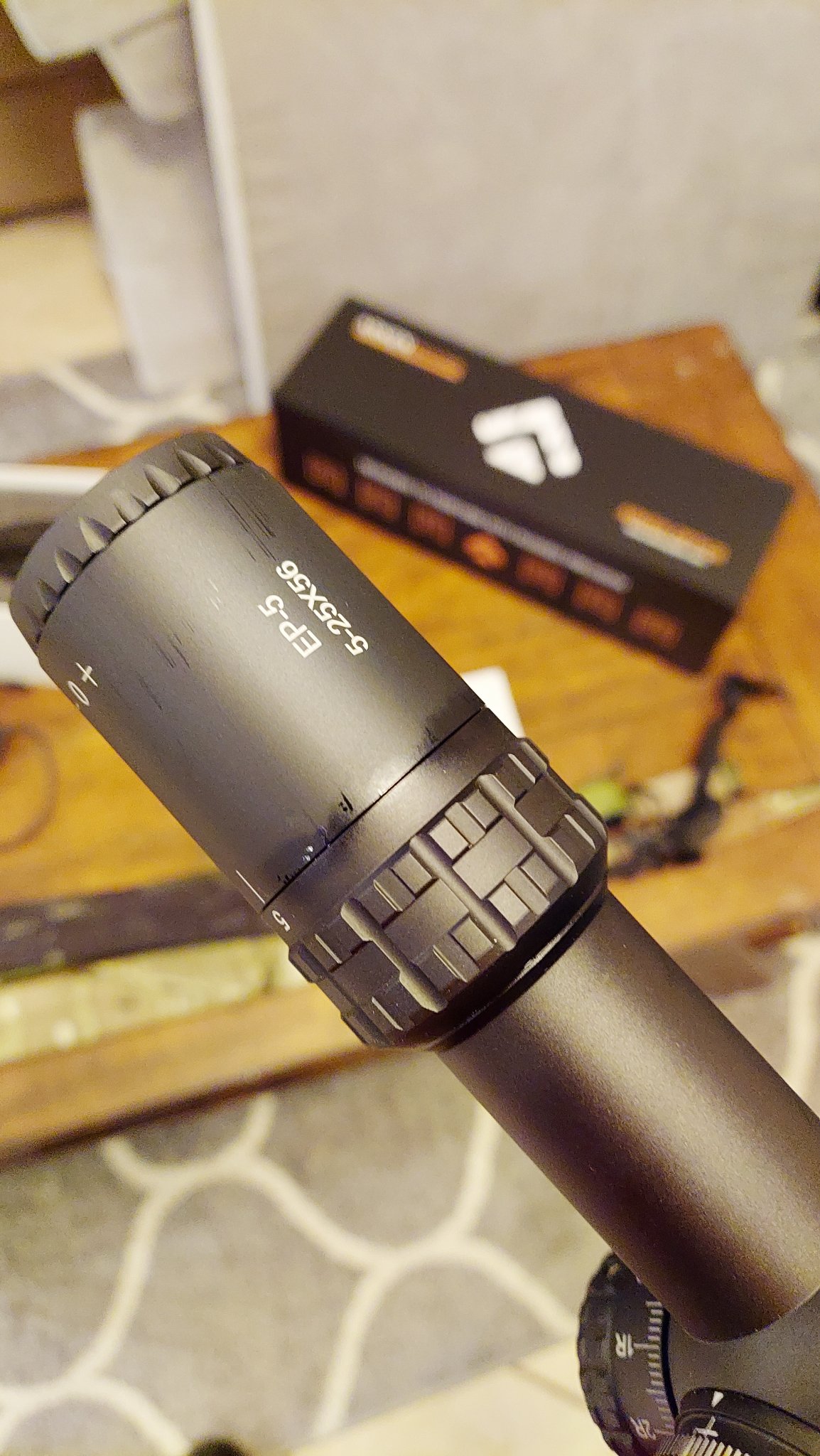

Adjusted my zero stop to actually stop at zero a moment ago. Used an 0.89mm hex wrench and just loosened the screws enough to turn it. Backed it up counter clockwise a tiny bit, put the turret back on loose, and then rotated the turret so that the zero stop pin rotated the zero stop to true zero. lifted the turret again, tightened the set screws on the zero stop, and then turret, and confirmed perfect alignment. I think the same could be done to set it how ever many clicks you want below zero as well.

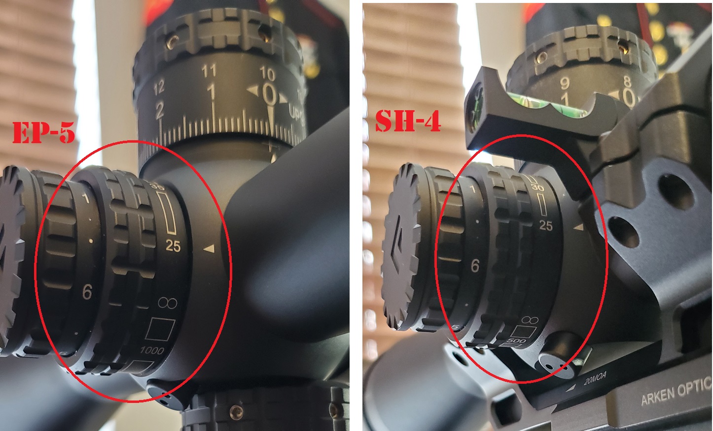

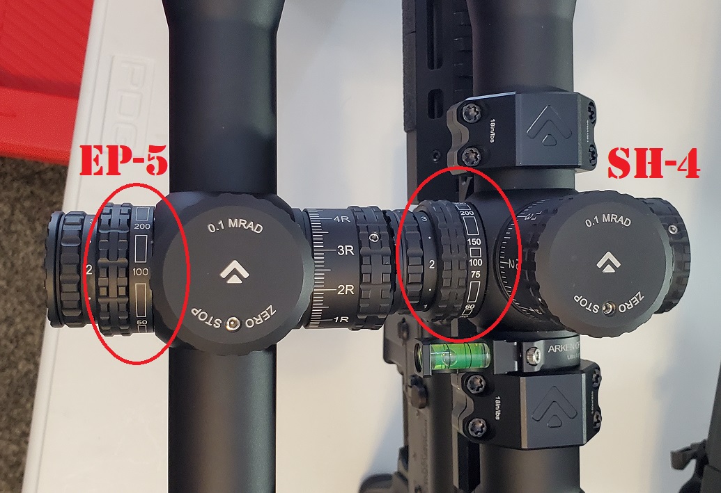

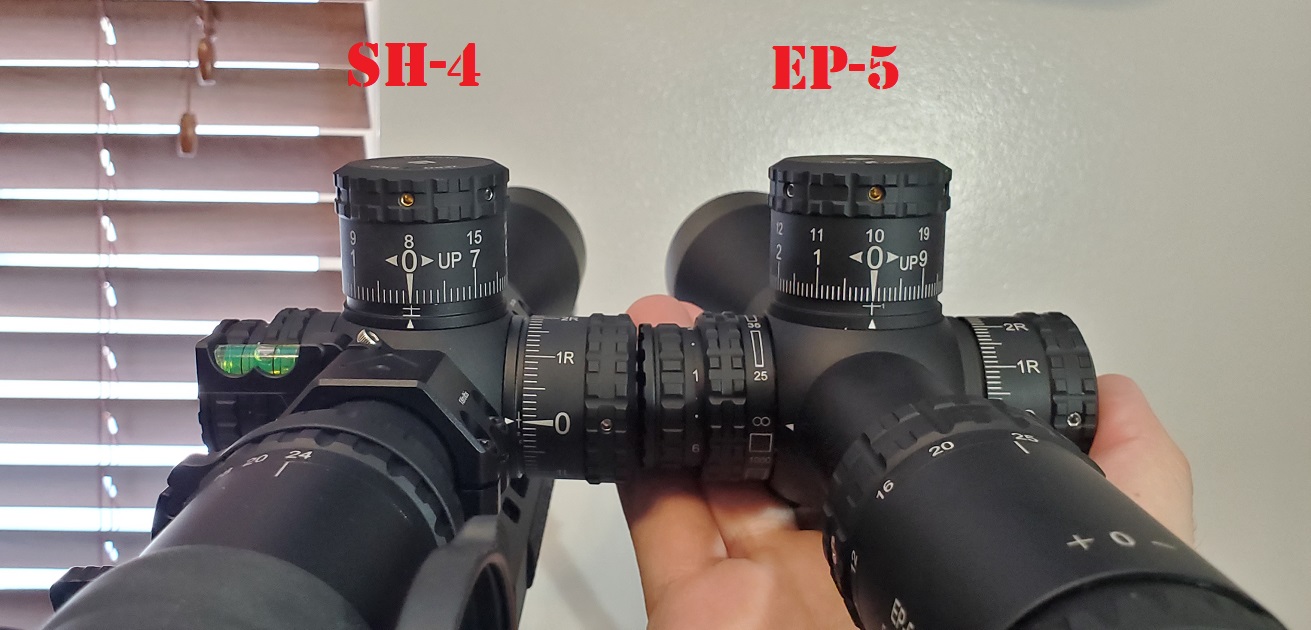

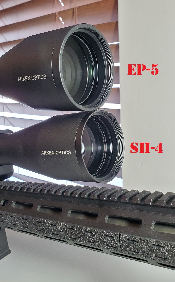

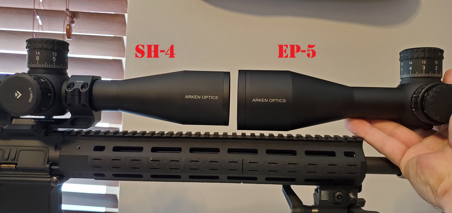

My initial comparison of the EP-5 vs SH-4.
Glass/image quality:
EP-5 has a slightly improved image that is slightly sharper with better definition and brighter. This is very subjective and was with my eyes, looking out my back yard across a field at various distances out to over 1000 yards. I tried to get good pictures with my phone, but did not like the way they came out, so once the battery charges in my camera, I'll attempt better pictures later. Hopefully some at dusk to see if the glass is really improved.
Eyebox:
I "think" the EP-5 might have a slightly better eyebox, but I need to get the scope mounted before making that call.
Illumination:
Slight improvement with EP-5, enough to notice at least. Still not "daylight bright". So, it should be a little more useful.
Weight/Robustness:
EP-5 feels like a tank, a very "robust" feeling and in my opinion "similar" to how a Razor feels, though I believe a Razor is still heavier. Weight on mine is 40.1 ounces w/battery installed. I feel like I could drive stakes in the ground with the damn thing :). Once I get an SH-4 removed from one of the rifles, I'll compare them in hand side by side. Looking at the objective ends of the scopes, the rim is drastically thicker on the EP-5. I don't know if the scope's body is thicker all the way throughout or not.
Turrets:
Huge improvement with the EP-5, like night and day better (and I really like the SH-4 turrets). The 10 mil per revolution is nice. The EP-5 clicks are more audible and tighter feeling, I'll say more tactile because everyone loves that word it seems. The only downside I could see on the EP-5 is with the detents have closer spacing, it will be easier to over-adjust when dialing. On a slow easy going range day, that should easily avoidable. In competition or something with a faster pace?
Diopter adjustment:
One of my biggest gripes about the SH-4, is how hard the diopter ring is to adjust, it's way too tight. The EP-5 does not have that issue and I would compare it how a Vortex diopter adjustment feels. Smooth, not too tight or loose.
Parallax Adjustment:
EP-5 parallax adjustment has a rotation of 330 deg versus 300 deg on the SH-4. It also goes to 1000 (vs 500) and then infinity. The EP-5 seems to be more spread out about 200.
Internal travel (elevation and windage):
EP-5 advertised elevation is 32 mil and windage is 16 mil.
Mine measured 34.2 mil and 18.1 mil.
I also checked my SH-4 scopes (genII 6-24x50).
SH-4 advertised elevation is 32 mil and windage is 10 mil.
A) 35.5 mil / 12.7 mil
B) 35.6 mil / 12.7 mil
C) 35.6 mil / 12.6 mil
D) 35.6 mil / 12.8 mil
E) 35.8 mil / 12.1 mil
I didn’t spend much time on it, but did try the recommended procedure to try and get 1 mil below zero and it went back to zero. I’m also not an engineer and haven’t looked into the internal mechanics. I just know it didn’t work the time I tried. 🍻

What caps are the cool kids using?
I run Butler Creek caps on everything else, but the new Arken EP5 caps are pretty nice on it. I didn't like the way they fit on the SH4 Gen2 scopes, they were kind of loose and would slide around...But on the EP5, they fit nice and tight, and don't move around at all. Seem to be built really well, too. I do like the fact the objective cap swings all the way back around against the scope to keep it out of the way, and to keep from getting broke...It's a nice feature.
Reactions: greentick
...doubt I qualify as a "cool kid", but I use the "Flip-Its" that came with the basically 'free' Combo Kit. I like the way they attach, that longer and flexible "sleeve" works, much easier to put on than I encountered with Butler Creek caps on other scopes. Just roll/fold the flexible sleeve back on itself, set against scope, unfurl onto scope and adjust as necessary. I have read of folks having issues about them not "snapping" back flat when activated, mine DID NOT have that issue, they always snap flat against the scope body.
Tyler at MKM can make some equivocal to Aadland. They’re about $70 a set. Not the cheapest but great quality a supports small business. He has parallax wheels and mag throw levers also.
1.728” is ocular size and 2.560” is the 56mm bell for EP5 and 2.323” for 50mm bells (EP4, SH4)
1.698” is the ocular for EP4 4-16 fyi.
Edit 2/16/22:
Correction: The 2.560” does NOT fit the 56mm bell. Tyler at MKM doesn’t currently offer a size to fit but I’ve requested he add 2.610” to the menu I linked below. If you ordered I suggest emailing them and requesting the larger size. The 2.638” is the next size currently offered and would be too large. 🍻

Excellent review. I'm curious to hear your thoughts in adverse conditions. Mine came in a week or so ago, but I haven't had time to shoot through it, or take it outside and look through it. Work has been kind of hectic lately with my project coming to an end, and all the bureaucratic DOT bullshit that goes along with closing it out. Then we got one guy on "vacation" (dealing with some family issues), and another one got covid, so I had to go fill in for him all week, and tomorrow. And I'll be gone all weekend again this weekend. Maybe I'll get to go to the range on Monday.
I received a EP5 from the first shipment but never got a chance to open and play with it due to work (I travel ALOT). When I did get a chance a week ago it had pretty significant "scope sweat" that you'll sometimes see in a very minor way from drastic elevation&temperature changes (from the coast of California up to Lake Tahoe for example).
This was not minor though. It was wet all around the magnification ring, with some pooling liquid at various spots. I emailed Arken about it and they never responded.
Here's a picture I took of it right when I opened the box. The reason the moisture is streaking down the eyepiece is they use a foam noodle to cover it to protect it during shipping, the noodle absorbed a bunch of the moisture and drug it down the eyepiece when I was sliding it off.
I would put it in the freezer and give it the freezer test to see if the seals are broken but I don't want Arken to say I broke it or caused it to get worse (if they get around to replying to me).
But hey the turrets are nice and clicky though.

Let’s face it, they’re not good with addressing moisture. I was hoping they got that fixed.
Now someone needs to dunk the ep5.
If it leaks, I’m selling my sh4 and ep4, I’ll pick up another strike eagle and venom or maybe a couple Athlon helos gen 2s.
